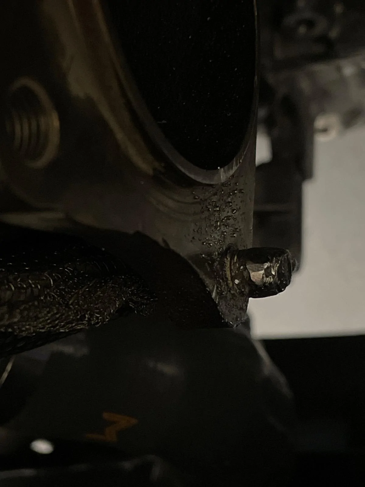

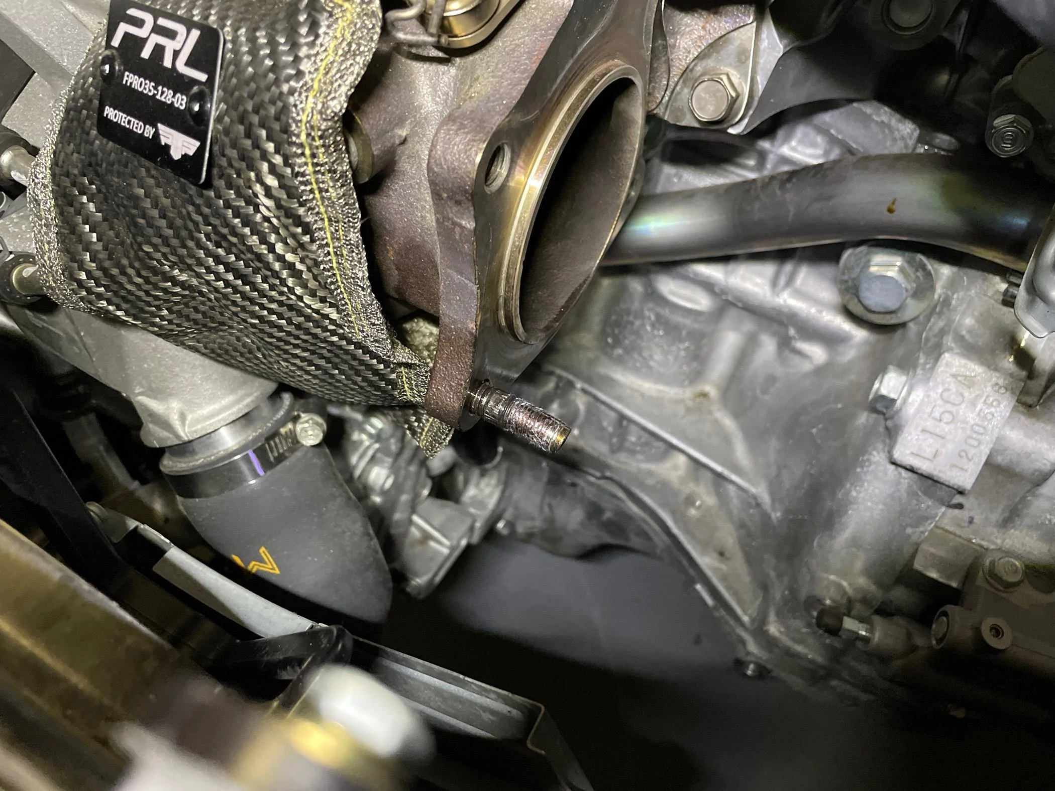

So i am currently installing a downpipe and frontpipe and the stud is stuck in the turbo and everything ive tried seems to not work hardware stores around me are close atm so i cant try the two nut method ive sprayed wd-40 on it and let it sit nothing has seemed to work
Anything helps thanks!

Just noticed aswell there are no threads on the exposed side anymore from my unsuccessful attempts at removal 😅

Best way would have been to double nut with the factory nuts and heat it up with a torch.

Wish i had tried that before other suggestions i got lmao

I had someone come out to weld a nut on it and it broke 3 times 🫠
