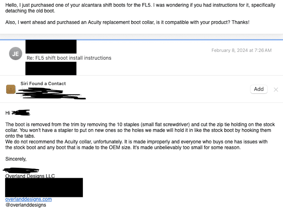

I purchased the red and black OEM type R knob, an Overland Designs red shift boot, and an Acuity shift boot collar.
Unfortunately, I read on this forum and from Overland Designs that the Acuity collar is too small, and they recommended I stick to the original collar.
I want to stick with the OEM red and black Type R knob and the Overland red shift boot, but would love to swap out the collar because I marred mine trying to remove the original knob. Any advice on a more compatible collar?

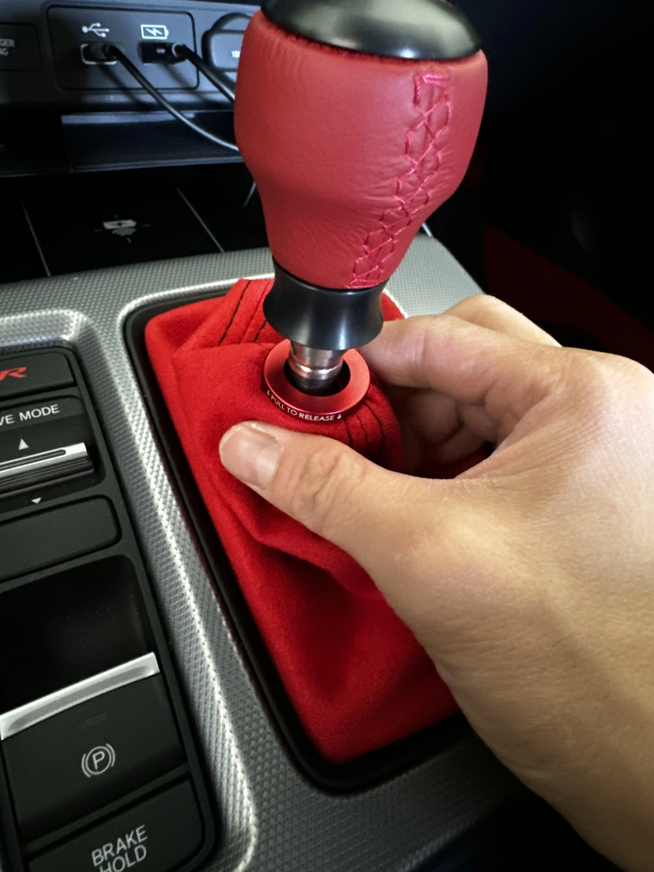

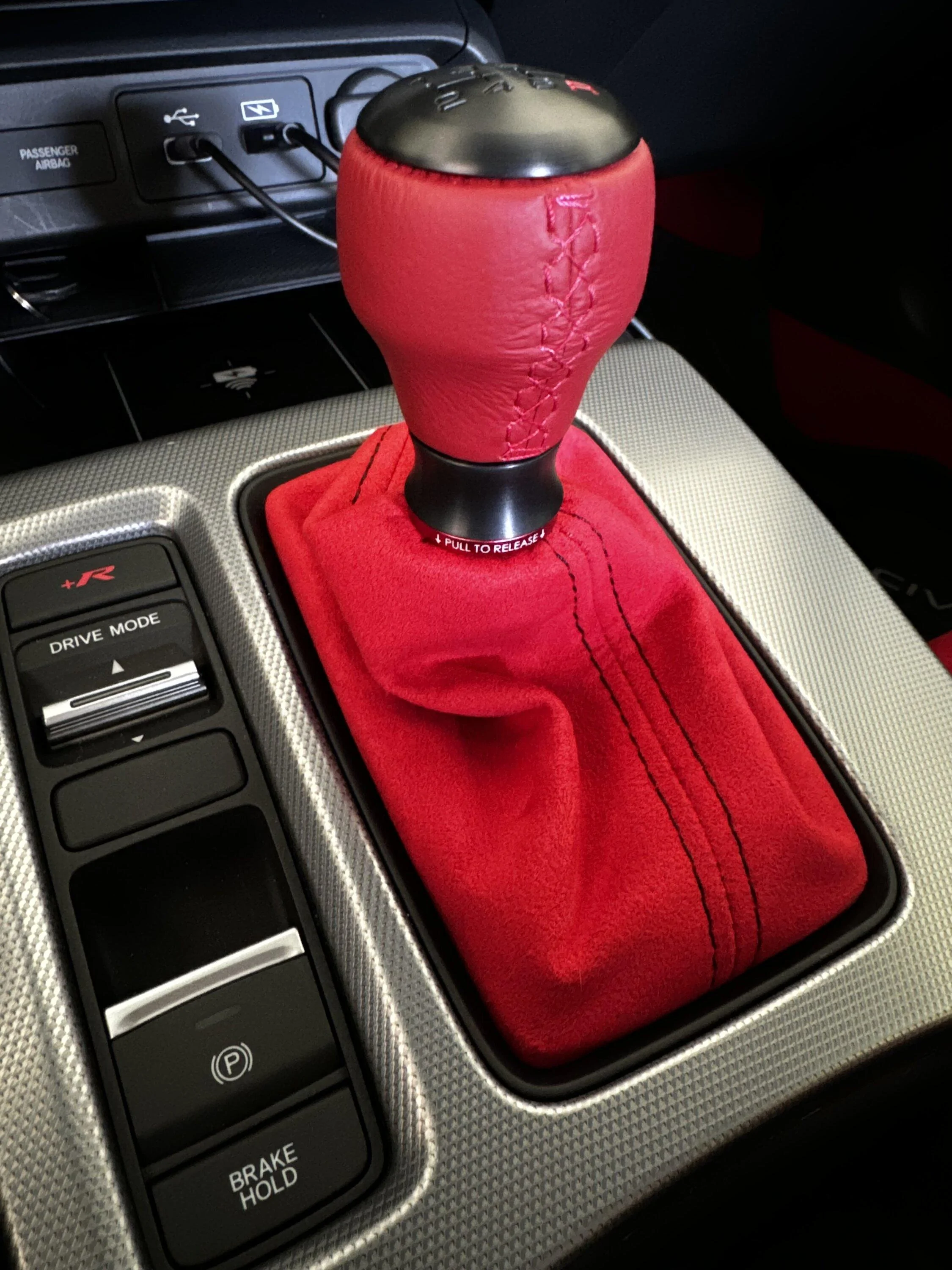

Ok I figured it out: use two zip ties to attach the Acuity collar to the Overland Designs shift boot. Love the final result, and now I have easy access to the nut for easy swapping of the shift knob.
