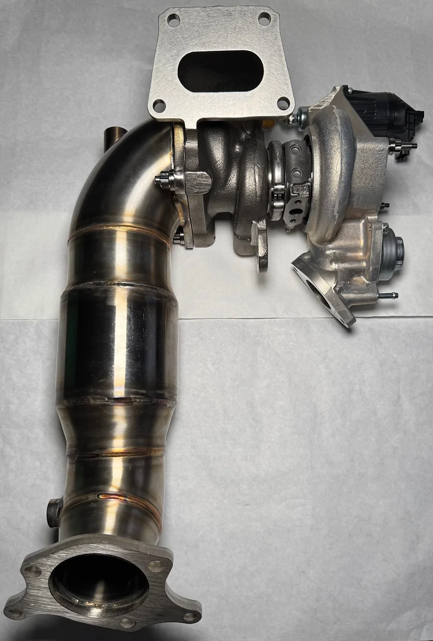

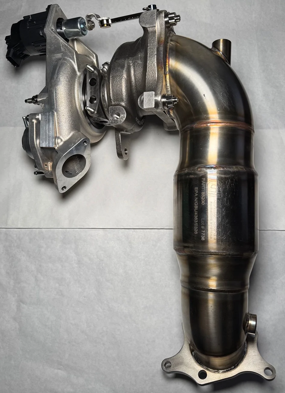

Updated the above table as the OEM Downpipe Inlet ID is actually choked down to 70 mm/2.756 in. after a 90 degree bend before the cat. When comparing the OEM Downpipe (Raw) to the SBX Downpipe (Raw - No Logo or Studs for OEM Heat Shields), the SBX Downpipe offers a :
  • 31.587% Reduction in Weight (-1,586 grams/-3.496 lbs.);
  • 42.857% Increase for the Inlet ID (+30 mm/+1.181 in.); essentially port matched to the OEM Turbine Outlet ID; and
  • 37.736% Increase for the Outlet ID (+20 mm/+0.787 in.).
My CTR has almost 40k on the odometer so I'd rather install newly acquired parts on a brand new CTR.
Link for reference for those thinking about upgrading their intercooler charge pipes at the same time. Here is another link for those looking into intercooler options. Intercooler and downpipe upgrades should be at the top of the list IMHO.
