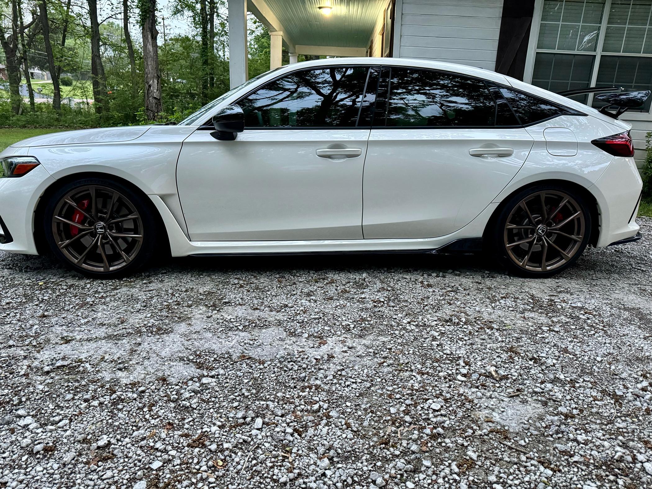

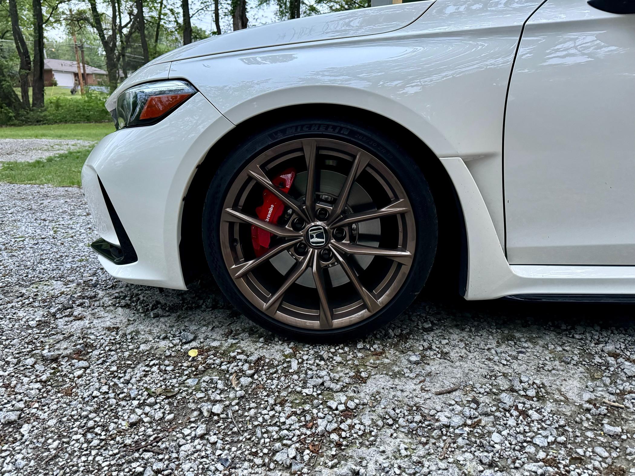

I got my pro kit springs installed yesterday.
when we aligned it we got-2.0 of rear camber.
weird thing is the Hunter alignment machine said it was within spec/green.
however my buddy who helped with the install/alignment said this was bad and will eat up my rear tires.
Anyone have experience with this using Eibach pro kit?
if I need a rear camber kit which one is recommended?

You may see a little bit of accelerated wear. As long as your rear toe is in spec, it will be minimal. I routinely run my street cars around -2 degrees of camber. With 0 toe front and just a bit of rear toe in and don't see camber wear.

We got the toe pretty close to 0, I can’t remember what the front camber was. It was better than the front, and the guy that did it didn’t seem to thank it would be an issue.
sorry To be so vague, when we were done the only thing I remember was the-2.0 degrees camber in the rear, as he was worried about it. Didn’t remember the rest because he did it was good.

agree. -2 in rear will be fine as long as toe is 0. Also I am surprised they didn't give you an alignment sheet but regardless its most likely fine

I have ran Spoon springs and now Eibach Pro-Kit. Both gave me -2.0 in the rear, which is fine. The allowance is the rear for the FL5 is -2.3. That’s why it showed in the green. My fronts are also -2.0, as I have the front pins pulled.
Toe is the most important part with camber around -2.0. Don’t forget to rotate, which will help.

Thanks for the help everyone. Sounds like I’ll be ok as long as my toe is ok, which it was.
