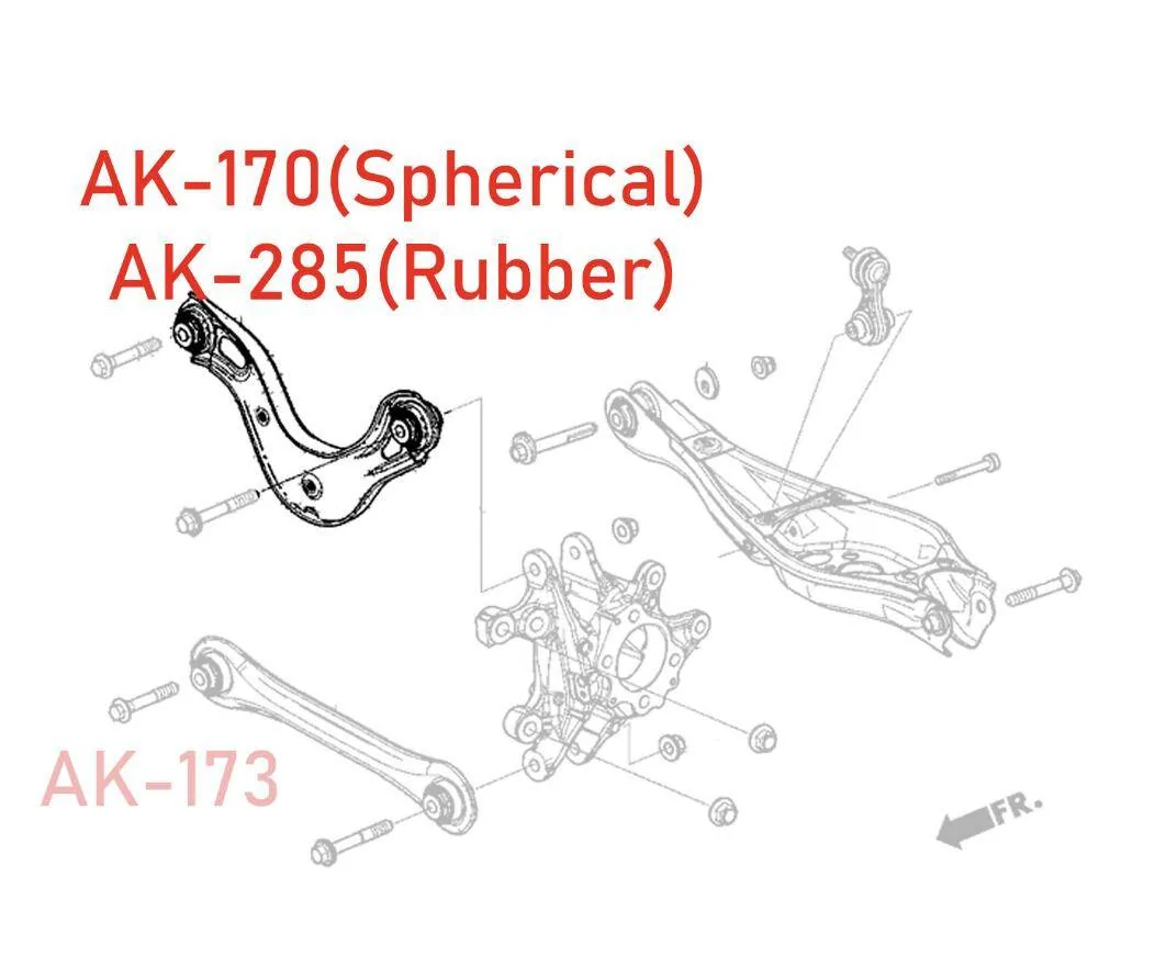

This is a completely different component than the SPC, this one is the lower A arm, it is located right below the arm that SPC replaces. See this pics below, the spc is the AK-170 or AK-285 parts and the RV6 is the AK-173. It is all below the subframe and knucle, with full access to all the bolts, very easy to swap, and does the same thing (adjust camber).

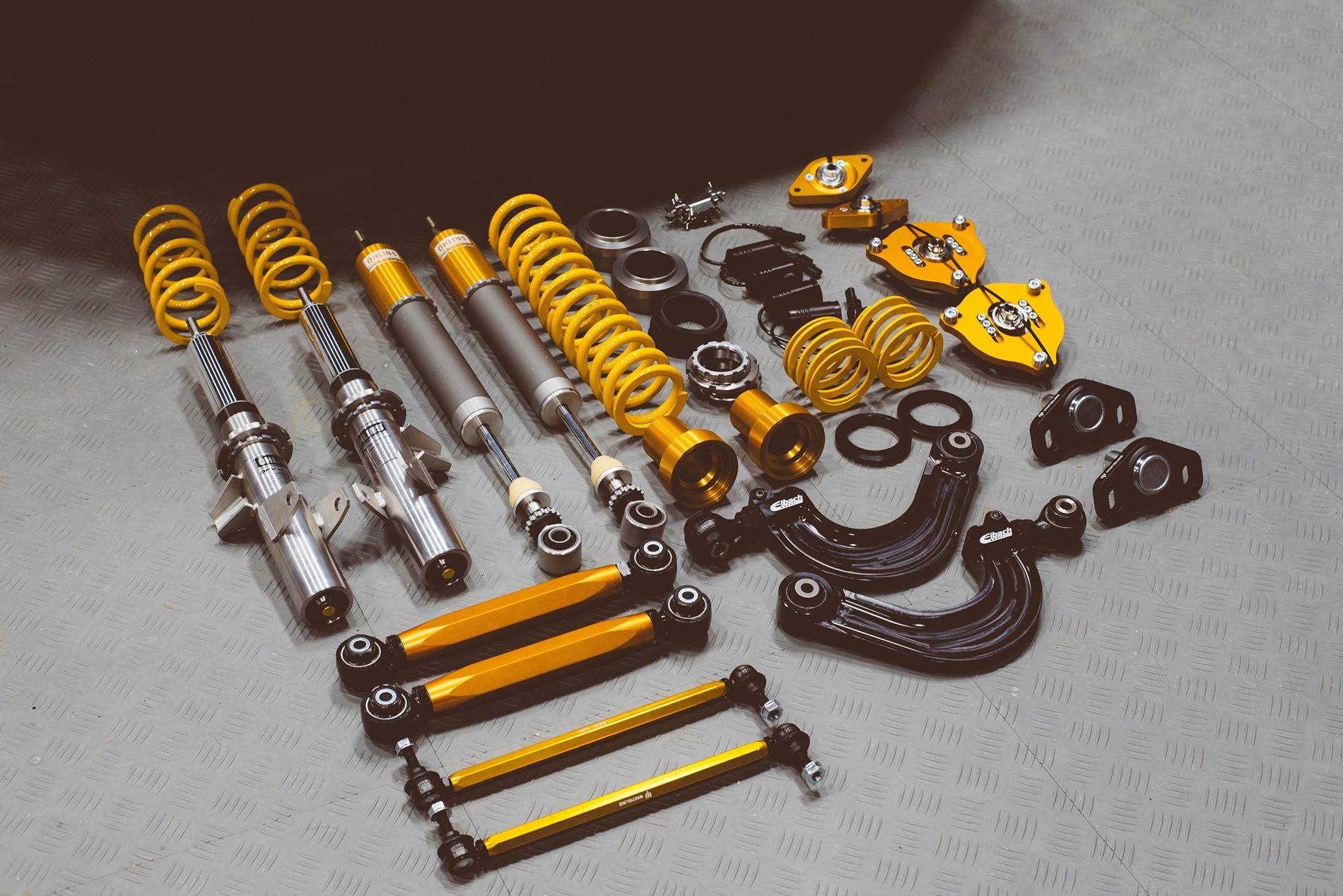

The upper SPC/Eibach arm is for camber, and the lower arm (not control arm bucket - the one to the left of the eibach arms in this pic) is for toe. But in reality, everything is connected - you adjust camber or toe and one follows suit. Although yes technically you can adjust camber here too, but again, will affect toe values, so its mainly for toe depending on how much you need/want to adjust.
11th Gen Honda Civic SPC part# 67476 Rear Camber Passanger side install issue 2025-05-17_04-56-47
