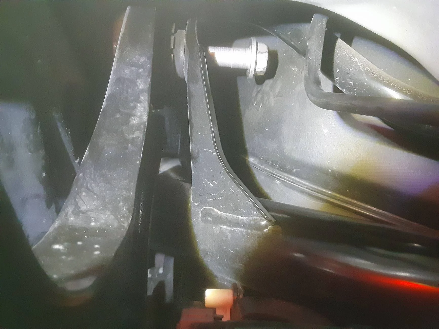

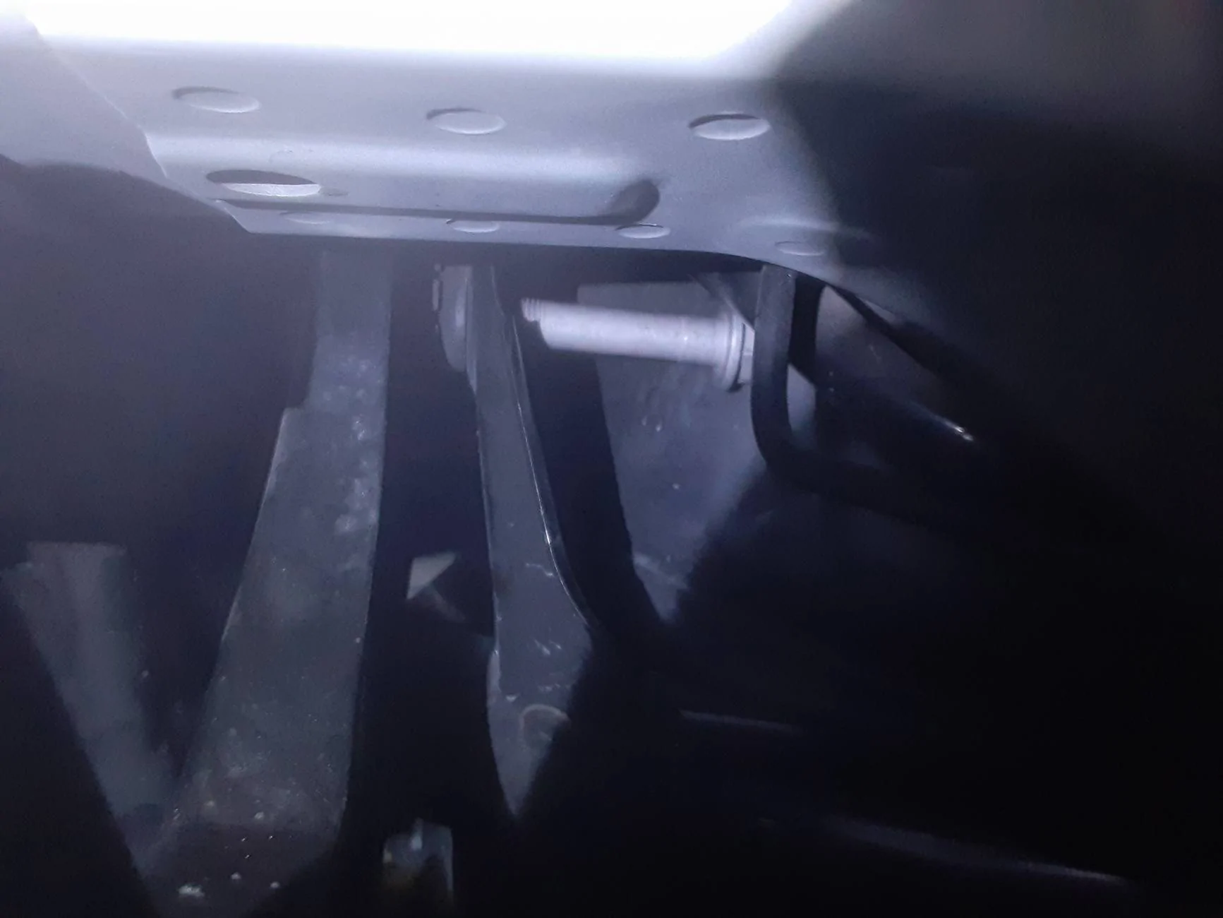

nttran98 Senior Member First Name Nhan Joined Apr 29, 2022 Threads 3 Messages 223 Reaction score 112 Location US Vehicle(s) 2026 FL5 Apr 21, 2025 #16 Damn, Any update to this, about to do this to my FL1. Anyway to know for sure whether its gonna be enough room? Sponsored

Cueyo Senior Member Joined Nov 3, 2023 Threads 22 Messages 1,072 Reaction score 854 Location USA Vehicle(s) 2025 Civic Type R Apr 21, 2025 #17 nttran98 said: Damn, Any update to this, about to do this to my FL1. Anyway to know for sure whether its gonna be enough room? Click to expand... Nah, I gave up. I think the subframe removal or just trying to loosen bolts around it is your best bet.

Snmtazz70 Senior Member First Name Matt Joined Oct 12, 2019 Threads 4 Messages 131 Reaction score 37 Location Miami Vehicle(s) Type R Jan 10, 2026 #19 Doing the camber arms i got the bolt out with a very long rachet wrench. Got a shorter grade 5 to go in and worked.
