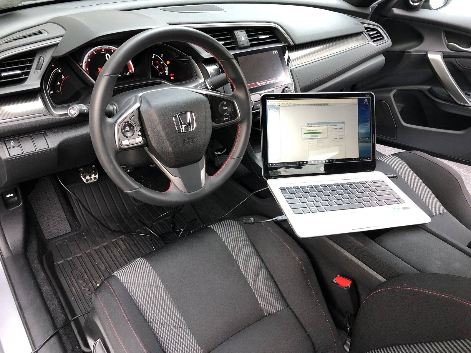

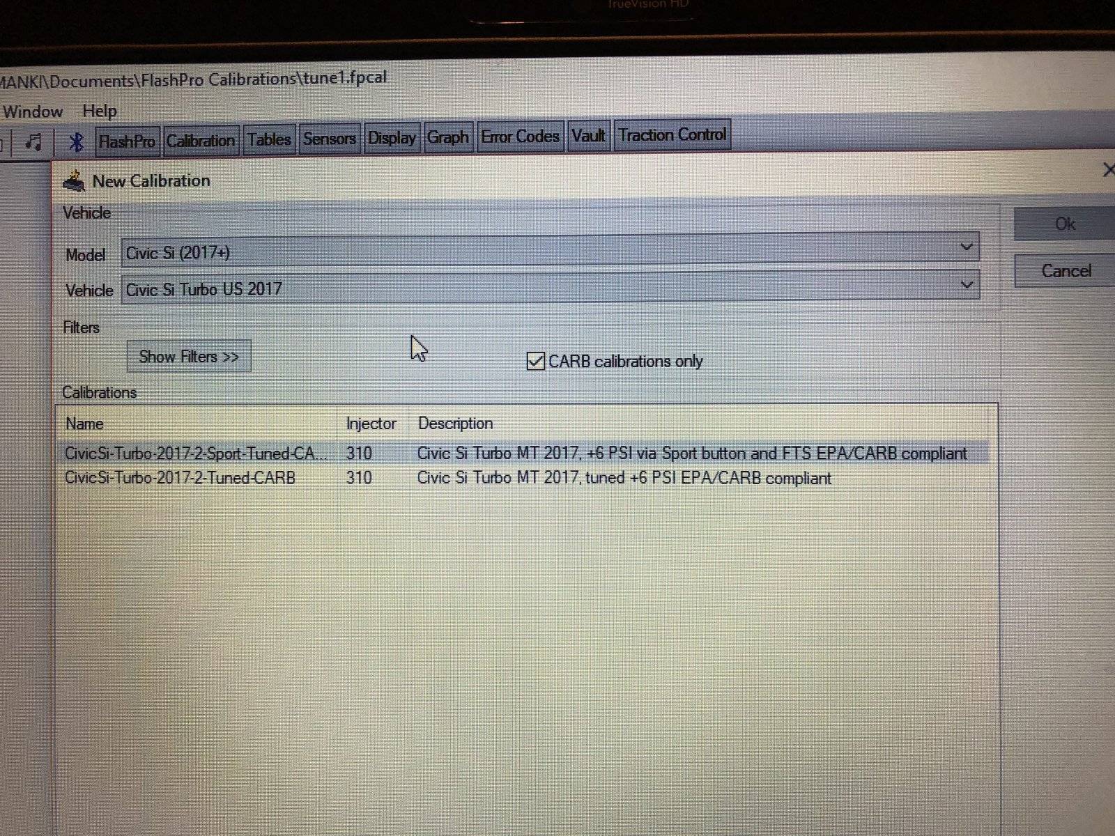

Proud new owner of a Hondata CARB for an Si. Set everything up and flashed it tonight with +6 basemap.
Was looking around on the software and can’t find the base +9. Am I missing something? Please help.

Open up a 2nd FlashPro manager software. Load up the non carb +9 calibration then copy the boost table to your carb calibration.
edit:
I did the above for you and saved it if you don't know how to copy and paste
