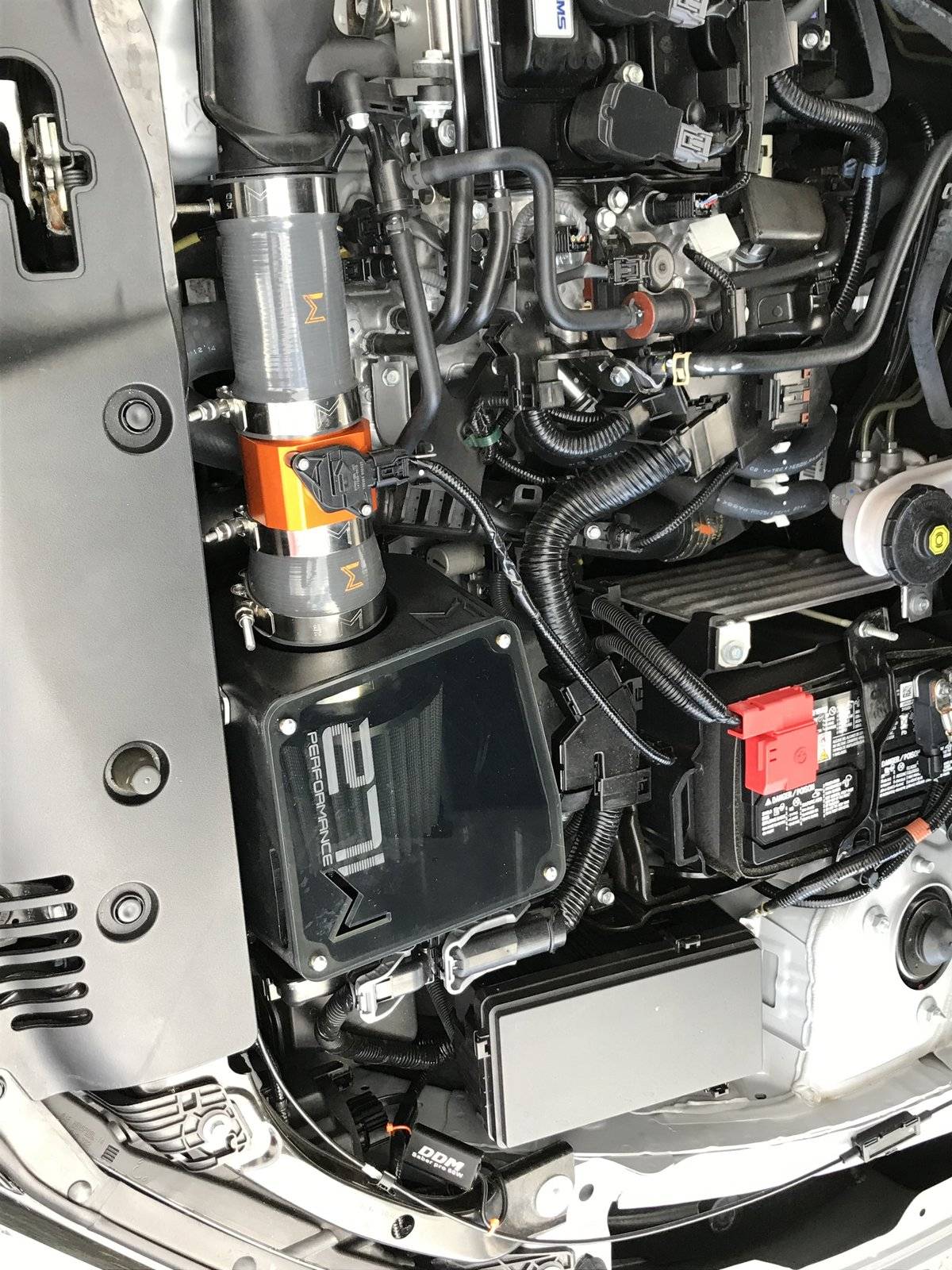

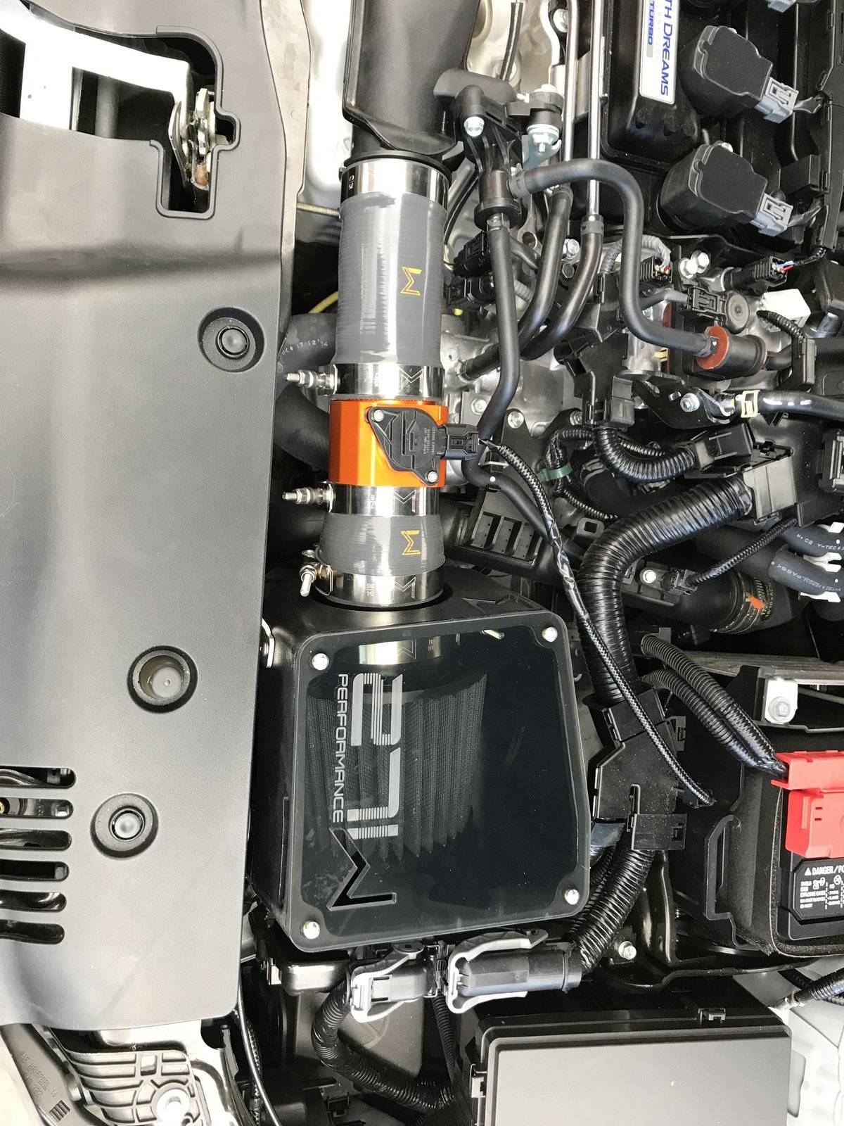

View attachment 130280 I just installed my 27won cai today. It took about 2 hours. The intake installation itself was simple. I cranked the filter a little tighter, feels good now but I’ll check often on it. Bolts up top to the lid are nice and snug. The t clamp closets to the turbo inlet was pretty difficult because of tight space. Just took lil longer than the others because 1/4 turn every time. The hardest part of entire install was removing all the clips and metric bolts from under the car to remove the shield. I took my time and made it all nice. No cel lights. It sounds 100x better. You can really hear the cold air getting sucked in and the release from the turbo sounds beautiful. Very happy with this product. Good job 27won. Look forward to installing my rmm when it arrives and hopefully your exhaust soon
