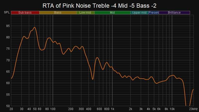

here is an rta of the Hatchback after I had done some adjustments.
Vol. was set at 20 and pink noise was sent over bluetooth with my v30 using audio tool. Bose center point or whatever its called is turned off
Treble adjustment seems to be about 6k and up
mid seems to be about 500 to about 1k
bass seems to be about 300 down
system has an excess of mid bass that cant be tuned without losing too much low end. It also has a dip from 1,500 to 6k that cant be fixed
I had measured it with the factory settings but it got deleted on accident.
11th Gen Honda Civic Bose Audio Sound System - Measurement Results Honda Sport Touring Hatch
So, is this good or bad? I have no idea how to read this graph.

I really don't know what all that means, but my personal opinion is the Bose system is good, but not really as good as I would have expected. I got it to sound better by making adjustments to fit my taste, with reduced mids and moving the sound a bit further back in the cabin. I am glad to have the Bose system at no extra cost, and it is pretty cool for a factory supplied system, but if I had to pay for it I would have declined. With as many speakers as it has I expected more from it.

I tried OP’s setting in my SI and I really like it, it seems to tame/smoothen the unevenness in vocals and trebles. I turned the bass to -3 instead because I think my sedan might have boomier/looser bass due to the free air sub(need to verify). I also found that i preferred centerpoint to be on in the back seat vs the front, it gives a better imaging for the rear passengers. Overall, I really enjoy the system after the adjustments, maybe I will add some sound deadening to the trunk/deck later to try to tighten the bass up. Kudos to squish72 for doing the RTA!
That's good to hear you think it helped. It's far from perfect, wished there were more bands of adjustment. For what it is though it's pretty good and one of the best stock systems I've heard. I would love to tie in some bass shakers under the seat to help with the sub bass and would also be able to turn the bass down a bit, but I don't think there's room anywhere to do it.

I have mine set to maximum treble, I have the mids set way down like -3, and base set at +3. I have the fader set to just a small bit behind center, and balance set even. It sounded much better after I made these changes.

Looking at that graph it seems like you turned the treble and mids the wrong way. Turning them both up would give much flatter response.
