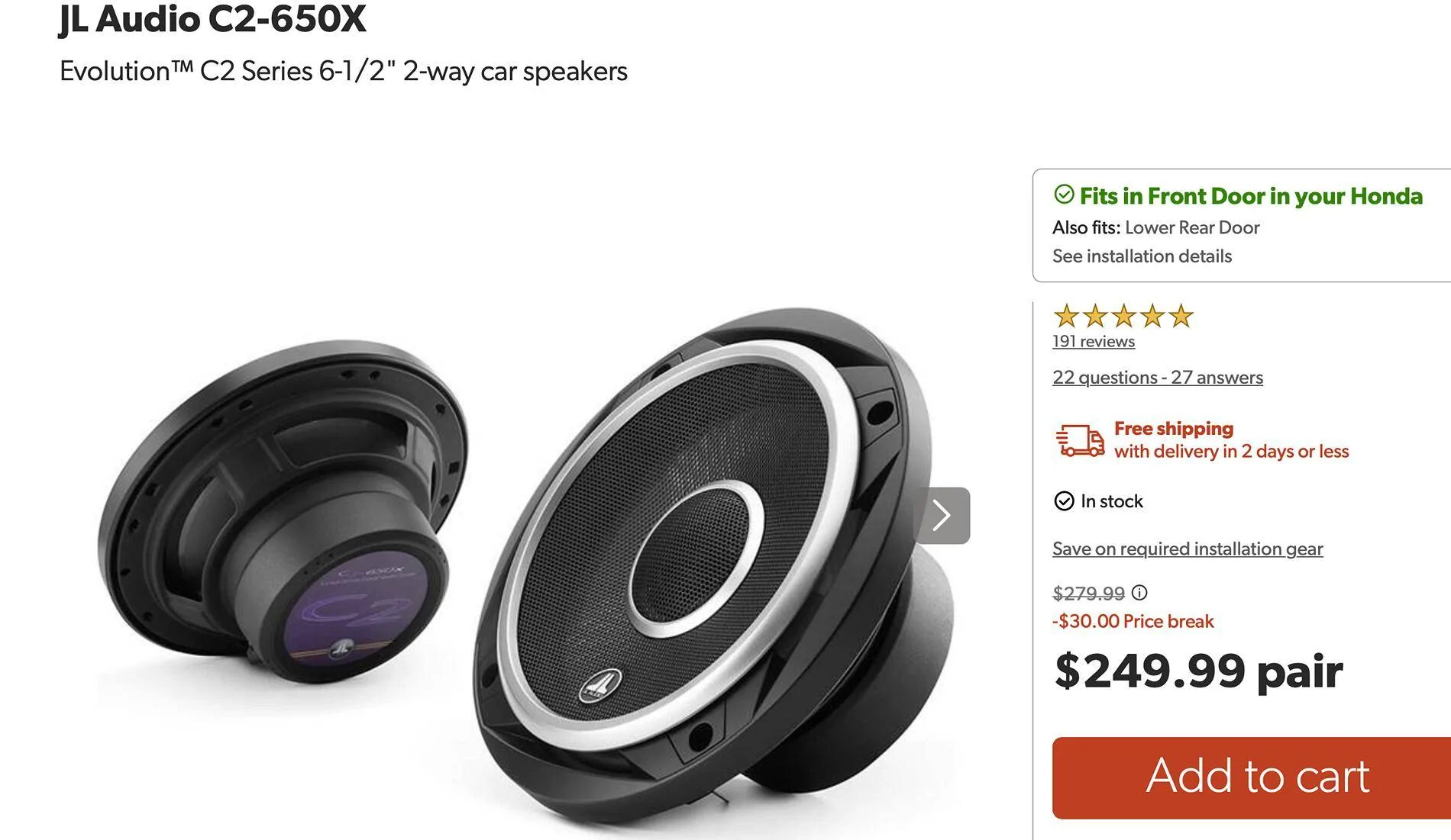

I've just received some speakers from Crutchfield.
JL Audio C2-650X Evolution.
I'm waiting for the installation kit, which should arrive tomorrow.
I expect to install them in 2 weeks.

I installed the two speakers mentioned above. I did some sound tests. The sound quality is now very acceptable. It's not wow! But compared to the sound of the original speakers, there's no longer that nasal sound. I'm satisfied, it was worth the expense. C$344 with tools and accessories to fit in the door
