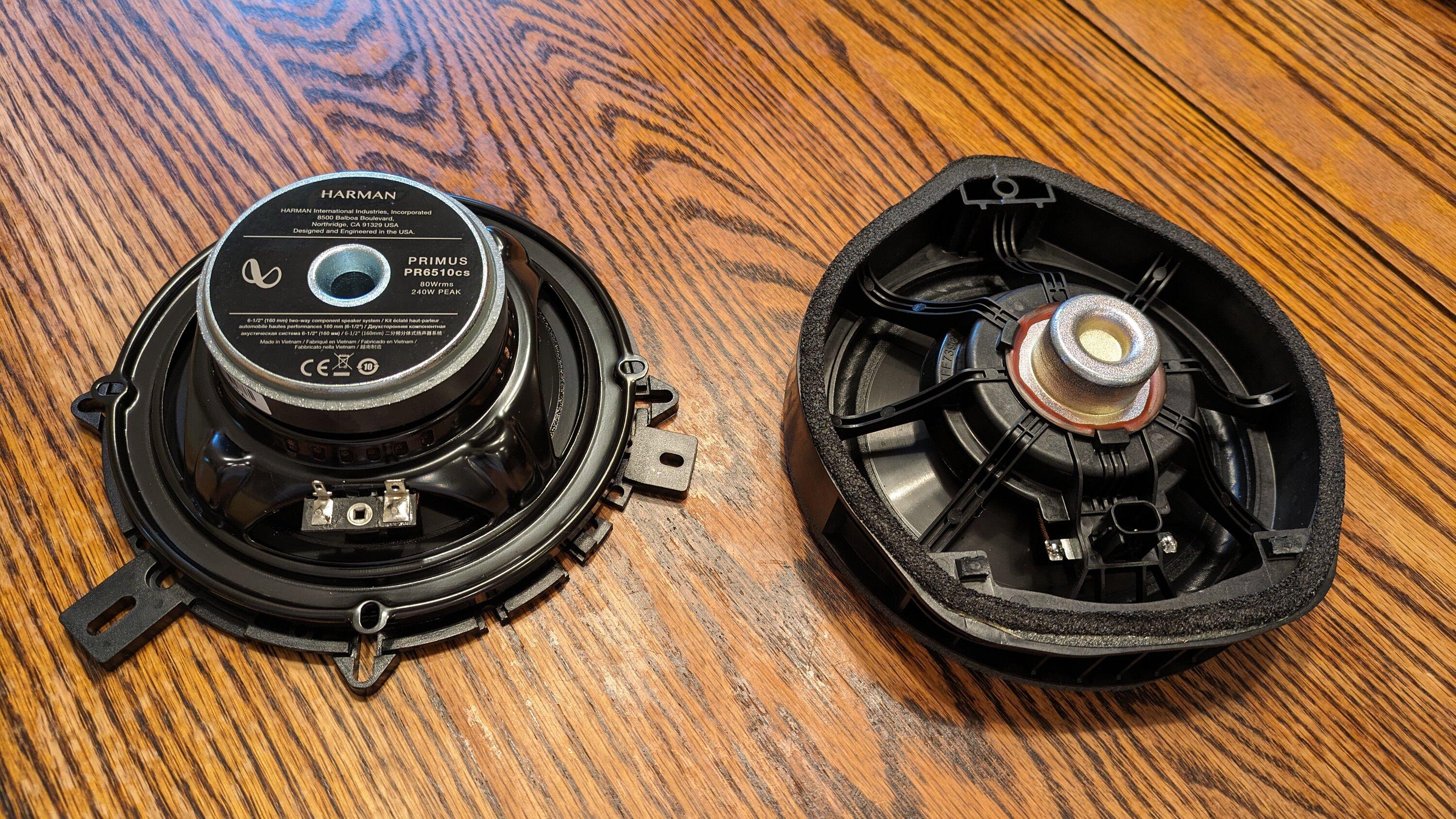

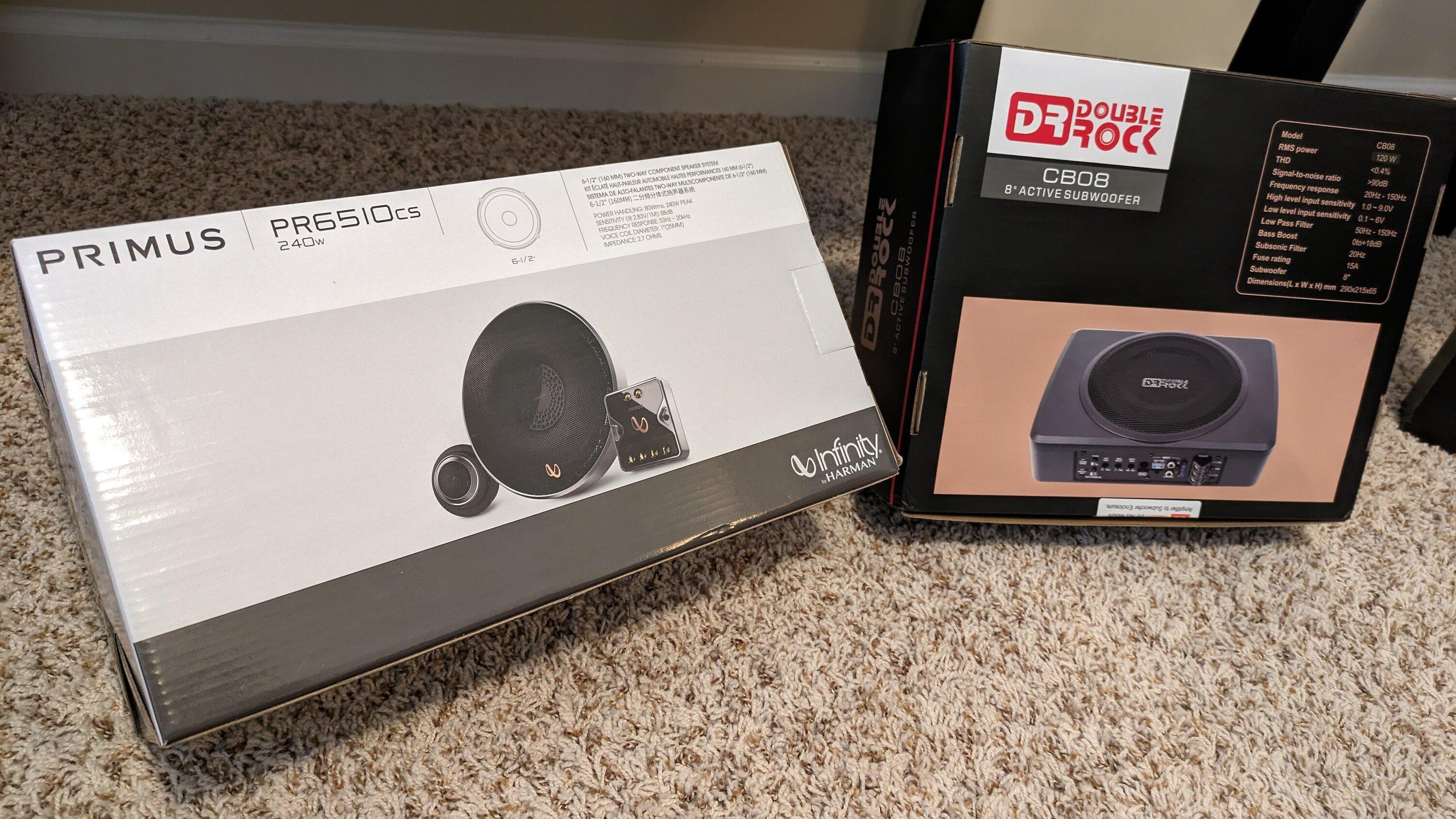

Bought TWO packs of Infinity PR6510cs speakers at $99/pack. Each box contains 2 large speakers and 2 tweeters. Also got the installation kits from Crutchfield so the total outlay with them was less than $250.
Bought one Double Rock CB08 active subwoofer...another $99 on Amazon.
11th Gen Honda Civic '24 EX Sound System Upgrade for $350 spkr boxes
Here's a comparison of the Civic's stock speakers on the right to the Infinitys on the left. Hmm, check out the size of the magnets :)
11th Gen Honda Civic '24 EX Sound System Upgrade for $350 spkr compare

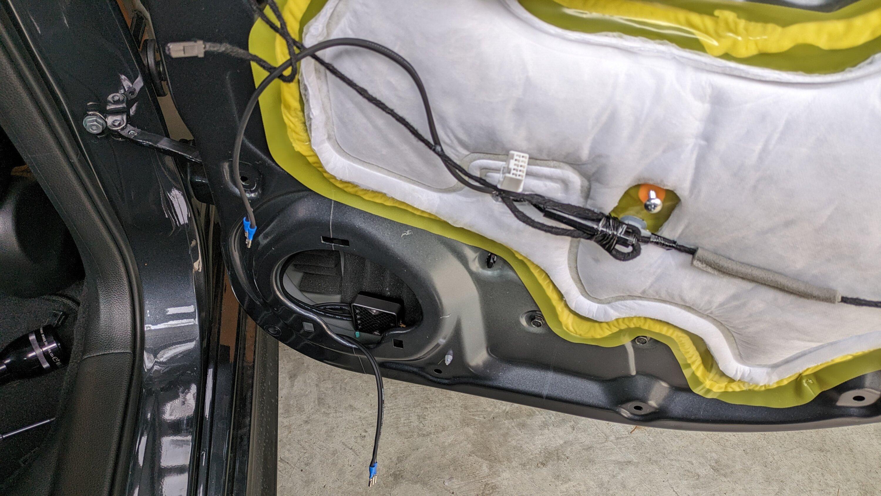

The Infinitys include a separate crossover for each woofer/tweeter pair, so I ran the original wire for the stock 6.5s to the crossover input...and then ran new wire from the crossover outputs to the new speakers. Here's one of the rear doors with the panel removed. You can see the crossover hot-glued into the opening behind where the large speaker will go.
11th Gen Honda Civic '24 EX Sound System Upgrade for $350 door pre

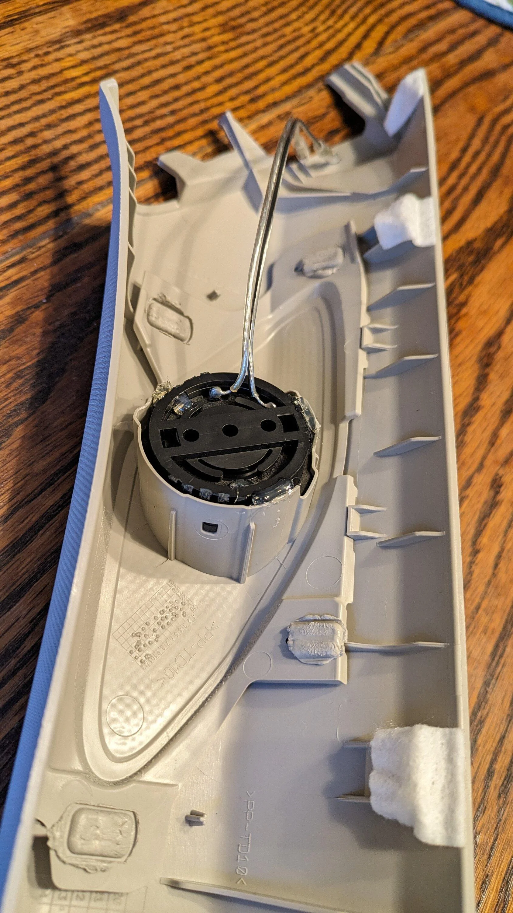

The biggest challenge was learning how to remove and replace the A-pillar trim. Once I figured that out, the tweeter replacement was easy. I just wrapped a little rubber gasket material around the new tweeters and they snugged right into the original openings. A couple drops of hot glue to secure them. Running the tweeter feed wires from the crossover in the front doors up to the pillars was no fun. I ended up making a small hole in the bottom of the rubber grommet where the door hinges and running the wire mostly hidden up the trim to the pillars.
11th Gen Honda Civic '24 EX Sound System Upgrade for $350 tweeter install
While the A-pillar trim was off, I extended the original wiring to the stock tweeters and snaked it thru the moulding to the front passenger seat location where the under-seat sub would live.

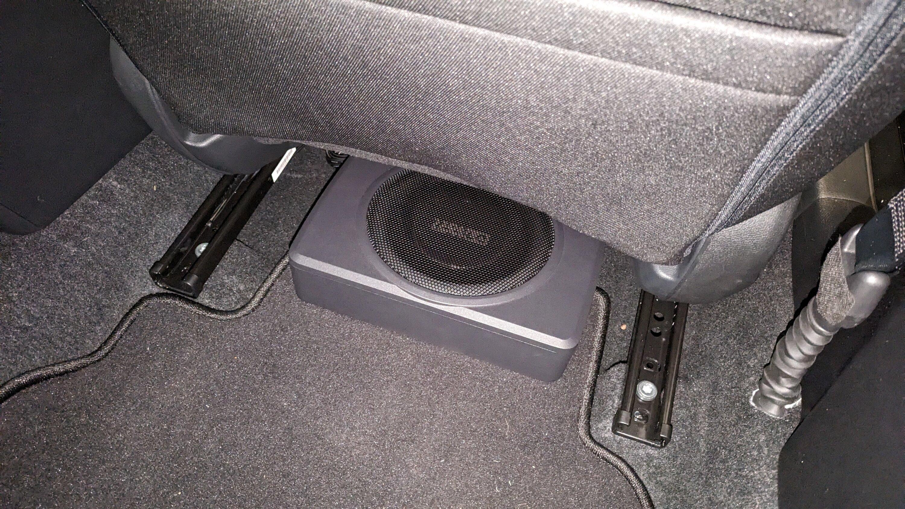

It may sound strange to feed a sub with a tweeter wire, but since the stock setup just used a capacitor on the tweeter to block bass, the feed wire actually has the full frequency spectrum and you get plenty of bottom to send to the sub.

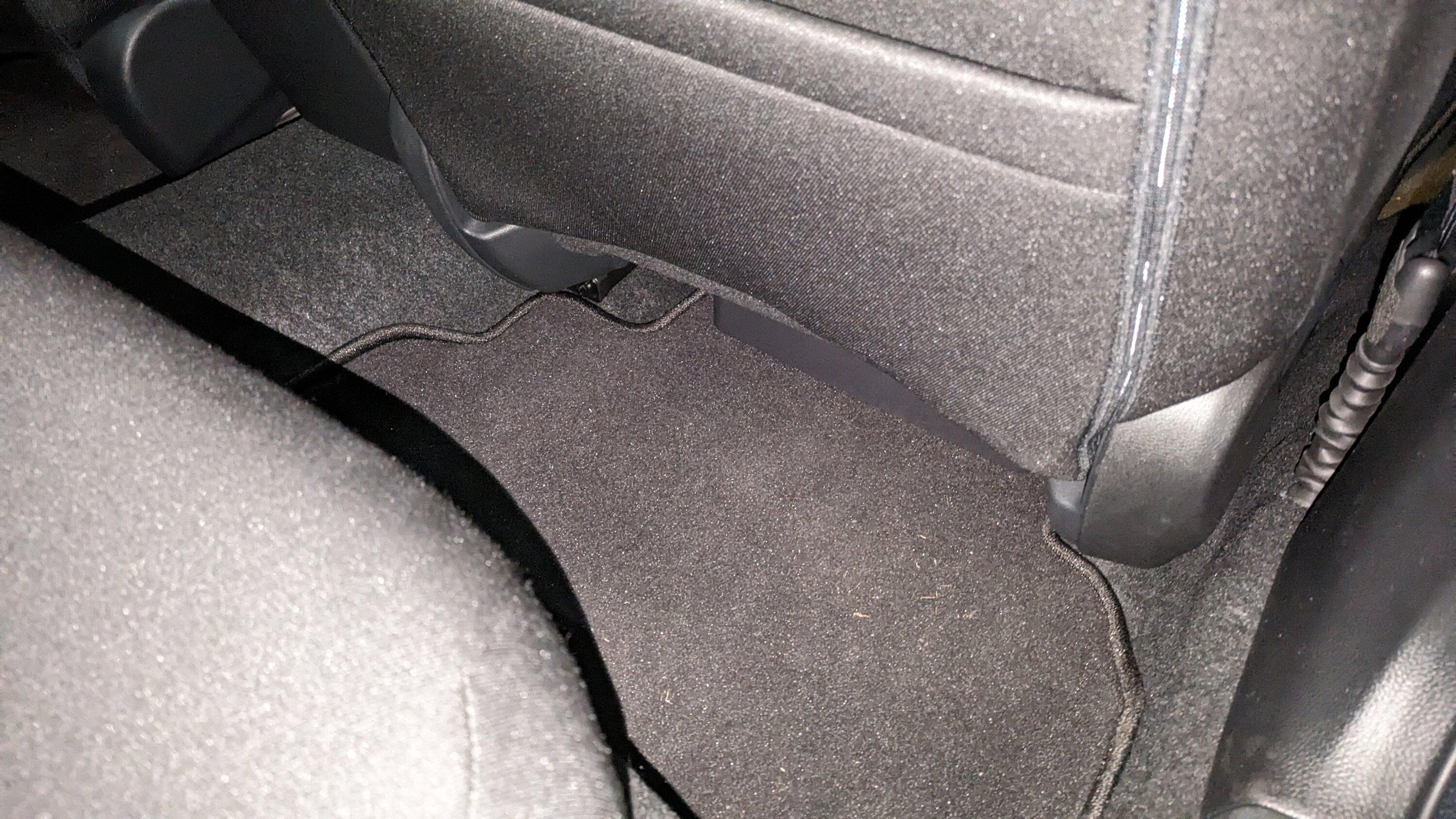

11th Gen Honda Civic '24 EX Sound System Upgrade for $350 underseat sub
This Double Rock unit fits very well under the seat. (A lot of the so-called “under-seat” units do not!) The above pic is with the seat full-forward. Here is a shot with the seat at a normal depth. You can just see the edge of the sub.
11th Gen Honda Civic '24 EX Sound System Upgrade for $350 underseat sub 2
At no time did I have to remove or access the actual head unit. All wiring was connected to the original lines in either the doors or at the A-pillars.

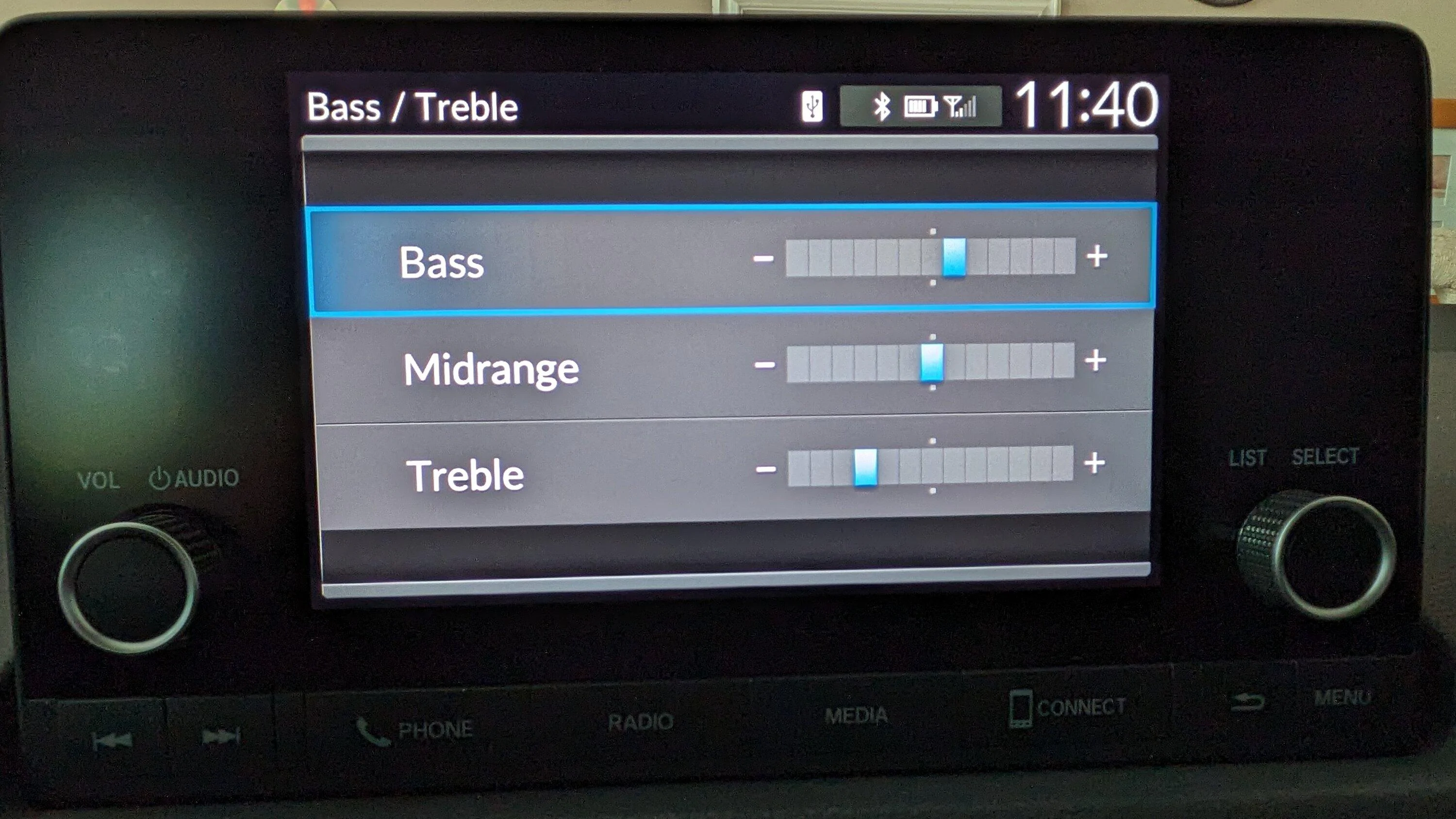

The Infinity tweeters do tweet! So I found setting the bass/mid/treble as shown below tames the highs enough to sound really good. In fact, if your high-frequency hearing is still in good shape, you might want to even go a click or two lower on the treble control.
11th Gen Honda Civic '24 EX Sound System Upgrade for $350 bass mid treble

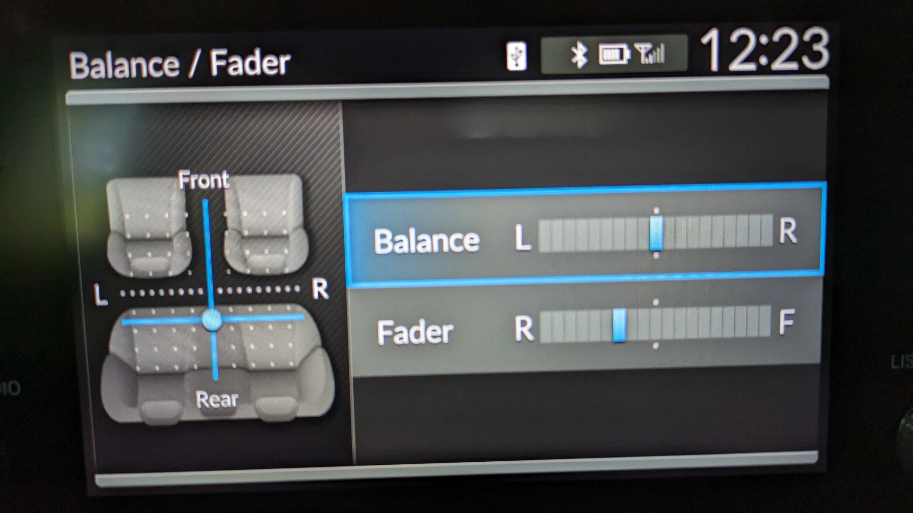

And, just a personal preference, but I like to move the sound stage a little towards the rear so music seems to come from the sides instead of from the dash.
11th Gen Honda Civic '24 EX Sound System Upgrade for $350 fader settin

The Infinity tweeters do tweet! So I found setting the bass/mid/treble as shown here tames the highs enough to sound really good:

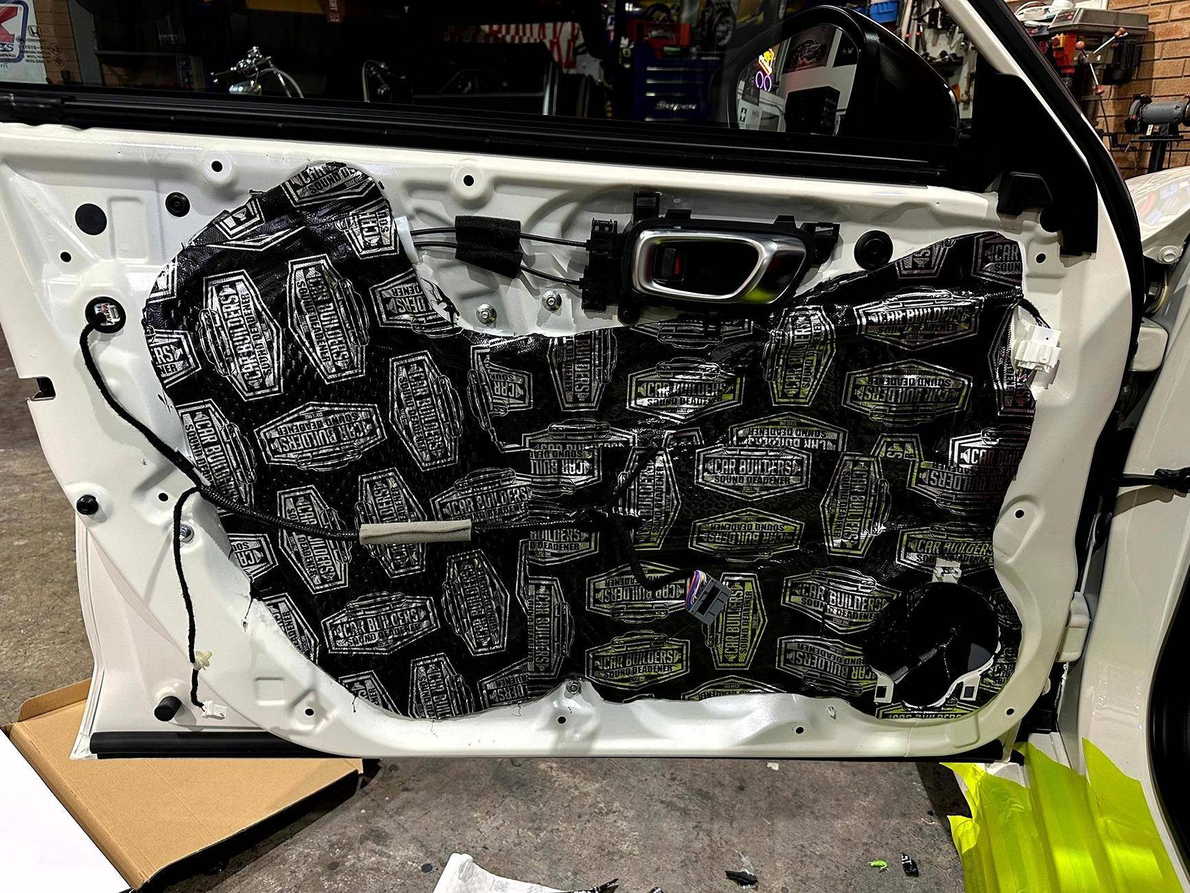

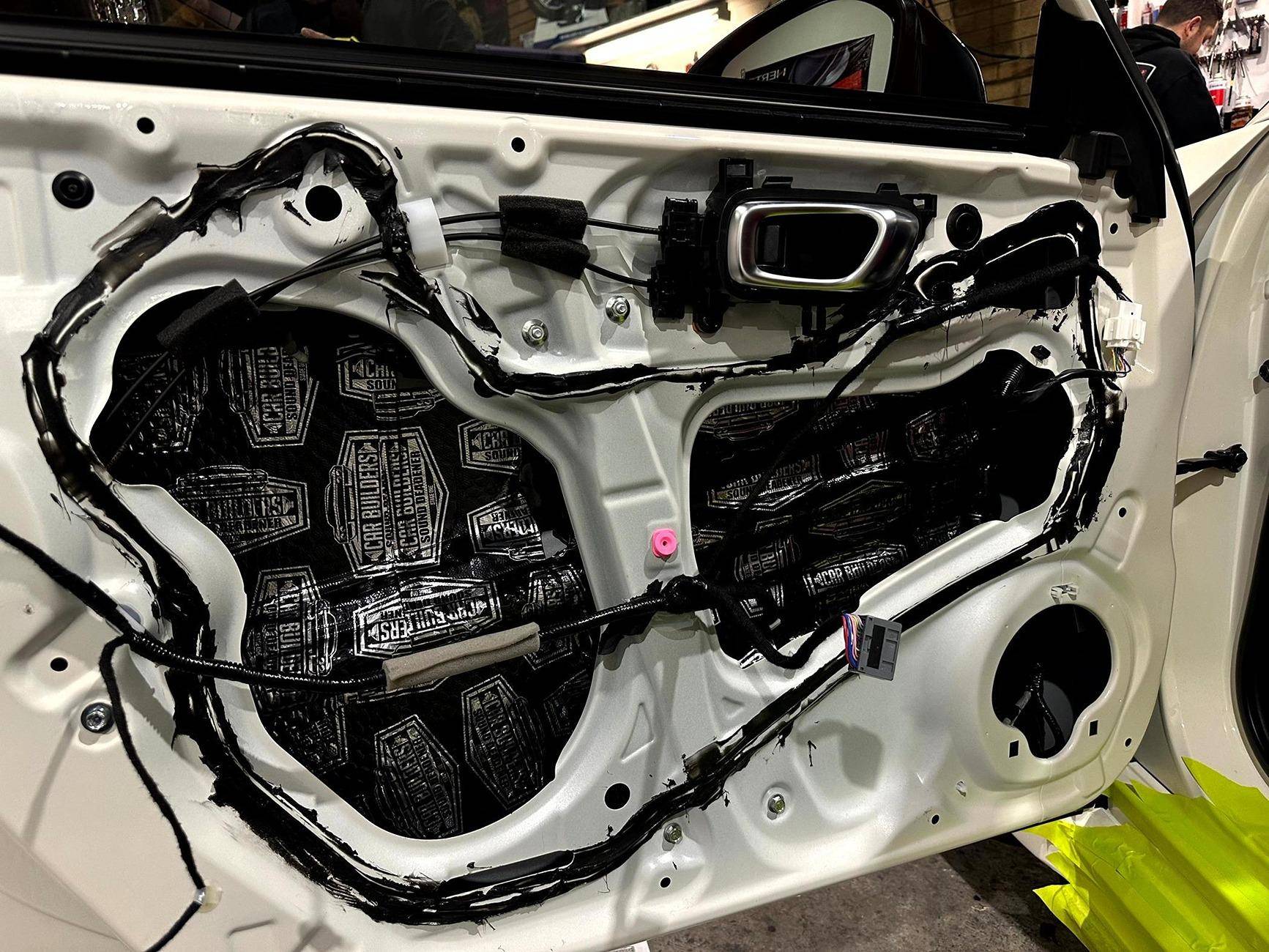

I've done it and I highly recommend it. A little quieter on the road and much better feel to the door closing. It has a really satisfying thunk to it. Also stops any vibration from the speakers. I tested the difference in road noise with a DB app and I remember the results were marginally quieter, but I think because the door is right next to your ear, the real world impression of road noise is definitely quieter.
The black goo that is in the door panel for noise was sticky and awful to remove, but it's worth it. If you're doing the speakers I personally think you have to do it. Adds negligable weight, so I did two layers as seen in the photos below.
11th Gen Honda Civic '24 EX Sound System Upgrade for $350 IMG_9503
11th Gen Honda Civic '24 EX Sound System Upgrade for $350 IMG_9505

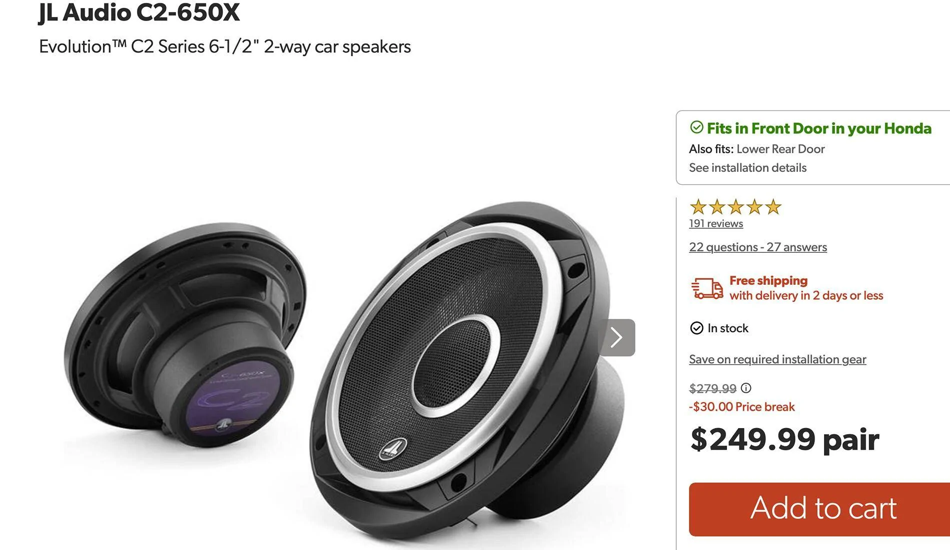

I've just received some speakers from Crutchfield.
JL Audio C2-650X Evolution.
I'm waiting for the installation kit, which should arrive tomorrow.
I expect to install them in 2 weeks.

I installed the two speakers mentioned above. I did some sound tests. The sound quality is now very acceptable. It's not wow! But compared to the sound of the original speakers, there's no longer that nasal sound. I'm satisfied, it was worth the expense. C$344 with tools and some accessories to fit in the door.
