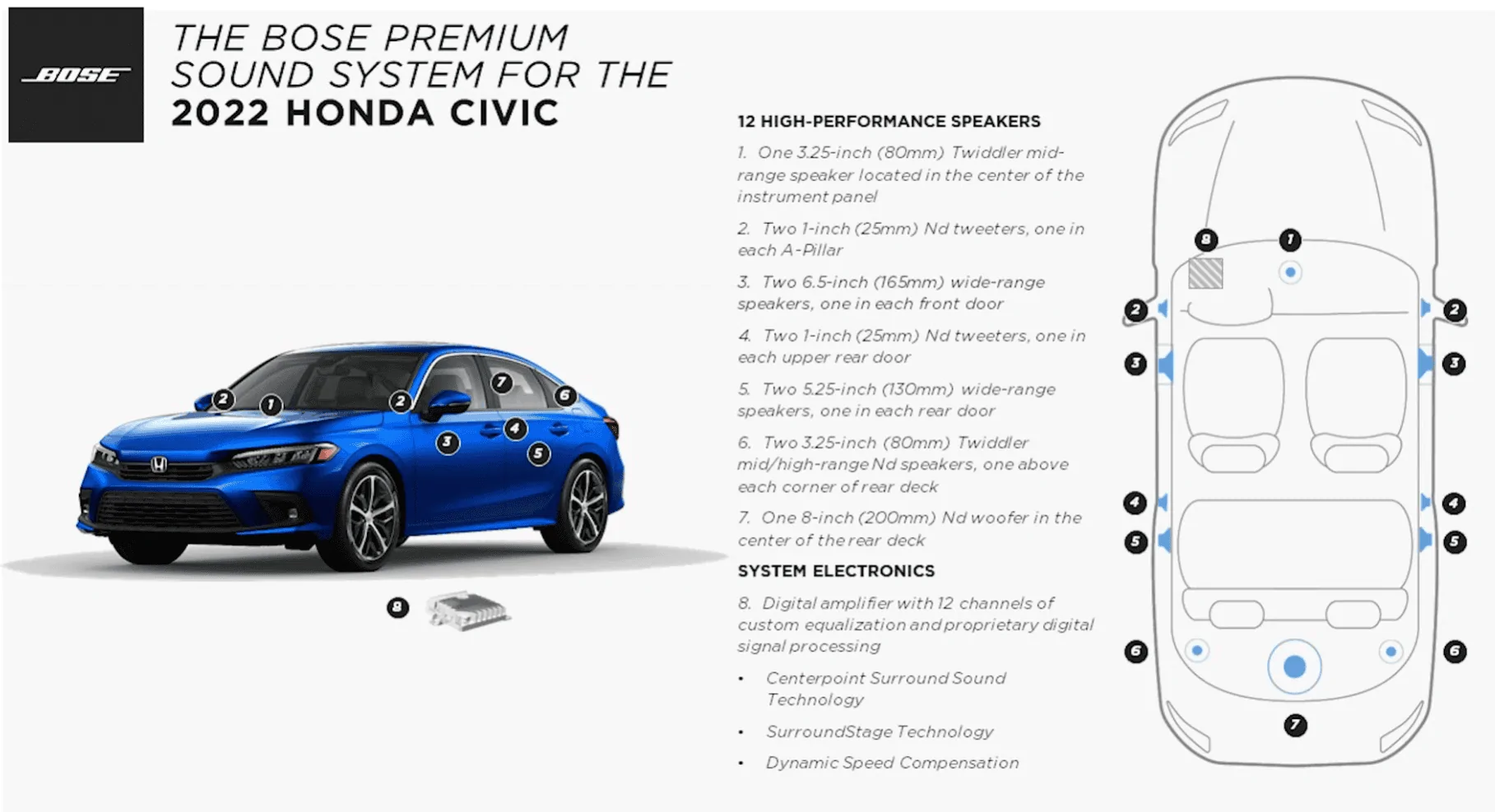

This is the closest I can find regarding the Bose system and the speaker sizes. Sport Touring and Type R should have close to the same setup, obviously the rear will be different because of the hatch.

6.5" for the doors, 1" tweeters - that diagram is basically the same as our car except the sub location is different. There is another thread where we got into it a bit more and listed some suggested parts.
Difficulty? Door speakers are like a 1/5, tweeters can be a little bit more if you need to fiddle with housings 2/5. You're just swapping stuff out, with a little research you can find plug & play harnesses so there is no splicing/replacing connectors.
