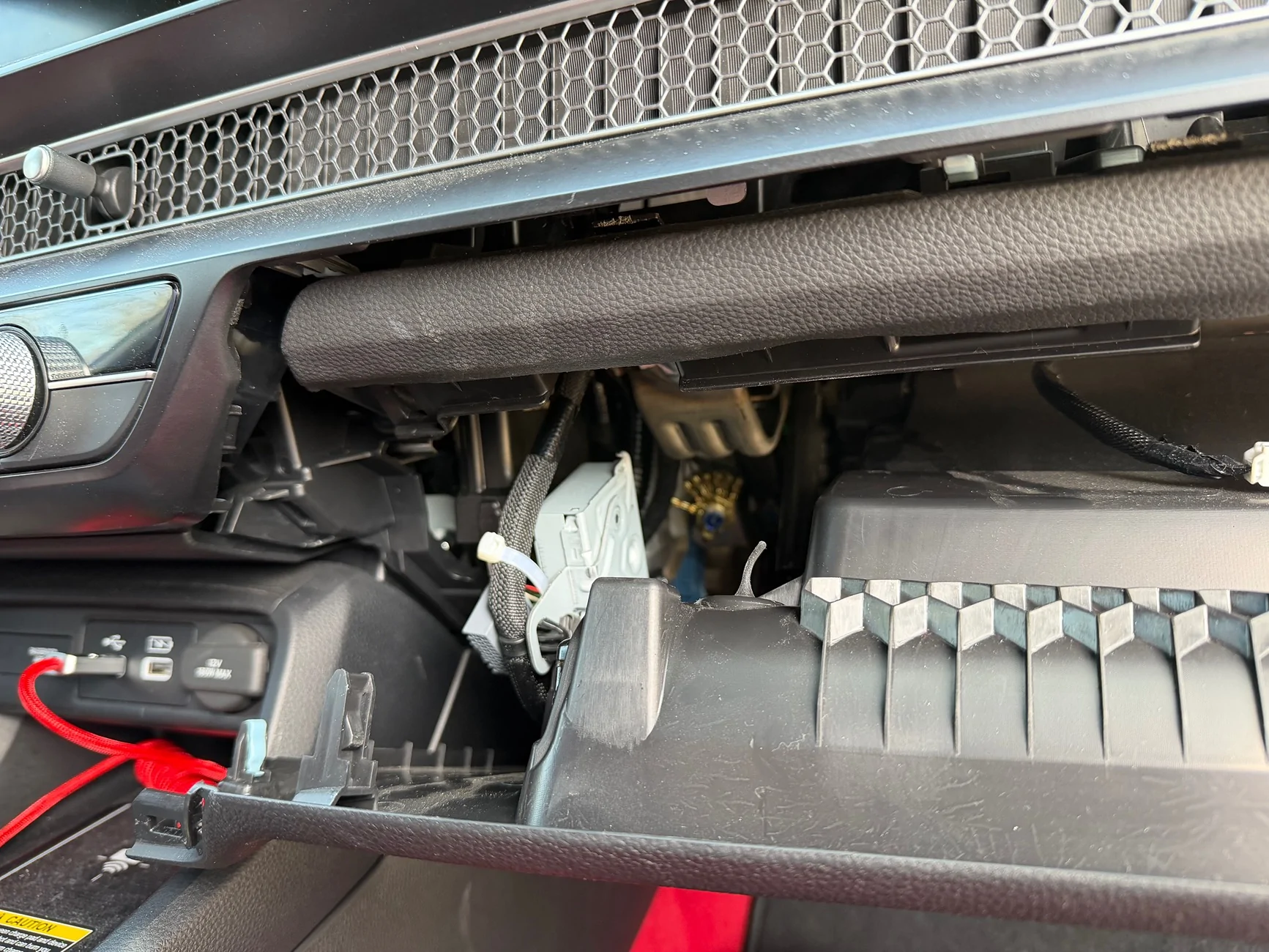

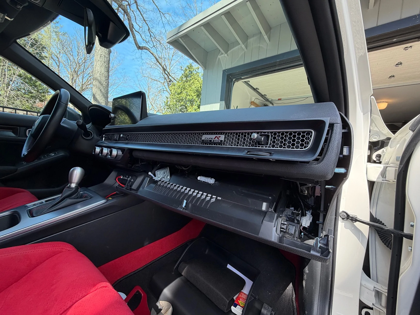

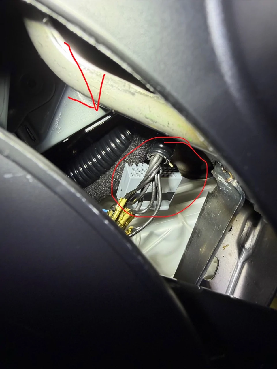

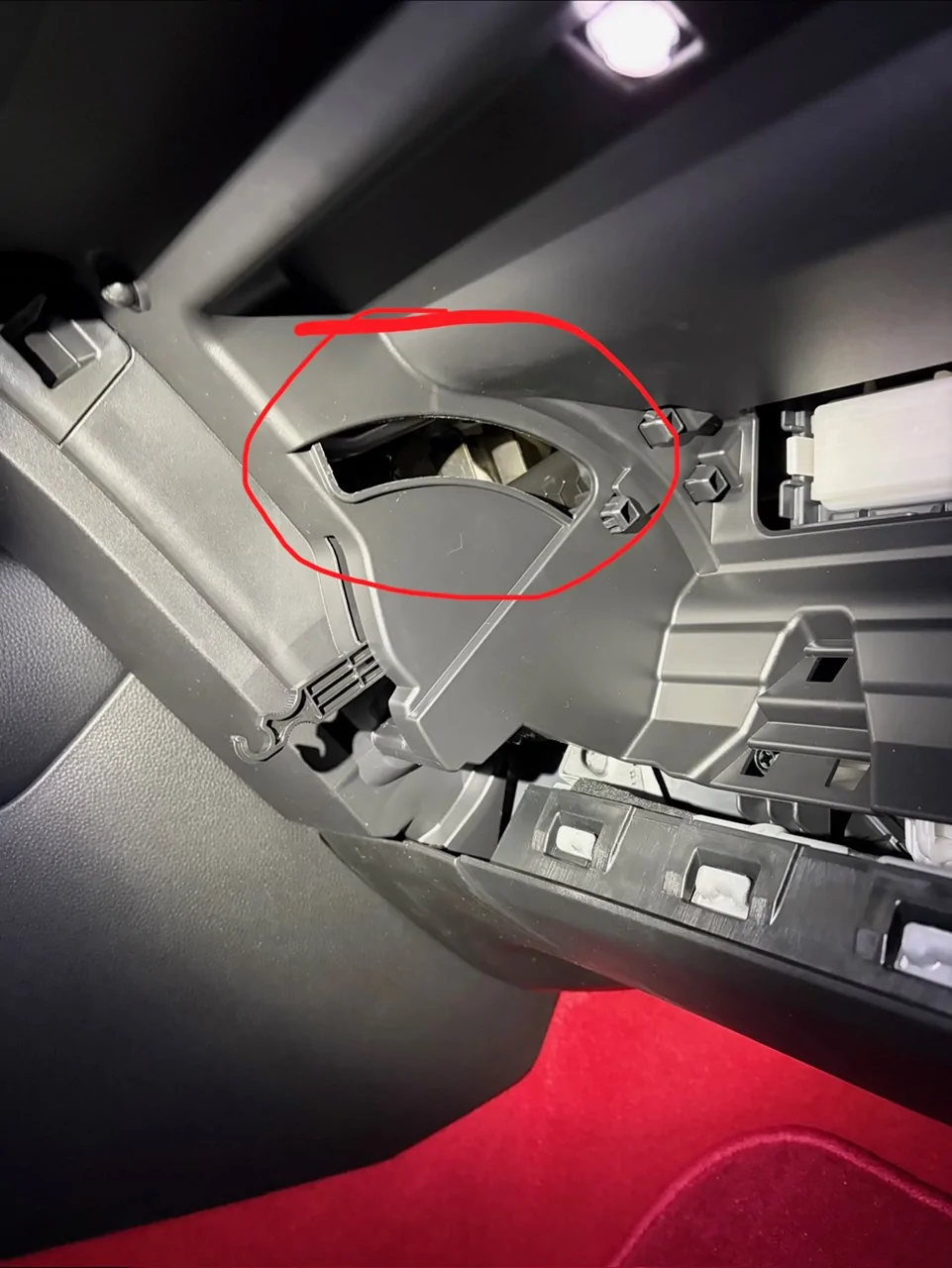

Just in case anyone is still curious, you don't have to take the dash apart to unplug it. I did it just by removing the glove box and then using a 90 degree pick and a flat head screwdriver. Now, it's a bit awkward to do it while trying to see what you're doing, but basically just reach the pick in the slot for the glove box past the connector and use the end of it to press the locking tab that is facing away from you on the other side of the connector. Once you have that pressed you can use the flat head to push on the lip of the connector to get it out of the module. I got lucky and got it right away so the whole thing took just a few minutes but you might end up fiddling with it some. Just figured I would let people know it's possible to unplug without taking the dash apart whatsoever. I attached a couple of pictures so you can see which slot and plug I am talking about. Hope that helps someone.
I tried this for about 15 seconds and realized i wasnt gonna try to fight it.. my pick wasnt long enough (story of my life), so i decided to just pull the dash apart. Would have worked out great with the right tools.
Thanks for all the instructions everyone! I was mostly worried about breaking clips. I did manage to pop off the plastic piece (linkage arm) that connects the vent louver to the vent dial when putting it back together. Pretty easy to figure out how that went back together. Id suggest closing that vent before pulling it apart if you are worried about doing that.
That's unfortunate. I know it's a bit awkward and won't workout for everyone, but just figured I would share if anyone wanted to try that first before taking things apart. Glad you got it done the other way though! :thumbsup:
