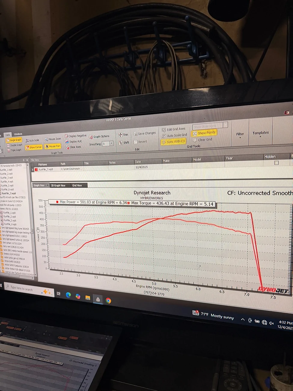

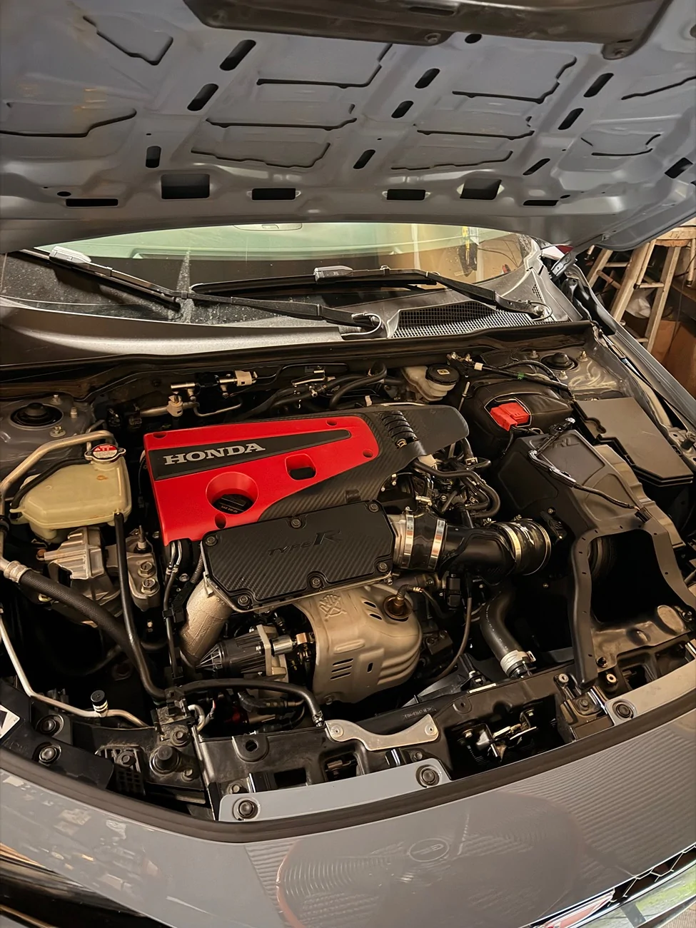

Hey guys just wanted to show you guys my build and for those who are trying to get 500whp. Hondata HPFP was limiting my ethanol count. I would recommend getting xdi or full race for more power. I will definitely be changing my hpfp down the road. Car is tuned by Hybridworks in Vallejo, Ca
Tuned on a Dyno Jet 501WHP 436 Torque
Mods List:
Rv660 Turbo
Prl intercooler
Prl charge pipes
Prl intake hvi
Plm downpipe
Plm front pipe
Hondata hpfp
Hondata injectors 1330
Hondata low fuel pump
Hondata canflex
Stock exhaust
Stock inlet pipe
E37 33PSI

Nice setup so far and very stealth lol. Few upgrades and you will easily join the 550+ club. I am going with the Full-Race HPFP and Hondata 2000cc Injectors on my build so I dont have to worry about running out of fuel. Keep us updated if you change things up but looking great so far :headbang:
I plan on running Hondata HPFP plus Hondata 2000cc injectors. How much of difference would full race HPFP make? On MHI turbo
