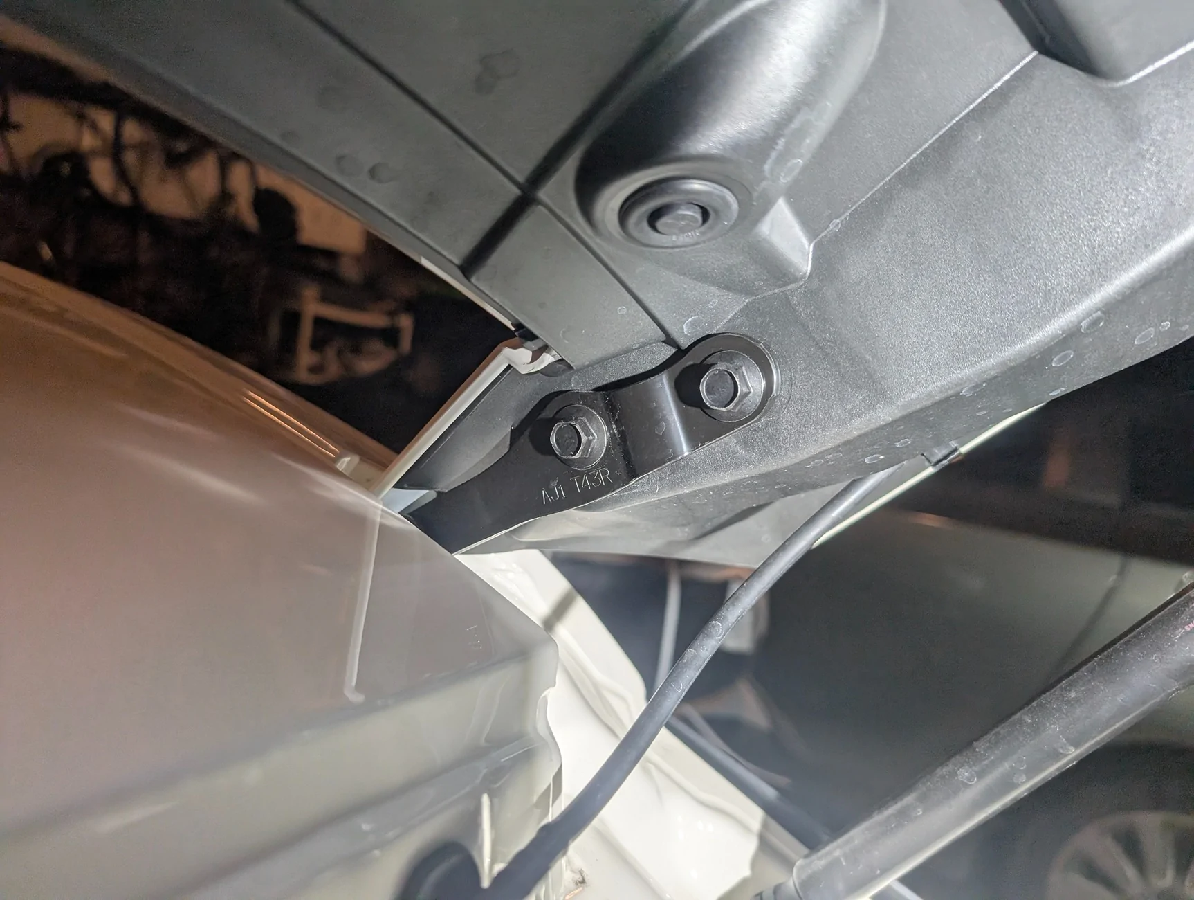

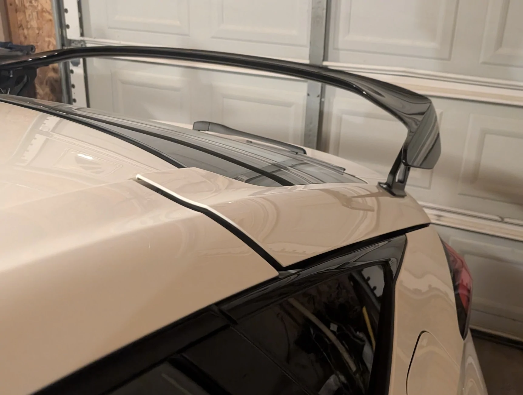

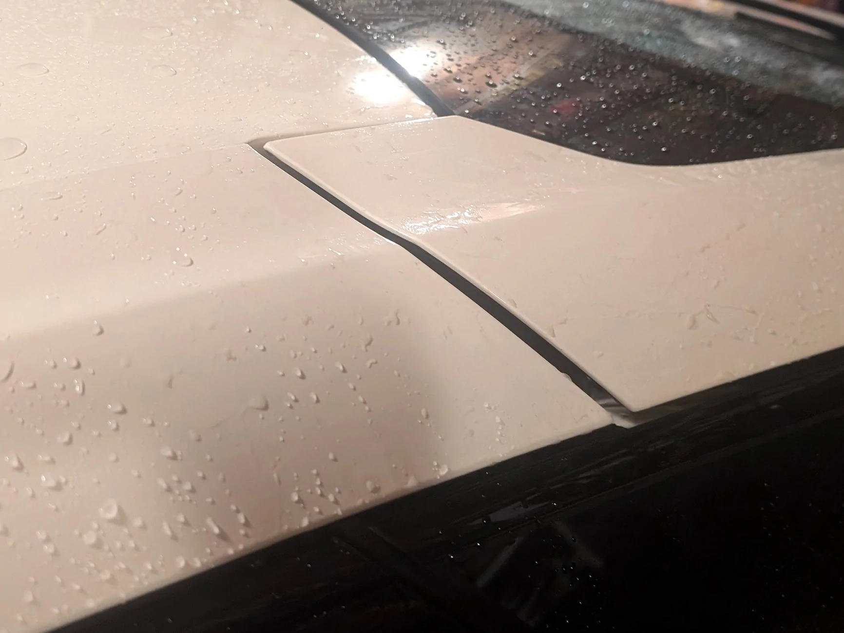

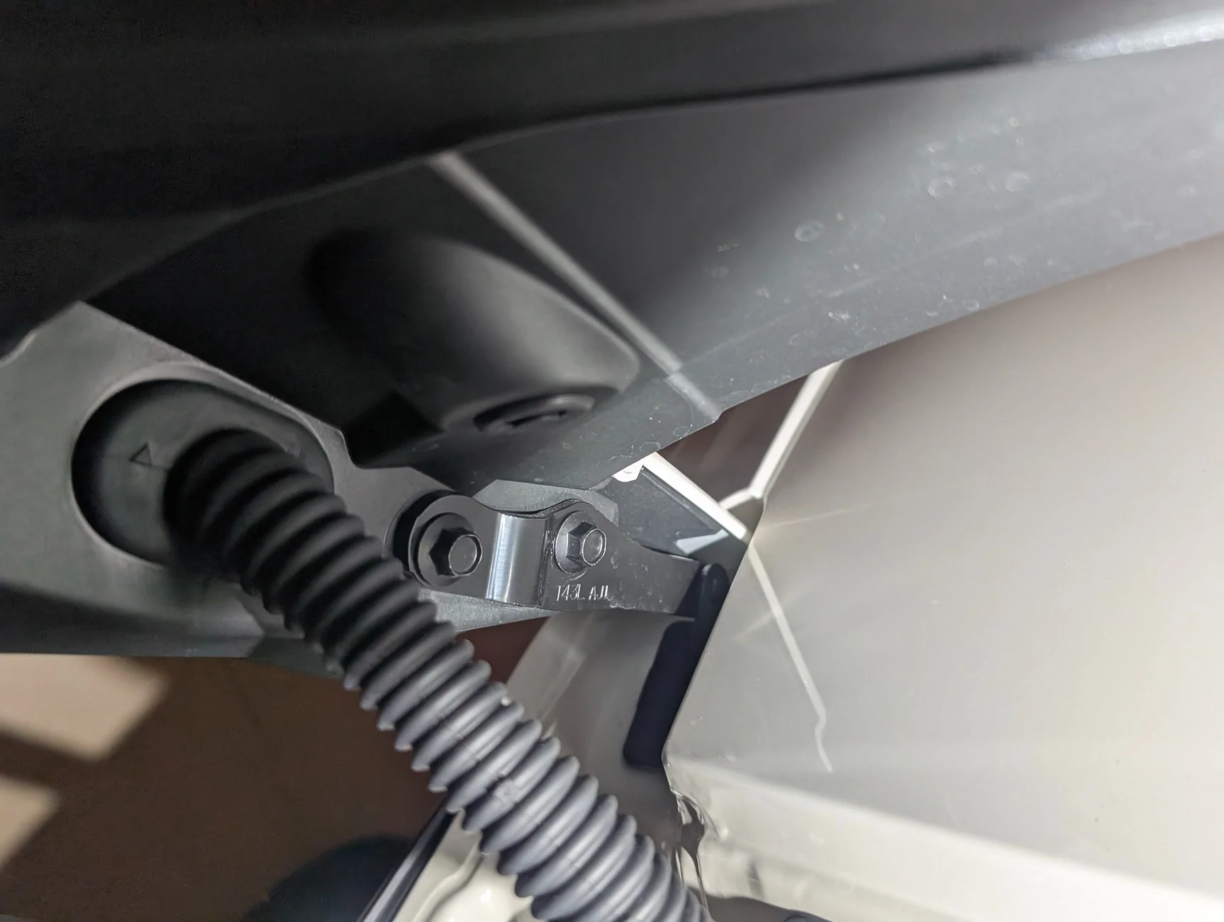

I could be missing something subtle, but it really looks to me as though the hatch has slid on the bolts/hinge. I see no evident bending. I don't see any obvious witness marks, but I expect it'd be on the black plastic of the inside of the hatch (making it a lot less obvious?).
I've attached photos the outside of the hatch where it is "lifted" and of both hinges. I think I can convince myself that the driver side hinge is not in the same position as its counterpart, based on its position relative to what I assume are plastic mold lines, not witness marks.
I won't bother to attach another picture, but the gaps on one side of the hatch are noticeably wider vs. the other across the whole hatch.

It looks like there may indeed be witness marks under the front most bolts on both sides. Looks like the drivers side moved much more if that’s what I’m seeing. That would be good news!

I do see some obvious movement evident based on the bolt scoring on the driver's side, but it doesn't look like enough to account for all of that gap. Still, it's worth adjusting back to where it was based on the the marks and see how close that gets you.

Hopefully the frame of the hatch isn’t bent also.
That’s a pretty big gap..
