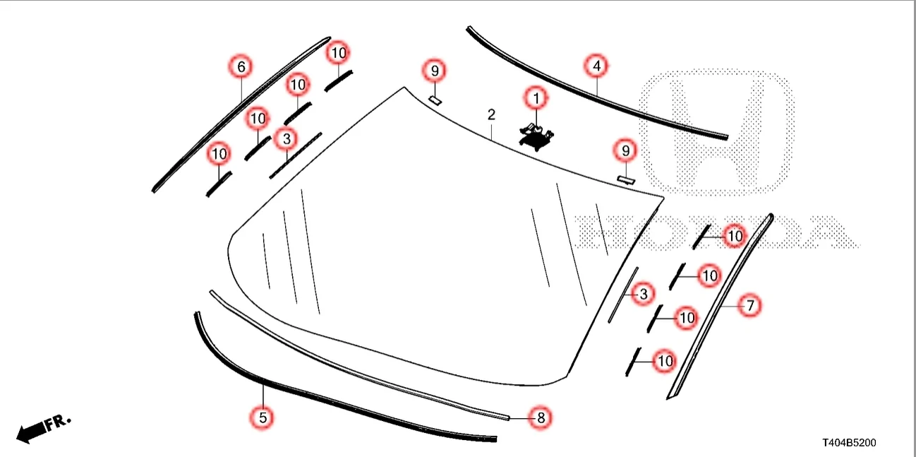

My question is would the OEM seals be compatible with the aftermarket glass as I've heard that it's generally thicker? From what I can see on the front window assembly there are 3 seals required numbered 4, 8 and 5 as per below.

The CTR and regular hatch use the same seals. Even though the windshields are marginally different
Oh ok that's good to know, regarding the items listed in the diagram are all needed for the glass replacement or just the seals?

See below for parts required for future reference if you need your windscreen done and need OEM parts.
