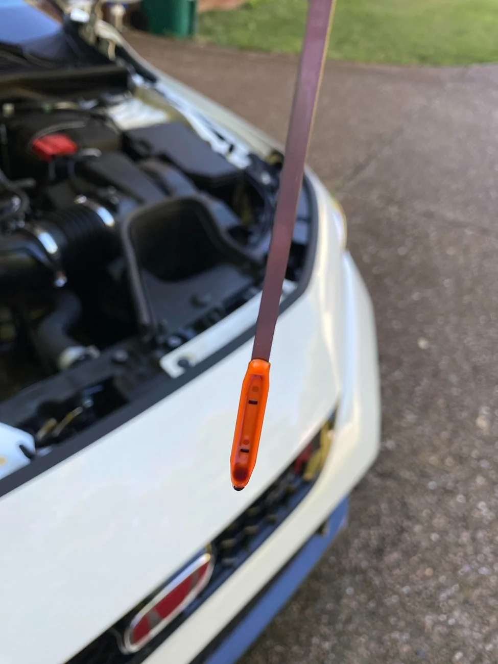

PMFJI - I drive a 2025 Civic Type R, all stock, daily-driver / commuter approx. 30 miles each weekday ... 5000 miles and 10 months the dipstick looks like attached, how do you read this, does the dark section on bottom count or the filled holes mark "full" ... ? Honda App shows oil life at 30%
would you do first oil change at the dealer or yourself ? I've some experience doing oil changes on my 1994 Mercedes W140 S600 but never on a Honda,
thanks !!

Dipstick is the worst design I've ever seen. Clean off, reinsert and withdraw to read. I can just barely make out the level after that using magnifying glasses.
American Honda offers free oil changes for a while (was 2 years on 2024's). I change my own, but have decades of experience and tools. The tray under the FL5 engine is a hassle and pretty much requires ramps for safe and complete access.

thanks for your reply, really appreciate it, and agreed on dipstick design being much too hard to read, this picture was after 3-4 clean and reinserts, I think I'll have the Honda dealer do first oil change, although I do have ramps, I put the Mercedes S600 on ramps for oil change as well,
thanks !!
