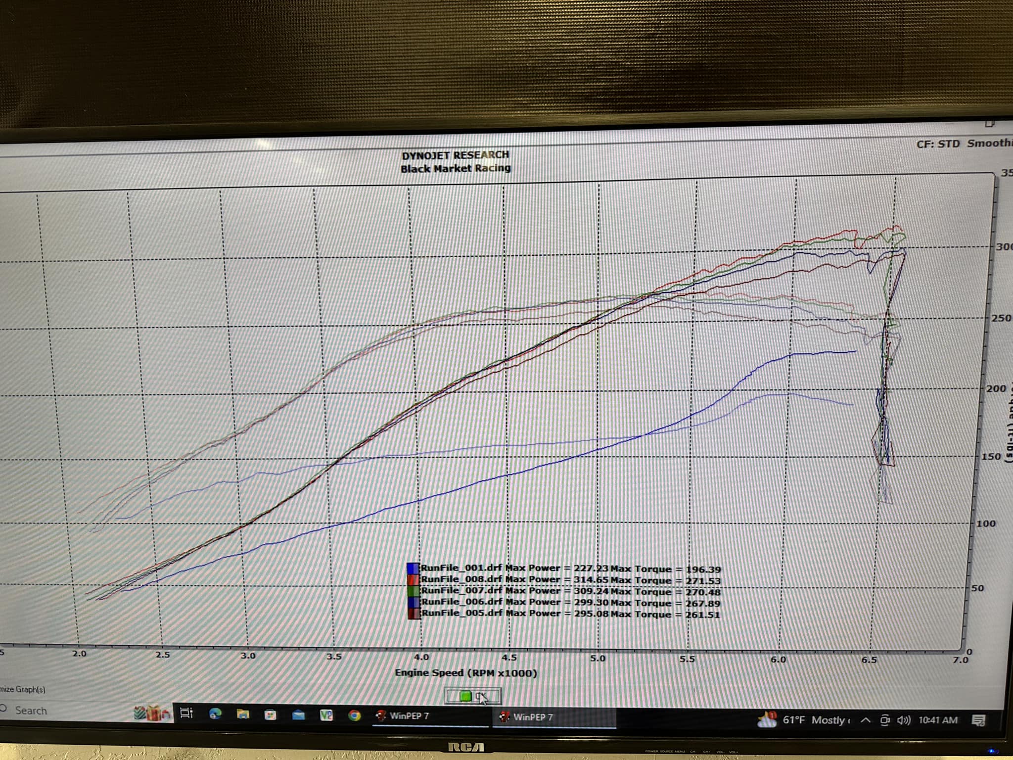

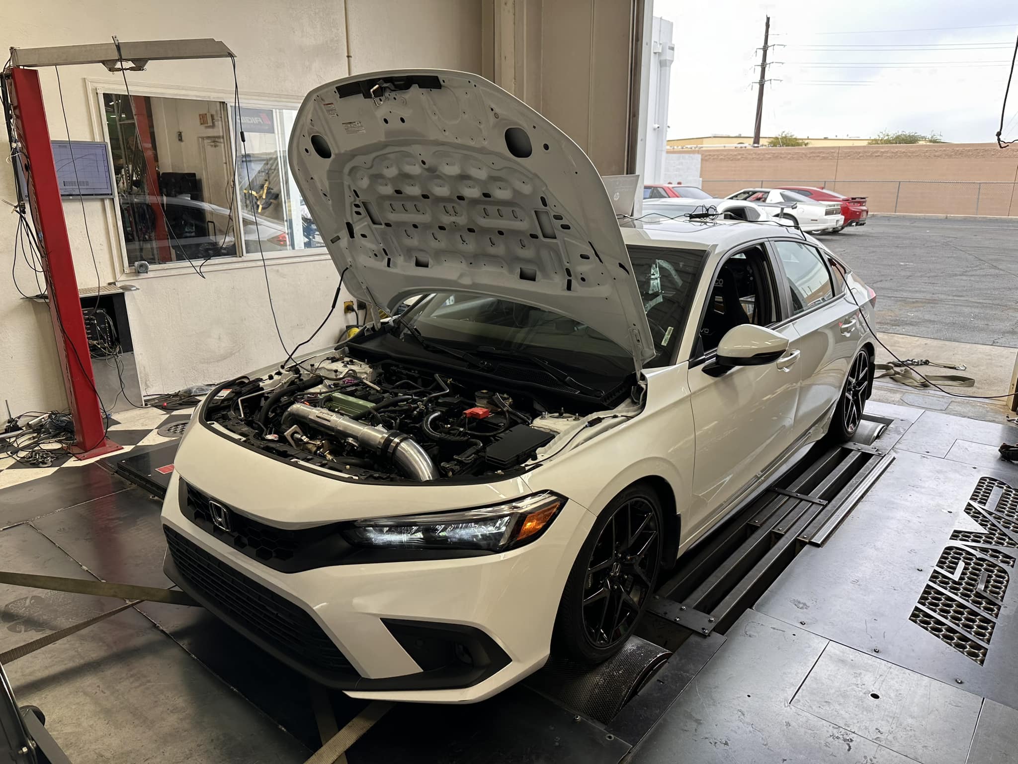

What a day we had tuning with Derek at IMW. Got to test out our upcoming inlet pipe intake combo and the new RV6 turbo on 108 unleaded gas and the results were pretty good.
We have converted the car with the Si cam, injectors and Di pump however the ecu would not allow for more fuel pressure due to being the sport touring so we had to stop at that power point but it had lots more in it.
Hope you guys like the results and we will post up the dyno videos later today
314Whp and 271Tq

You guys can see the dip at the end showing the loss of fuel
