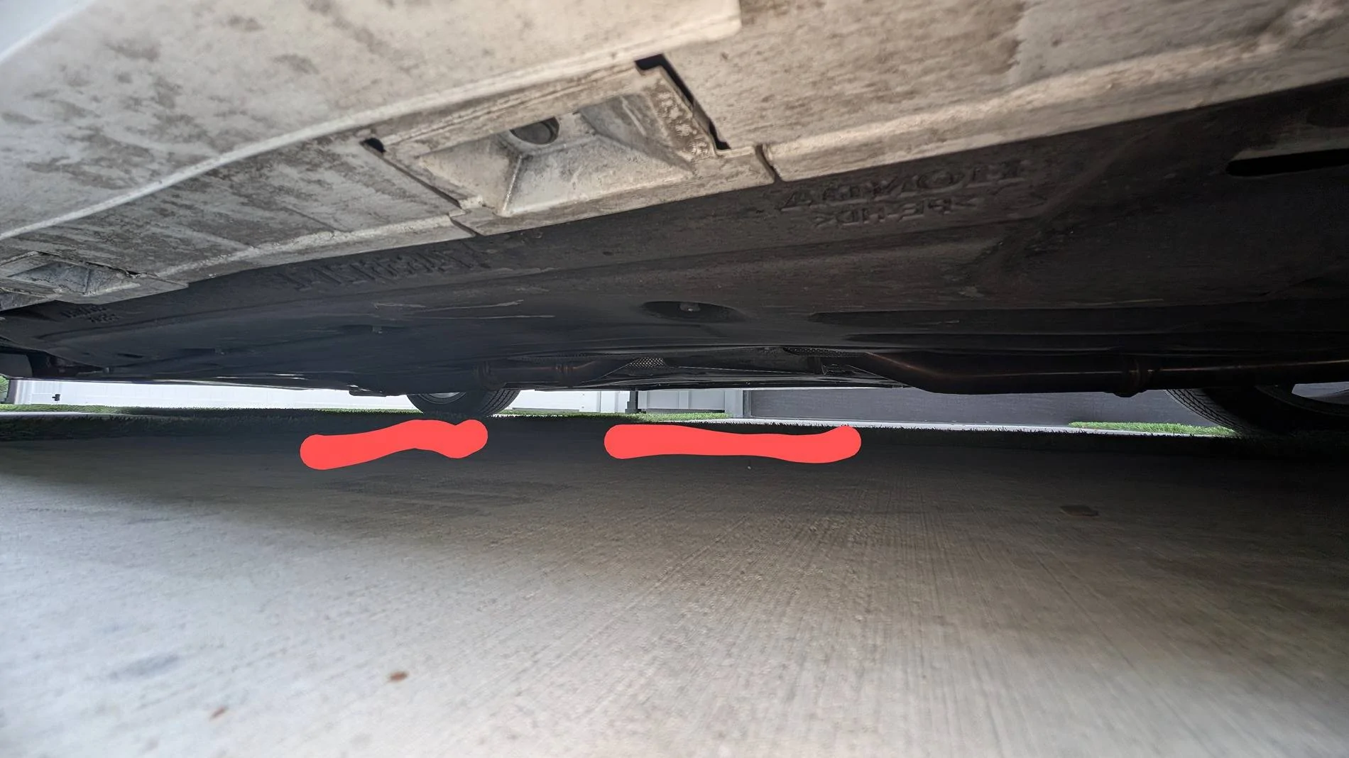

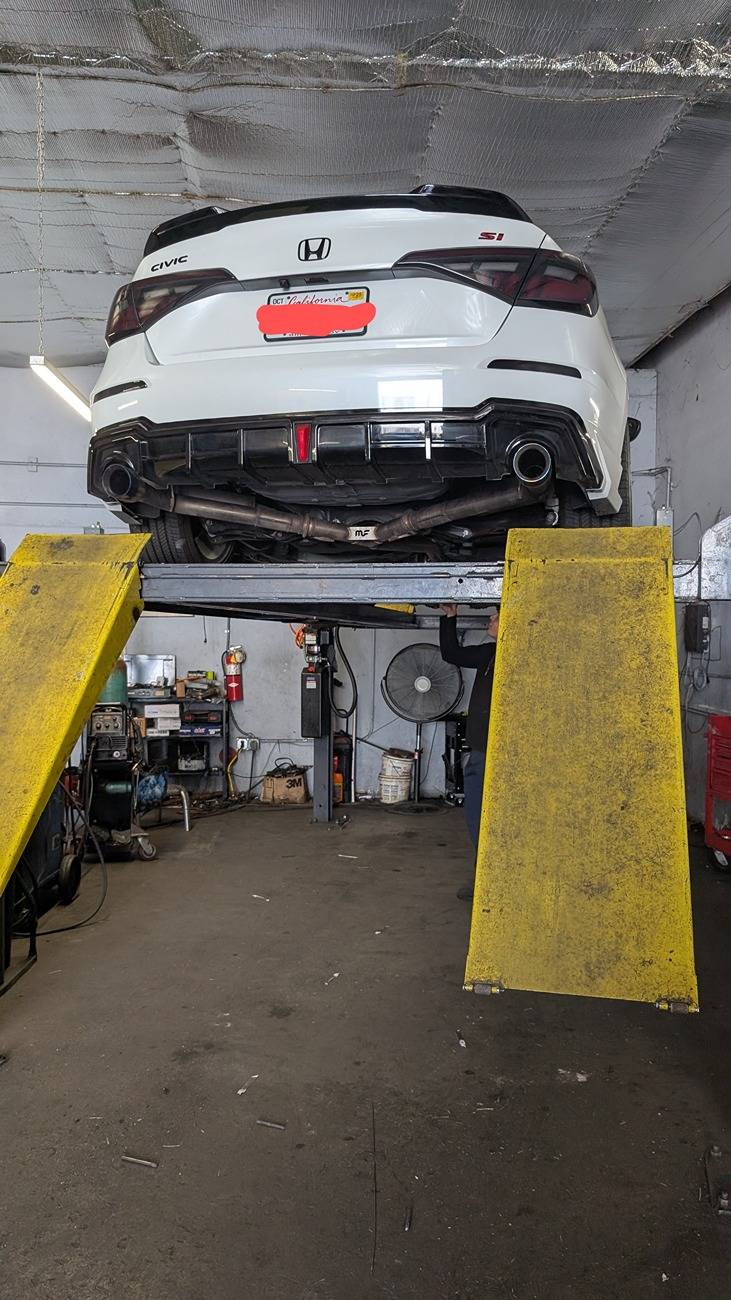

There's not a whole lot of room with the 2 resonators installed. I wouldn't want to add in a muffler and restrict airflow. (Added photos)
