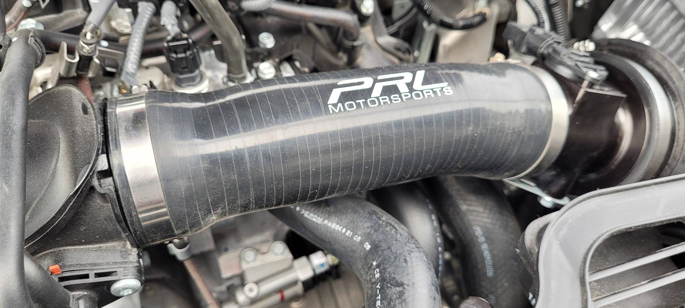

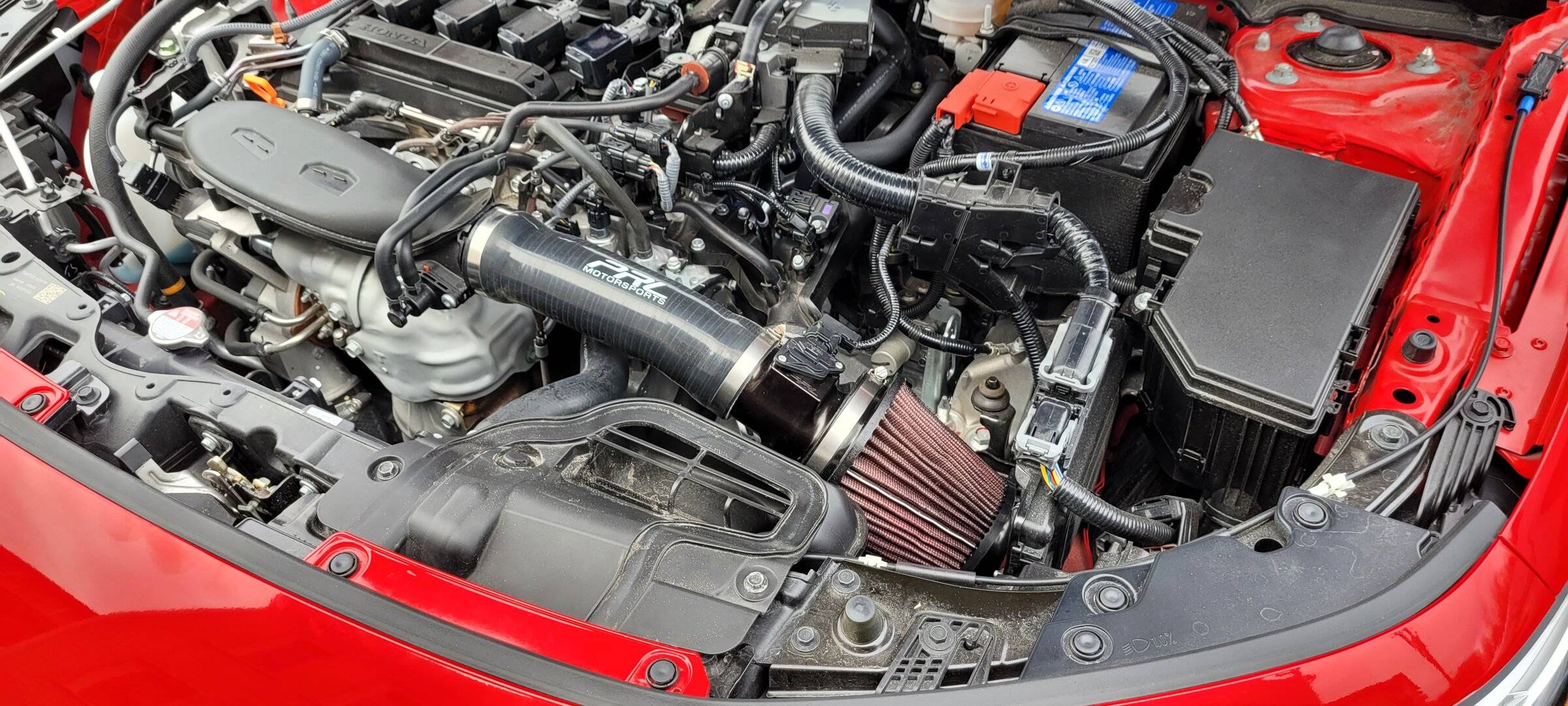

I still had my PRL Short Ram from my 2020 SI so wanted to see if everything would fit

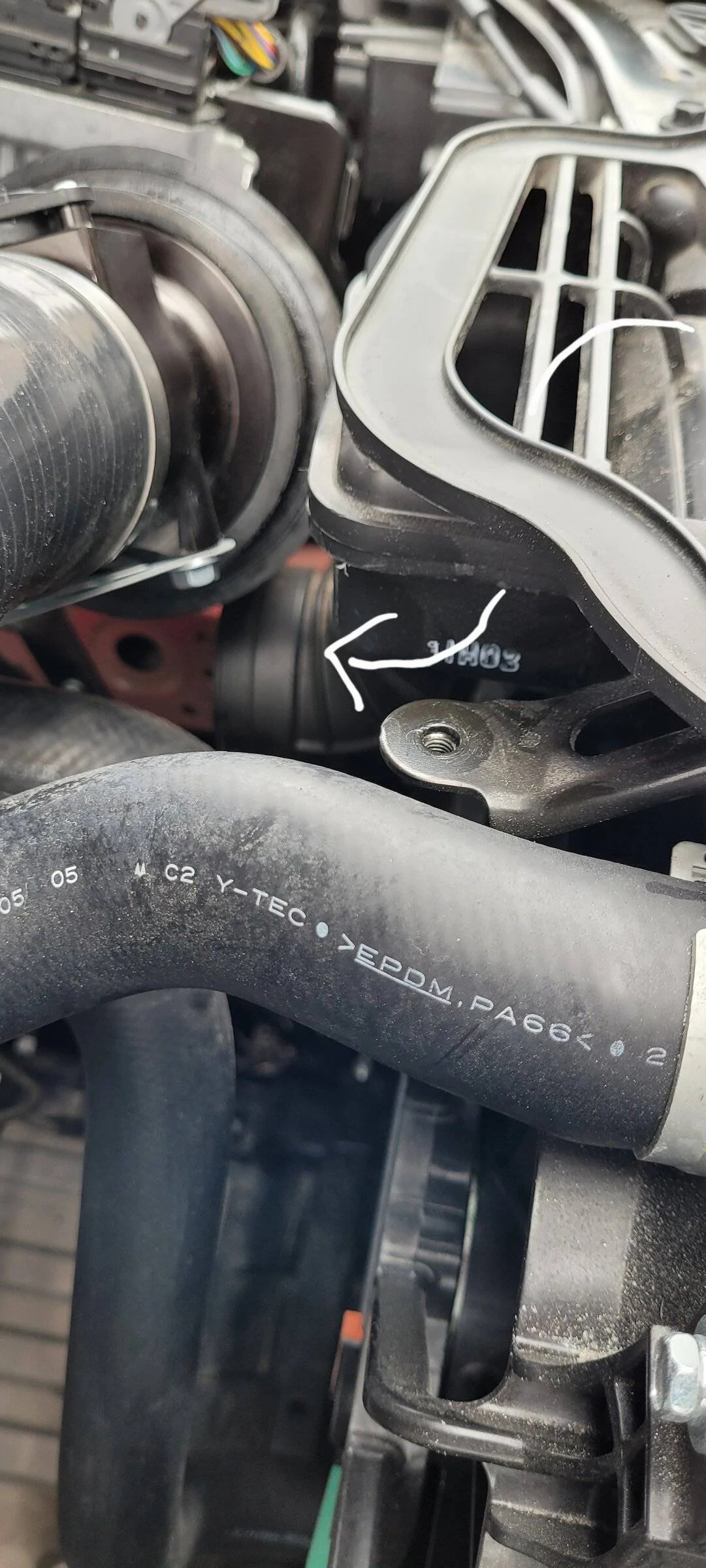

Everything fits #1,a little tight where the turbo inlet is ,but fearly easy to fit..

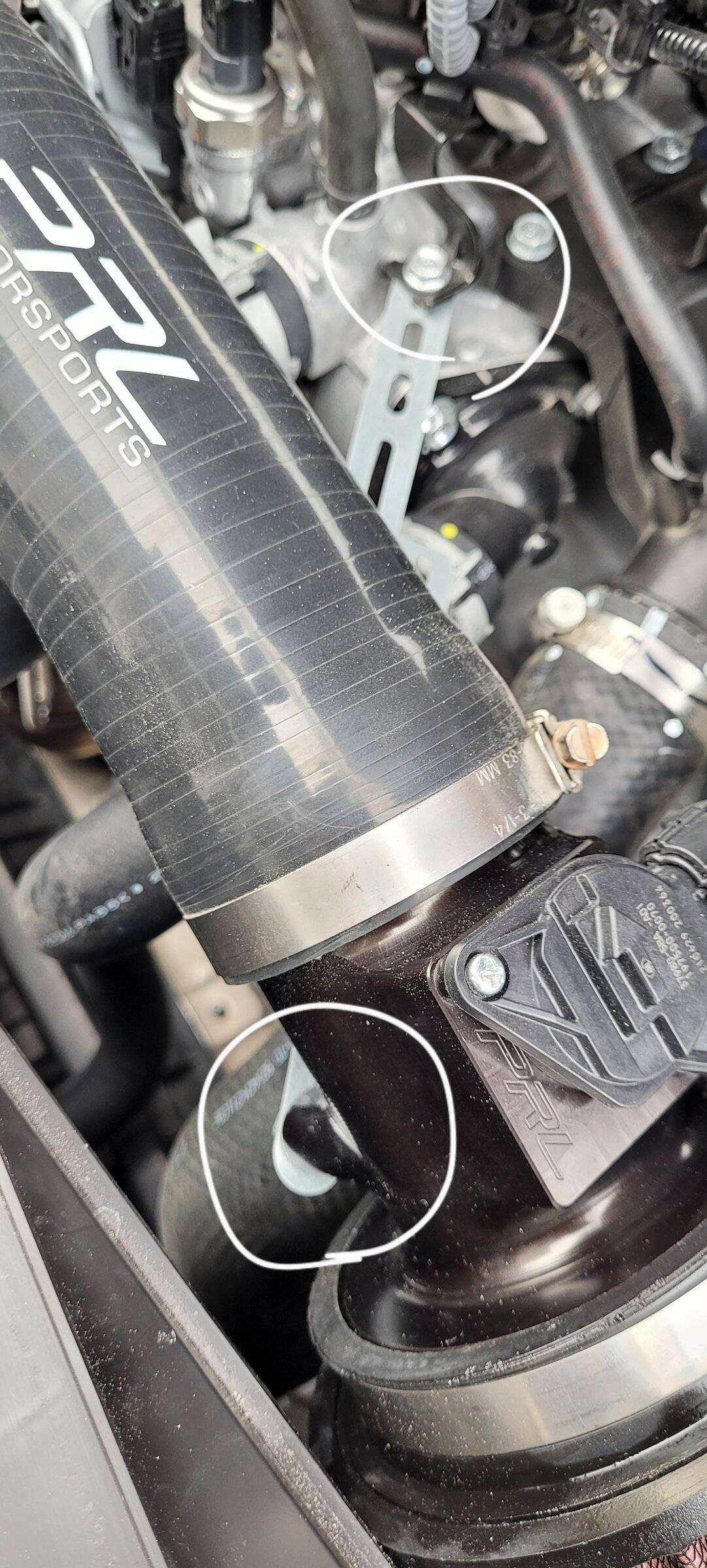

The only thing is the bracket that comes with the 10th gen does not fit...
You can leave it like that,but i made my own little bracket just to be safe..also i
left a part of the oem filter inlet to let the air get under the filter..

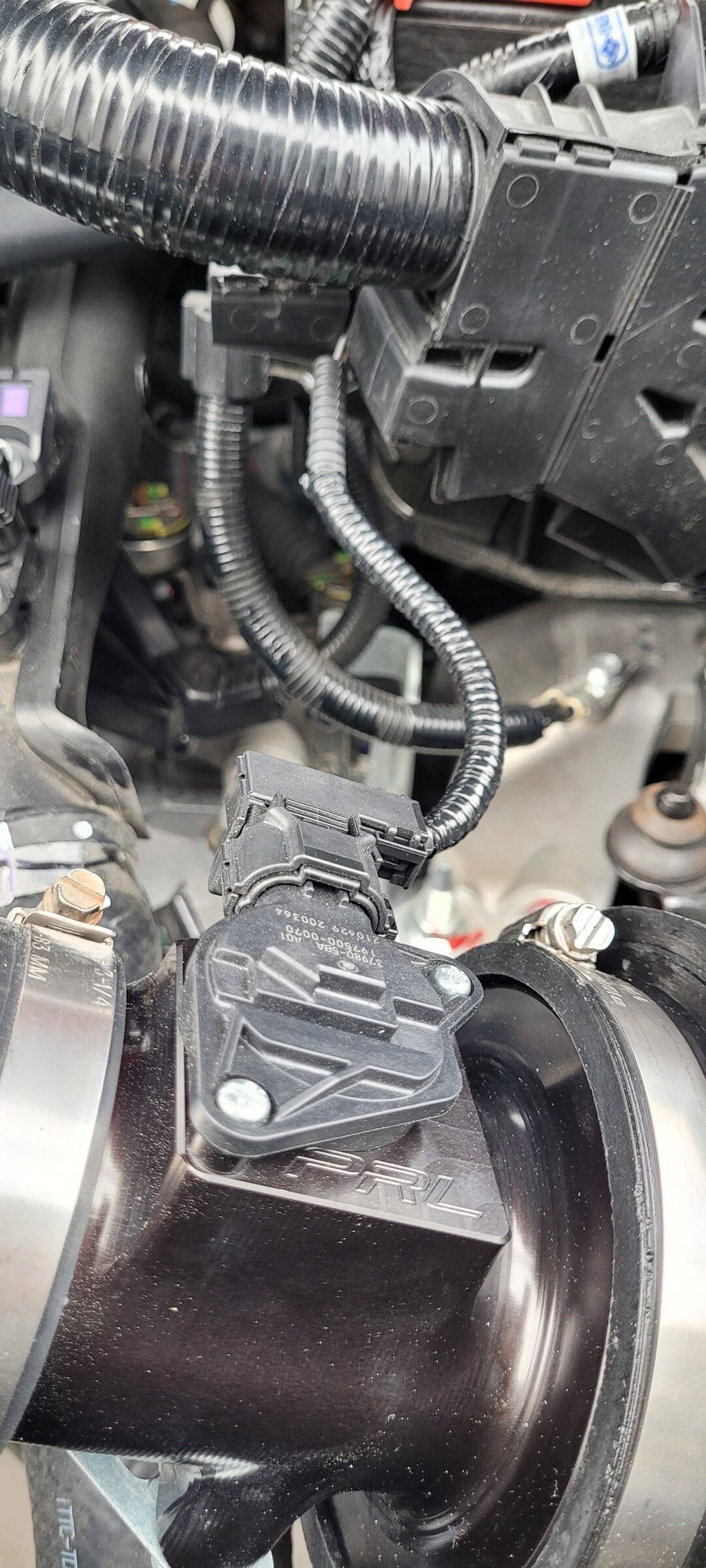

Maf sensors plugs right in... ***EDIT *** All 10th gen SI and all 11th gen 1.5T Motors runs the SAME MAF*** OEM PART # 37980-5BA-A01
No check engine and you can really hear the turbo spooling

I work in the parts department for Honda and 10th gen and 11th gen SI as the same Maf..
part # 37980-5BA-A01 ,so no problems...( i did all my research before installing it,just to be sure)
BTW All SI 17-20 and all 1.5T 2022 as the same maf...#37980-5BA-A01
