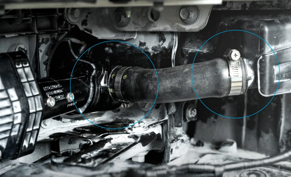

You could probably just remove the HVI box, but then you'd have nothing to support the filter and intake hose. Have you tried removing and plugging the resonator that's on the charge pipe? Should increase intake and turbo noises. PRL sells a kit for it, but I'm sure if you find a cap of the same size you can plug it and clamp it off without the kit.
https://prlmotorsports.com/products/2022-honda-civic-1-5t-intake-air-box-resonator-delete-plug
