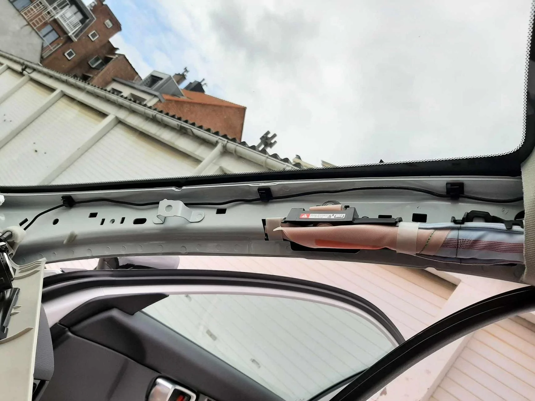

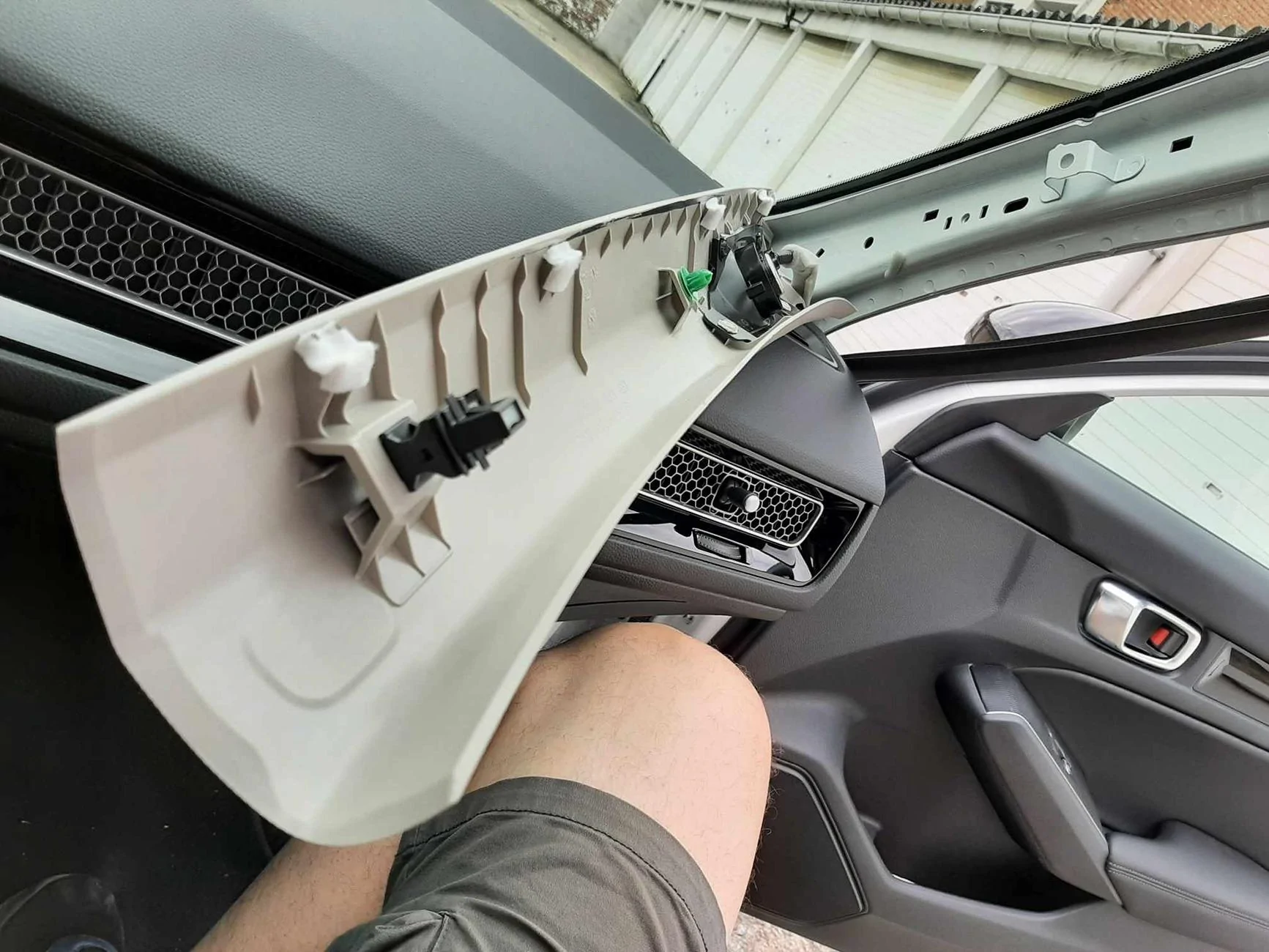

Some pictures of the install
If you want a correctly deploying side airbag, you gotta route the cable BEHIND the airbag, thats why you gotta remove the A pillar and do some cable management
11th Gen Honda Civic Dashcam install - BlackVue DR900S-2CH (front & rear) 453209700_10161412739834004_7989244426138046765_n
11th Gen Honda Civic Dashcam install - BlackVue DR900S-2CH (front & rear) 453234321_10161412739874004_7828280821792719245_n

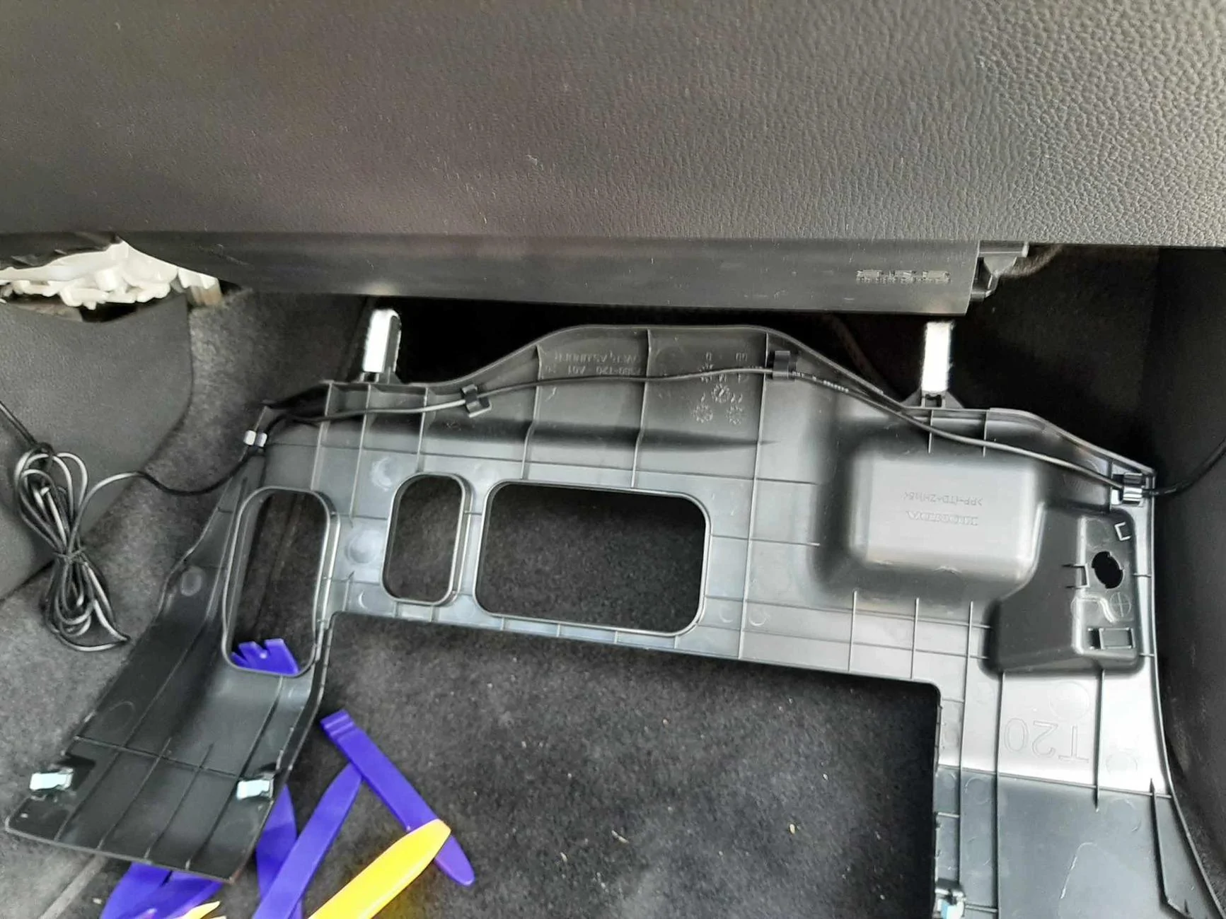

footwell area
11th Gen Honda Civic Dashcam install - BlackVue DR900S-2CH (front & rear) 453259309_10161412739884004_3385424435314422621_n

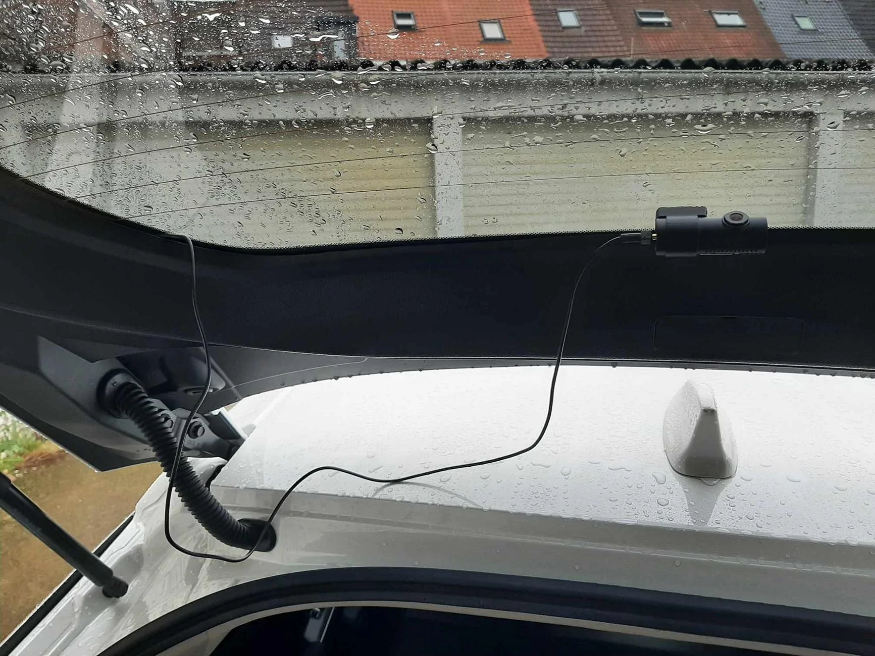

rear cam
11th Gen Honda Civic Dashcam install - BlackVue DR900S-2CH (front & rear) 453258211_10161412740049004_3064696357706445849_n
actually this video helped me to rout the cable for the rear thru the hatch....
