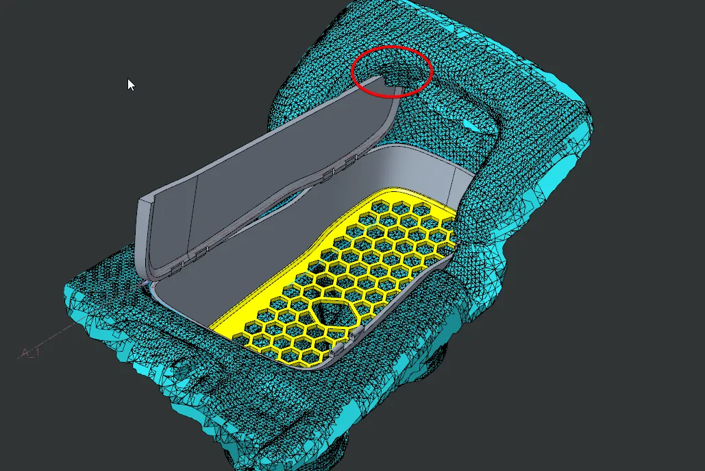

Hi all. I have had some hours to spend on this, and things have progressed. There has been quite a lot of thinking until this point, but I think that I like how it's looking:
11th Gen Honda Civic [DIY - 3D Print] FL5 Center console closed storage (WIP) xtop_EPH7drrBn4
11th Gen Honda Civic [DIY - 3D Print] FL5 Center console closed storage (WIP) xtop_9YhBvNi8TW
As you can see in the photo (last moment discovery), the lid opened 90º hits the armrest, so I guess that the box cannot have full-length doors. I think that without over-complicating it, that's the way to go.
Most of it should be 3D printed, only requiring a couple of springs to open both sides. This has still not been added to the 3D. Also, the locking mechanism is still missing.
I like the removable tray with the honeycomb pattern so that the light at the bottom of the cupholders can be seen.
I hope to make more progress next weekend and maybe even 3D print a prototype to check clearances, the chosen thicknesses, the difficulty of the print itself, ...

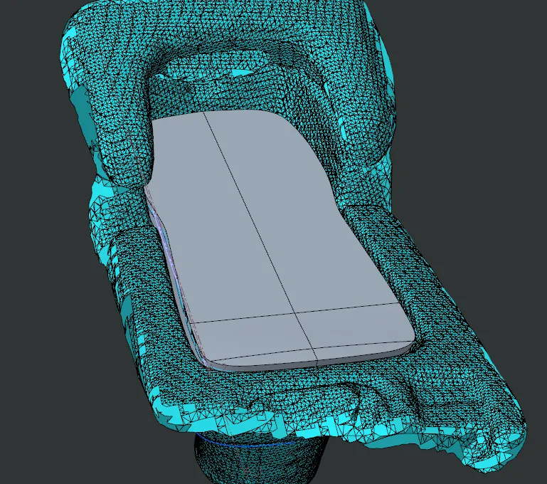

Hi everyone,
It's been a while since the last update—not quite what I intended, but life happens! (Plus, I spent most of my free time two weekends ago designing some 3D-printed vampire fangs for Halloween). Also, I haven't been driving the car as much lately, and there didn't seem to be tons of interest in this project initially (to my surprise), so yeah...
However, things have progressed nicely—especially this past weekend—and the CAD design is finally ready for the first test prints! I'll be doing a few separate prints: the first will focus on validating the locking mechanism and door sweep/opening kinetics, followed by a print of the main outer shell to check overall fitment inside the car.
For this V1 prototype, I designed a "push-to-unlock" mechanism that releases both doors simultaneously, while still allowing each door to be latched back down independently. The mechanism incorporates two 3D-printed springs. Everything in the assembly is 3D printable (using tailored tolerances for relative moving parts), except for the steel torsion springs that pop the doors open once the button is pressed.
I'm hoping to get the first physical test done later this week. I have high expectations, but being a perfectionist, we'll see how it goes!
I leave some screenshots below:
11th Gen Honda Civic [DIY - 3D Print] FL5 Center console closed storage (WIP) xtop_AyT22l1pwk
11th Gen Honda Civic [DIY - 3D Print] FL5 Center console closed storage (WIP) xtop_j2Lw49GLpC
11th Gen Honda Civic [DIY - 3D Print] FL5 Center console closed storage (WIP) xtop_kXMVYxq3eq
11th Gen Honda Civic [DIY - 3D Print] FL5 Center console closed storage (WIP) xtop_dvImhuY5oU
If you have any doubts or comments, feel free. Regards!

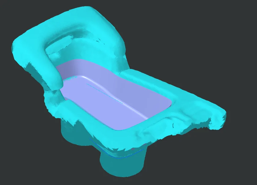

This is purely subjective, but what led you to having those angled edges near where the doors were previously clipping versus a smooth round edge? I think smooth edges would match the design of the interior more
I really don't get the spot you're referring to, sorry.
aqf23
aqf23
Alvaro
Oct 19, 2025
42
Basque Country, Spain
FL5 CW
This section:
Thanks for the suggestion; I will try it. I was going to make a straight line but discovered that I could make the doors bigger in the center without hitting the armrest walls. Then I did not pay more attention to that area; I'm no designer but an engineer 😂

To my surprise, the shape of the cut has not been an easy modification; I've found "ugly" things while doing it, and because of the hinge I cannot avoid the "S" shape. @Cueyo do you like this better?
Oh wow, yeah for sure! Looks way better
