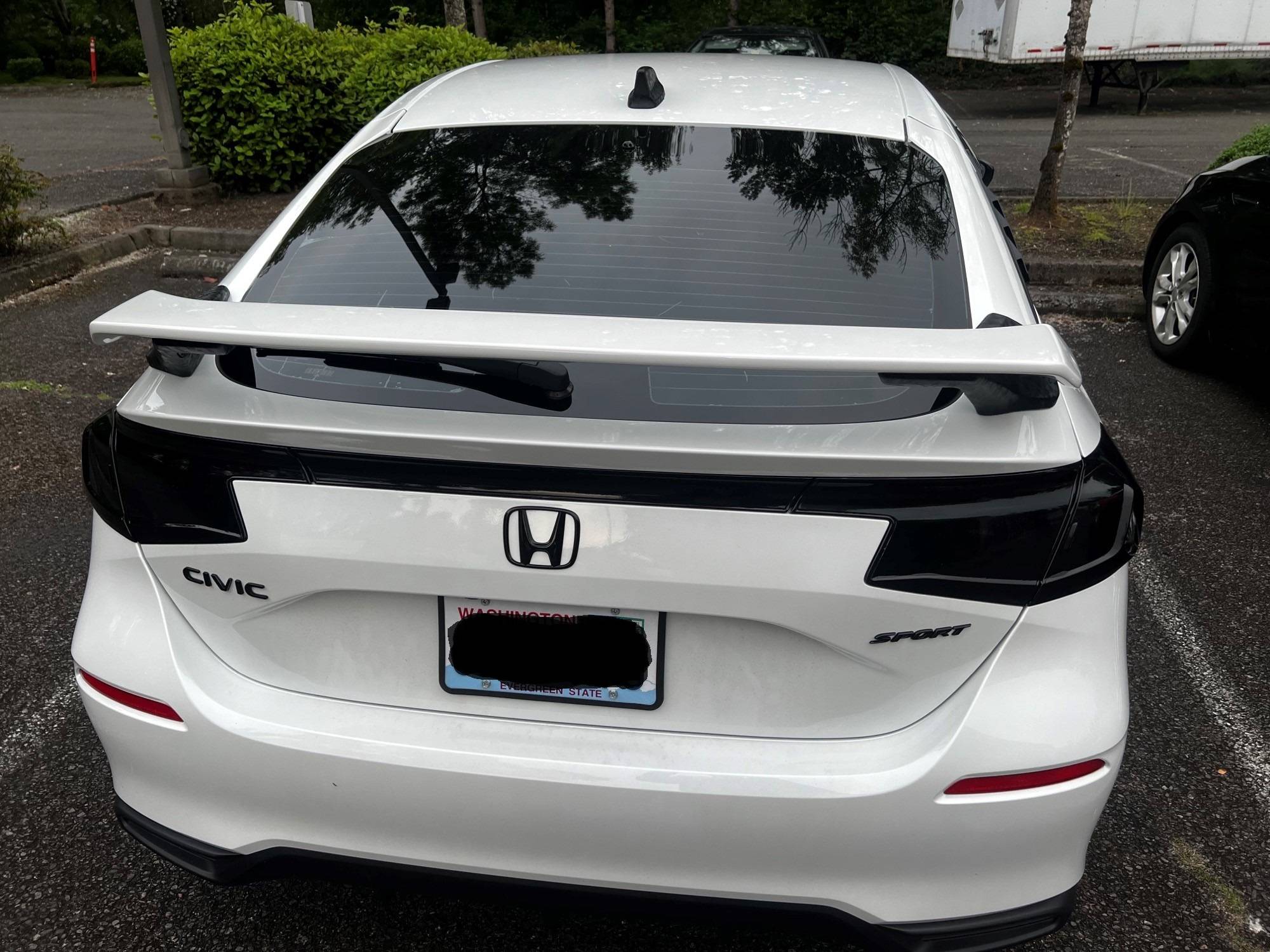

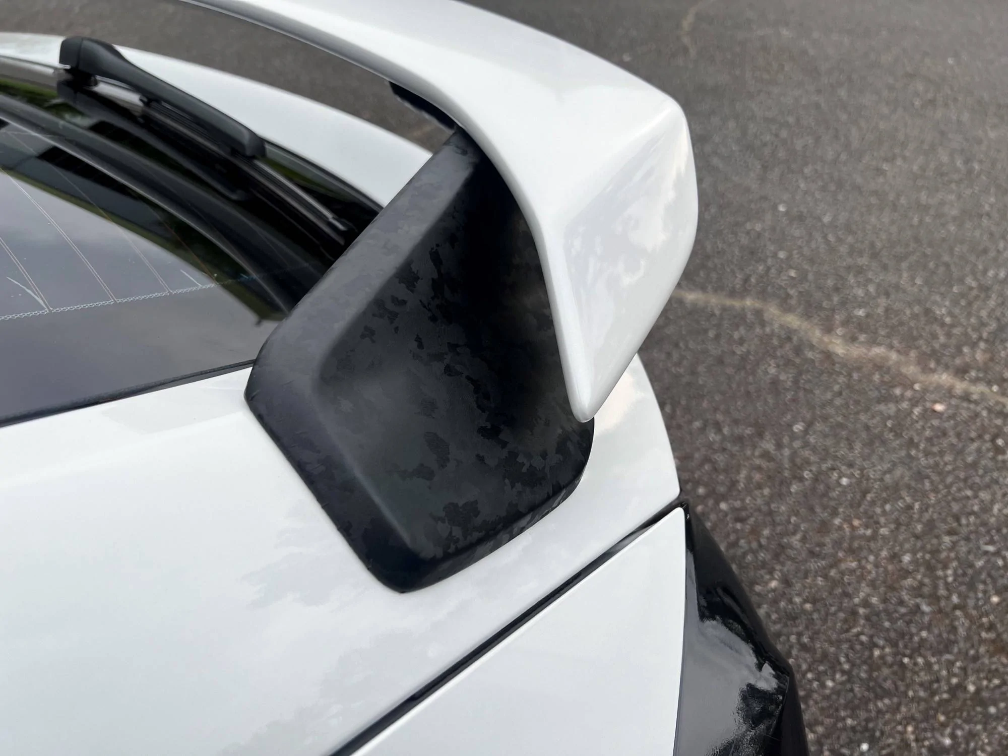

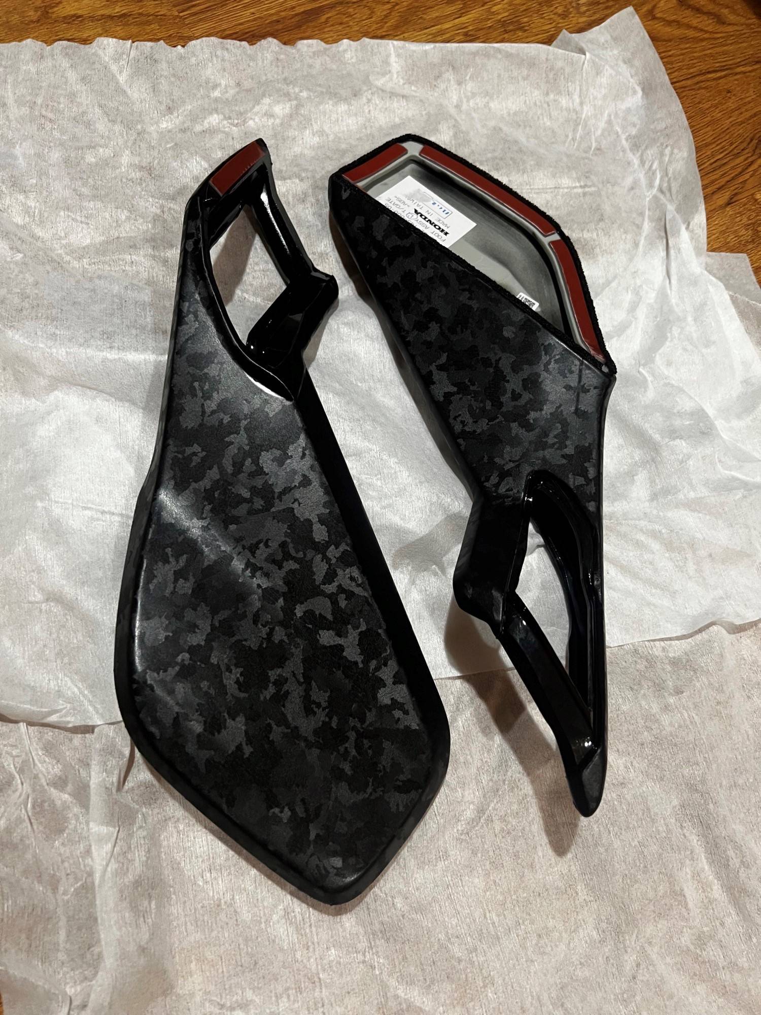

Spoiler Installed. Wish I had better pics but here's what I do have. I did vinyl wrap the arms (HPD Stickers are very stretchy but came off pretty easily).
