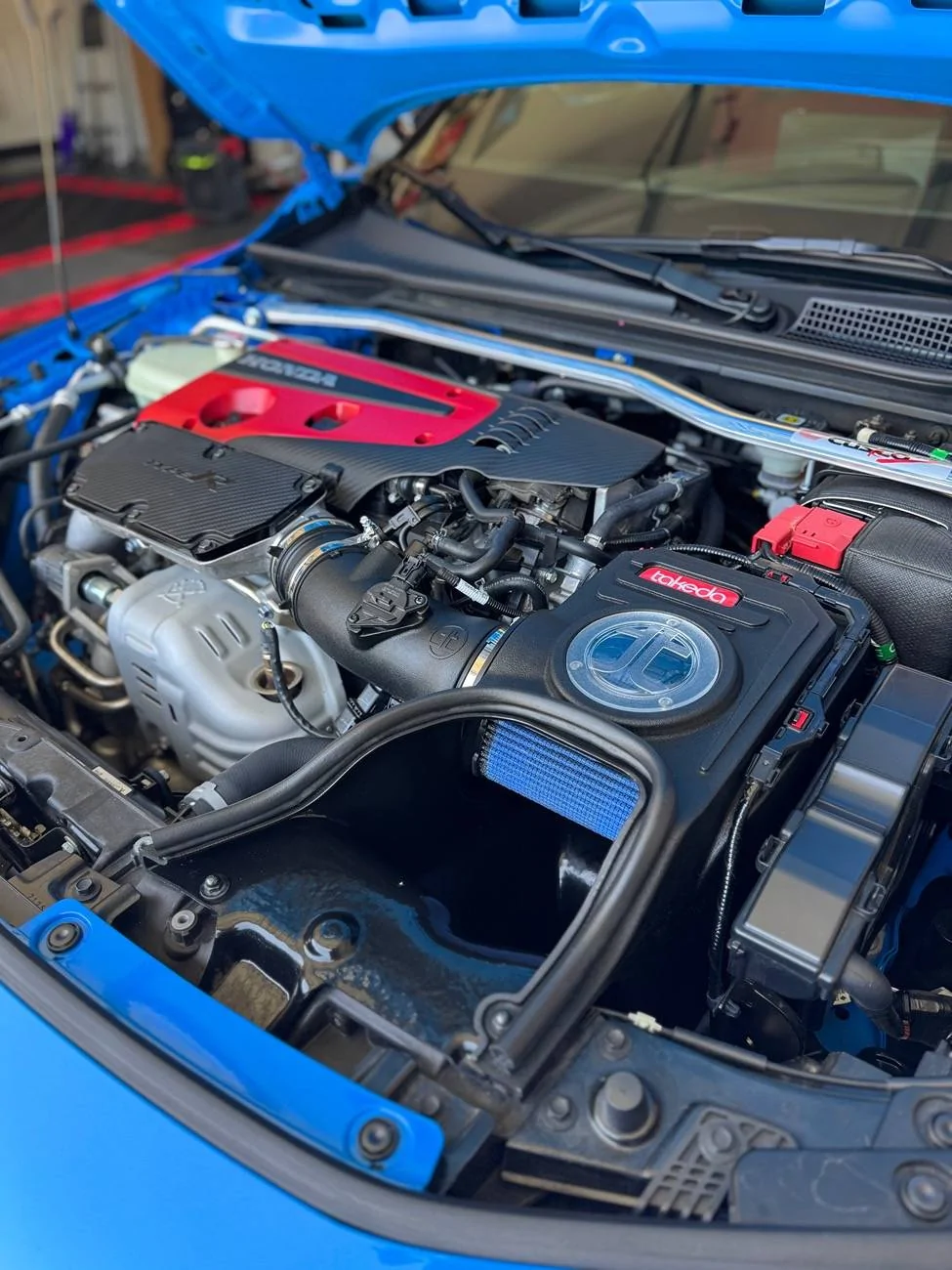

I have revised version of the Takeda Intake, no issues so far and has been great

Love the look and simplicity of this intake. But when I had it and ran datalogs, fuel trims would be slightly positive and commanded AFR was noticeably more lean at WOT compared to OEM and PRL HVI. Not sure if it will cause any issues, but I don't want to be running leaner than OEM especially at high rpm and load. If you check yours, I'll be curious to see the results.
