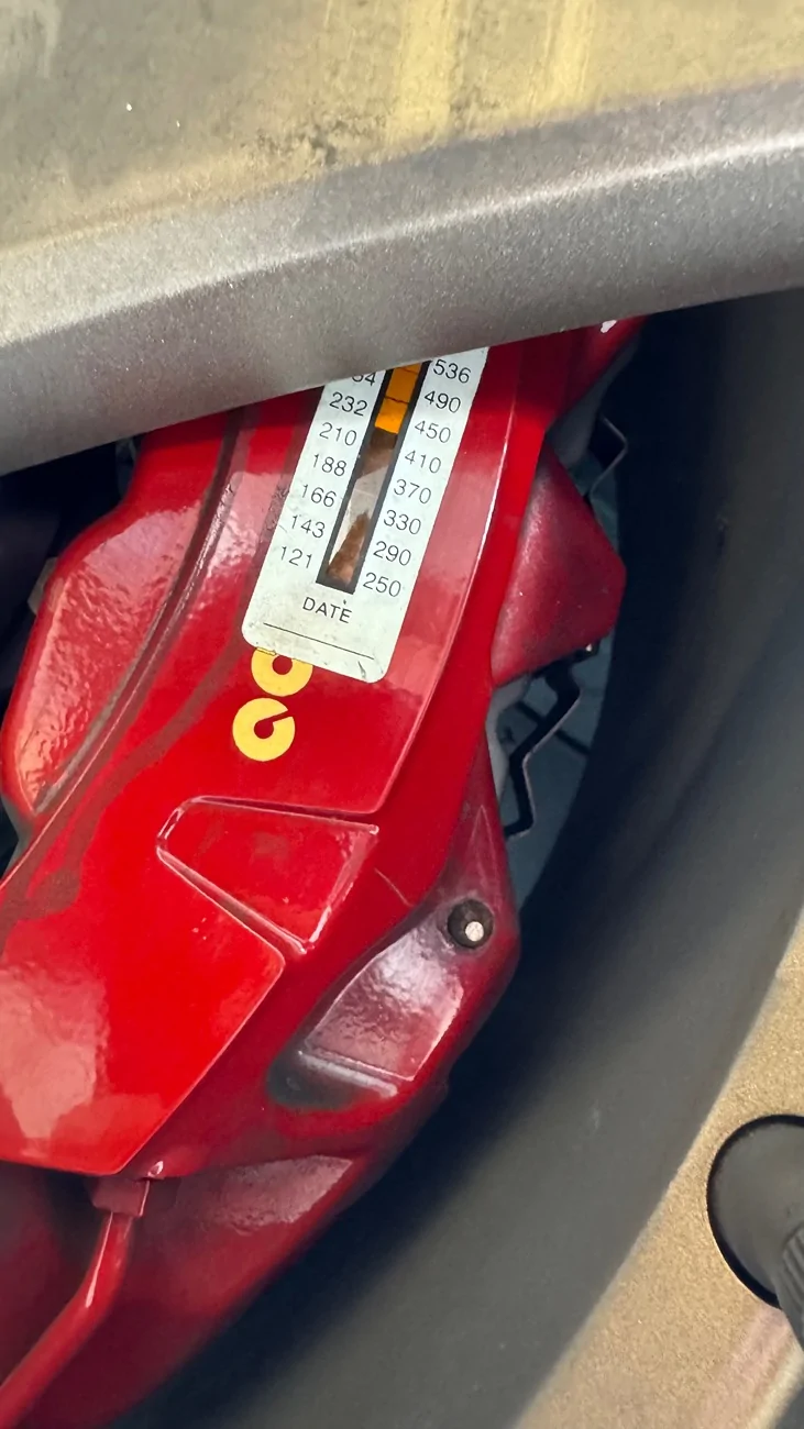

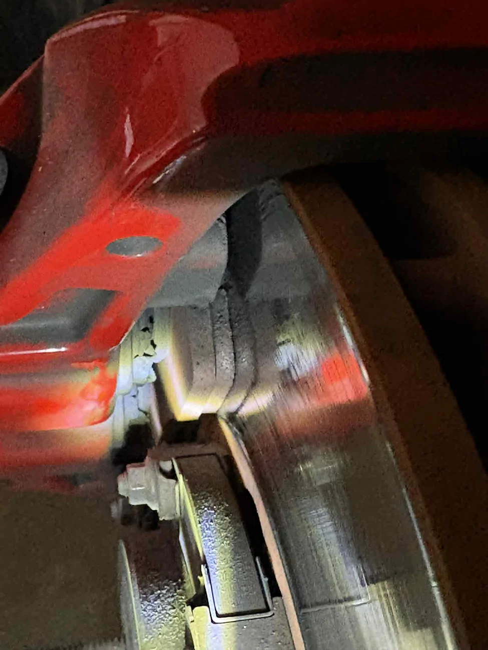

noob question... so if I want to replace the dust boot, is it as simple as remove the old boot and put on new ones?
It's pretty straightforward when I did it. It's easier to change them when the pistons are sticking out. Use a pick to pry out the old dust boots, then slip on the new dust boots. I removed the rotor and bolted the caliper back on so that I can work on removing the old boots and installing the new ones. Removing the caliper completely is not necessary.
