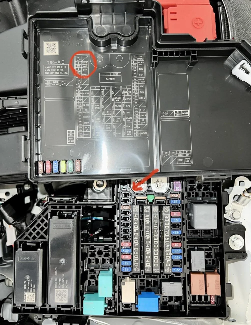

Hey all,
my ac is not working (FL5). It has never worked since new. Opened engine bay glovebox to find no fuse in EVP slot. Thought this might be it (haven’t tested yet) but just noticed in tophers active exhaust fuse pull post that his is the exact same.
any thoughts on whether this fuse is needed?

That fuse is missing on my car too. My AC works fine. You’d better take it to the dealership to be repaired.

Which of the relays is for the condenser/fan?

It discusses this in page 800 of owners manual. EVP fuse is not in US versions of the FL5, along with a few others denoted with the asterisk on the diagram.
Thank you. Now I just gotta figure out which relay is for the ac clutch so I can test before scheduling dealership.

Page 803 in the manual says AC fuse is #43 in the interior fuse box under dash.
Thanks good sir. Any chance you know which of the relays in the array above is the AC Clutch Relay? I want to test swap that before I take it in to dealership
