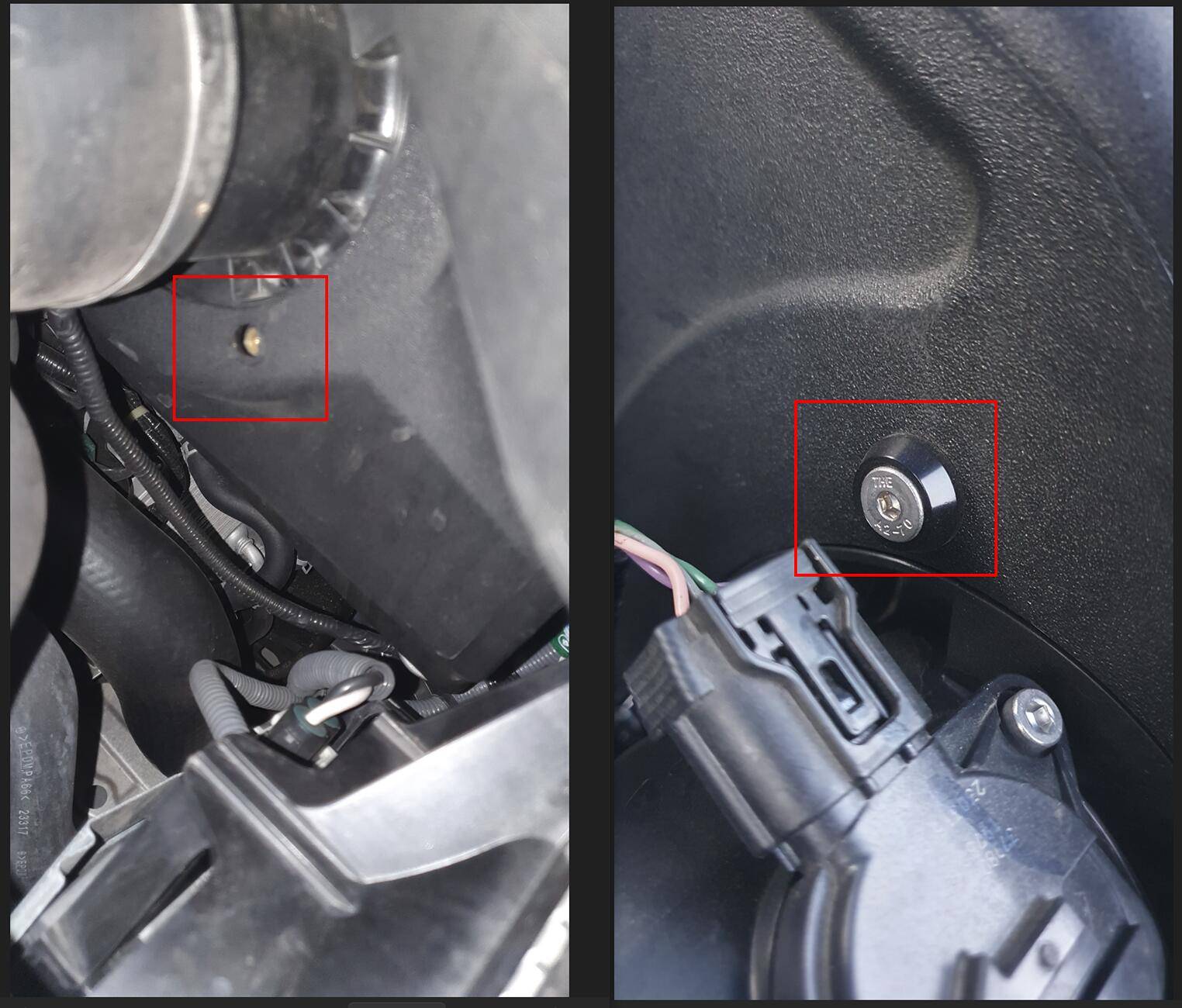

I've seen a few threads around here and on reddit where folks are missing screws after a while. I don't think the thread locking compound that came pre-filled on these screws are enough. I added some locktite-blue during my install and have been safe so far.
I check every time I open the hood.

The correct screw specs are M5x0.80x16mm. We made the bolts longer. The issue with the 12mm is that the threads did not go deep enough to get the loctite to bite in the threads.

The change was made early Sept 2024. We released the TSB in October, but by then we were putting the new bolts in the kits. Older stock may have the original bolts, so it never hurts to check. The torque spec was also incorrect, making it easier for the original bolts to back out. The TSB is below. DM me your email, & I will get you a free invoice for the updated kit just to be safe.
We are working on updating install guides, product descriptions, & photos across our site, so this will all be fixed.
