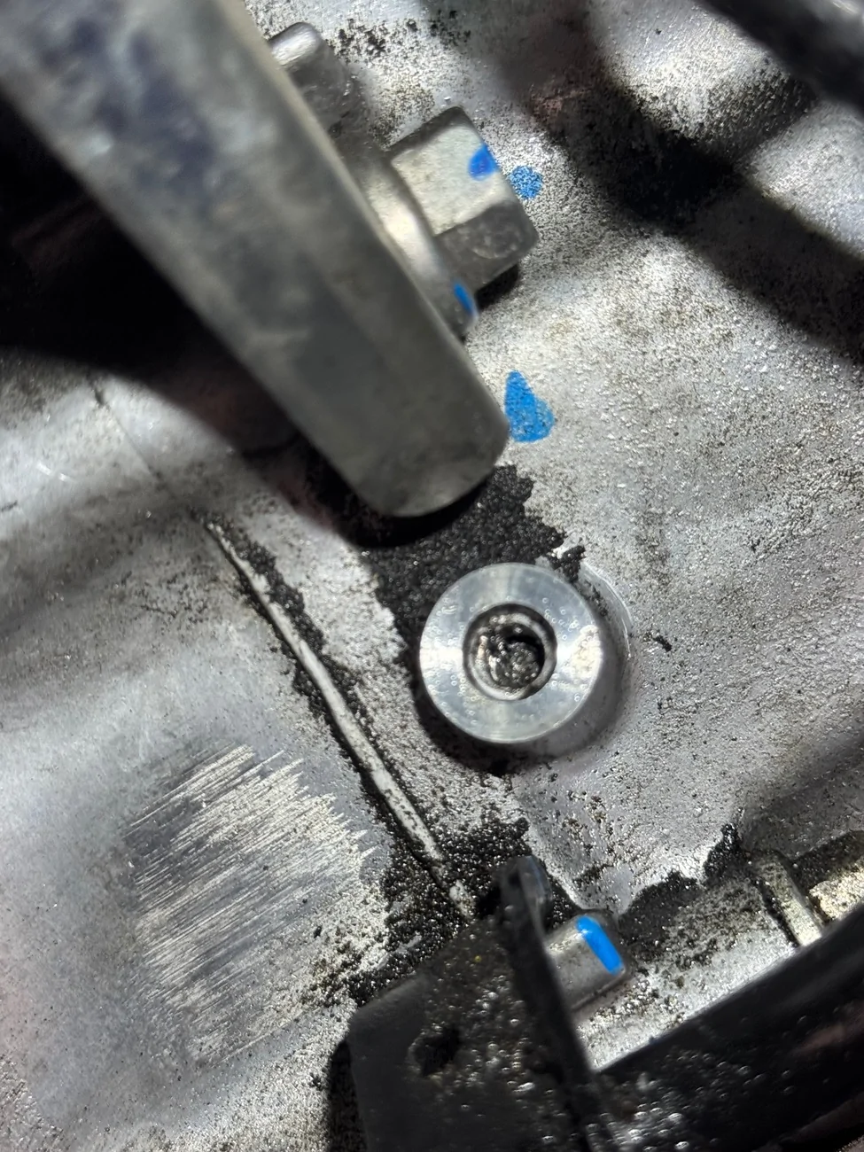

y’all I swear to you I was being so so so gentle. I think part of the issue was that the washer was really soft so it just… kept going. Also if I say I torque spec something I am implying “torquing to manufacturer specifications with a torque wrench in the proper range.” Anyway yeah no one do what I do lol

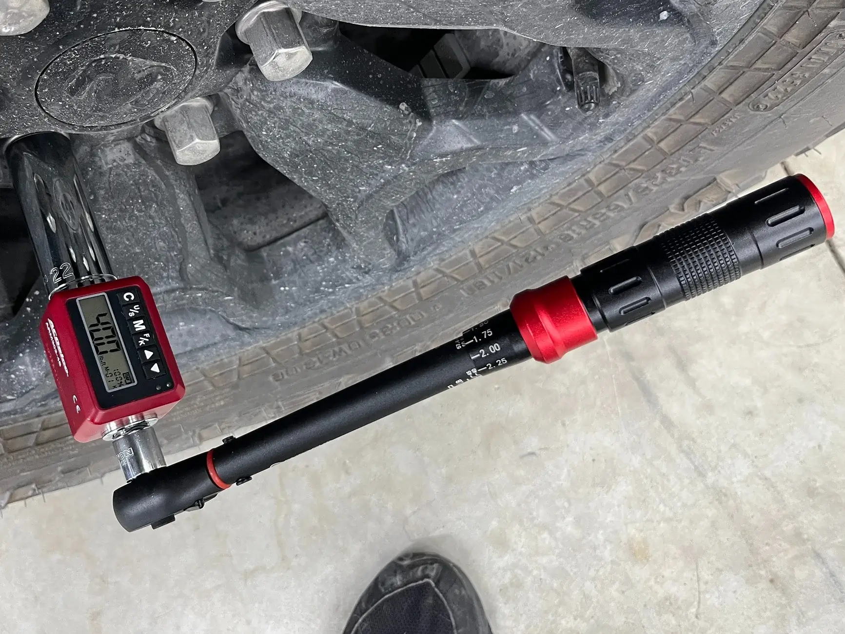

It might not be that he used the wrong torque value but the first 20% on torque screws is not very accurate.
a bolt requires that low nm needs a 1/4 torque wrench where that torque value is probably middle of the range.
glad you got it out op!
this is basically what i said lol
Jan 8, 2026
47
26
Hondas
Use 1/4 tools for M6 fasteners.
Not 3/8".
It snapped because you used a 3/8" tool.

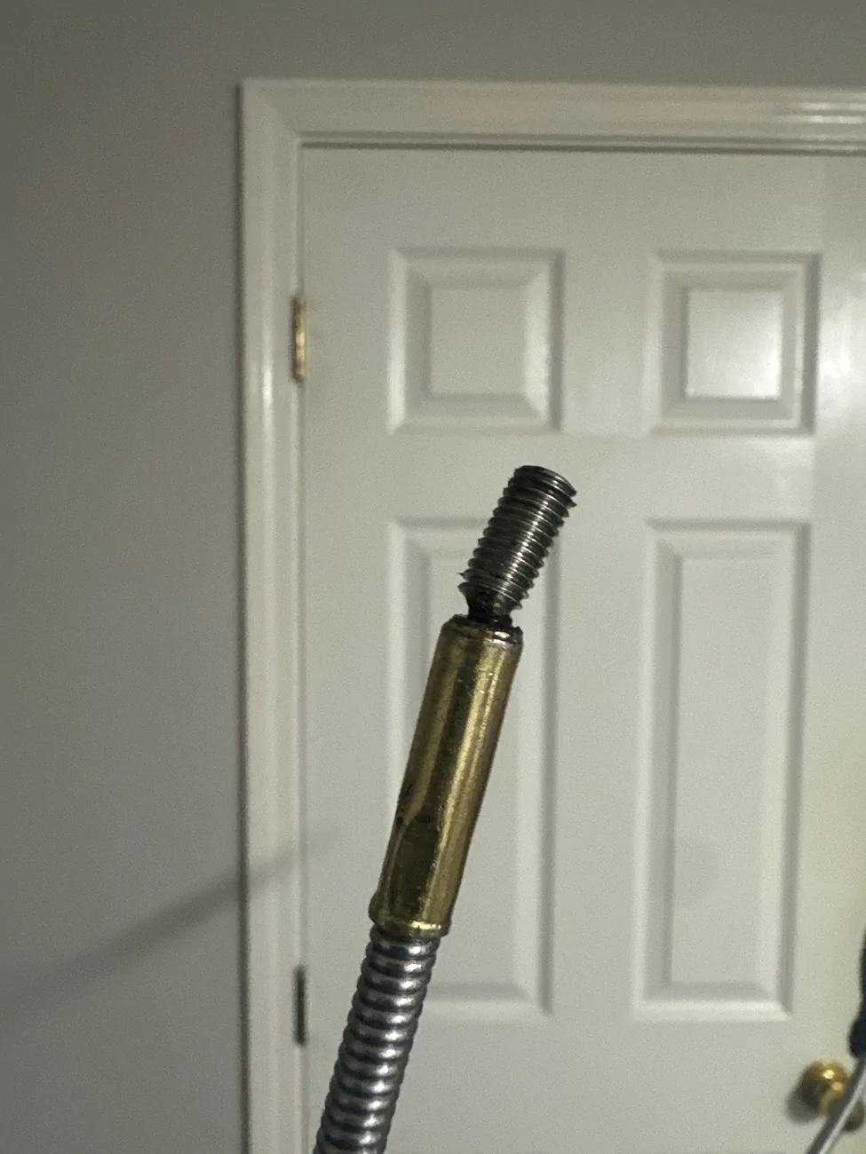

Update: I GOT IT!!! 4 hours in the freezing rain but it’s out. I used a scope to get a feel for where it may have fallen and then I just fished around with the magnet. Huge thanks to everyone telling me the torque spec of this bolt after I had already said I was torque speccing it. That was very helpful in helping me get this out…
i was thinking it was a non-magnetic bolt but glad it worked out for you!
