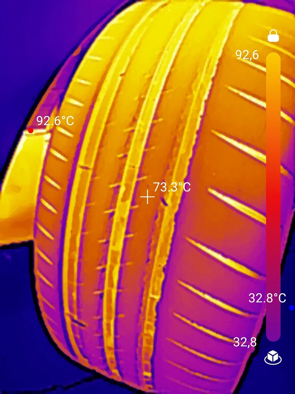

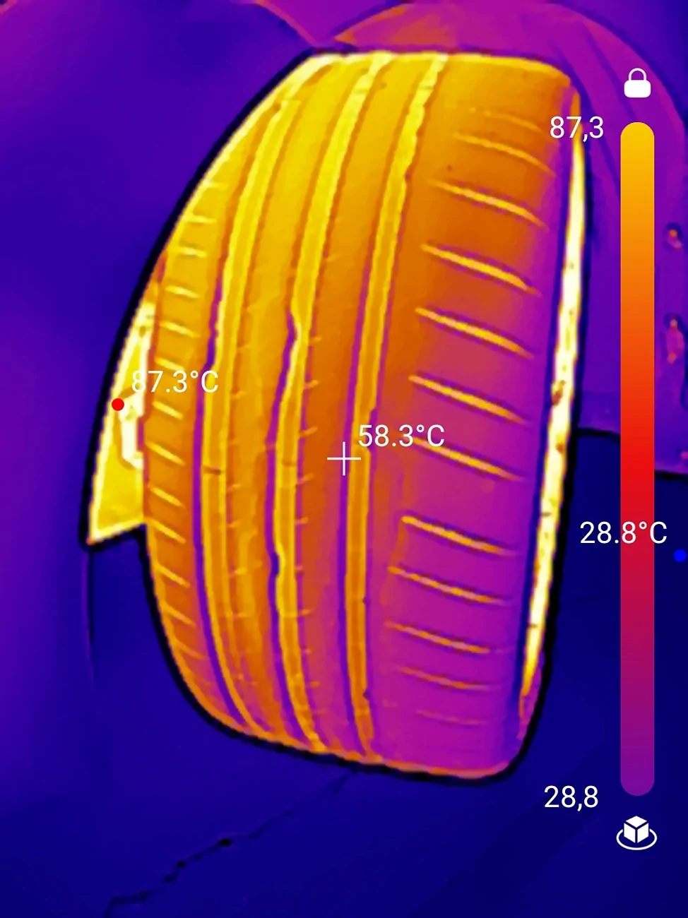

Note: this is an uncalibrated consumer thermal camera measuring surface temperature, so treat the absolute values as a rough reference only. What I'm relying on is the difference between zones and between tyres, taken with the same camera, method and timing. Front tyres, second session (approx.):
  • FL: inner ~88 °C / centre ~73 °C / outer ~72 °C
  • FR: inner ~81 °C / centre ~71 °C / outer ~67 °C
So the centre was not the hottest zone, but the inner shoulder ran 15–20 °C hotter than the outer on both sides, and FL ran about 5 °C hotter than FR overall.

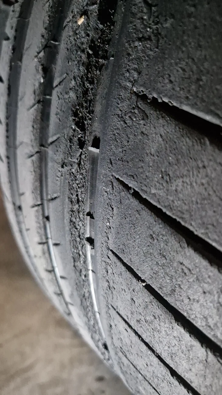

Result: wear is much milder than last time, but I can still see the same pattern starting: the rib next to the inner groove (the softer, wet-oriented compound on the Cup 2) is cleaner and more worn than the rest, and it looks a bit more pronounced on the FL.
