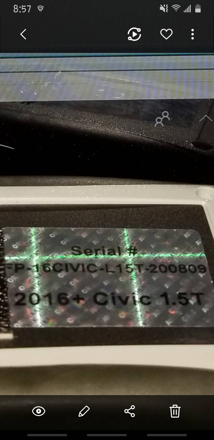

Please give us serial numbers.
Serial number: 200433 need help too. I get dtc code p0234 after 5k on wot. And goes limp mode. And after update and reflash it just dont get boost and runs like on limp mode with no engine lights
