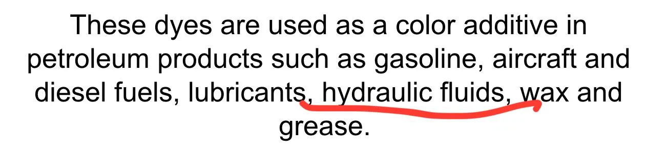

Dumb question. My car only has 3500 miles. How can I tell when old fluid has fully flushed out and new fluid is only in lines if both are “clear”? Can I add a coloring of some sort? Missing the ATE blue days. Lol
Found this dye some have used to detect leaks in their brake lines. I’ll call them tomorrow to see what they say.
https://rekhaoil.com/product/rekhaoil-liquid-petroleum-dyes/
