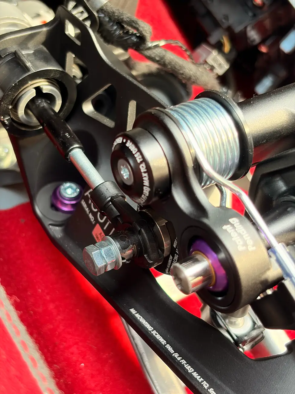

Today while installing an Acuity shifter, I accidentally broke part of the gate cable rod end while fighting with retaining clip.
11th Gen Honda Civic Gate Cable Rod End Plastic Piece Broken - Any Replacement? tempImageWtwm6o
My question is:
Can this plastic piece be replaced or is there a fix ?
I’ve searched quite a bit but couldn’t find a clear solution or a replacement part.
Has anyone experienced this before or knows of a fix (OEM or aftermarket)?
Thanks in advance for any help.

That’s tough man. Pretty sure you can’t buy that piece alone. You would have to buy all new cables.
Part - 54310-T60-A01
Alternatively you could probably get away with some safety wire or see if you can use JB Plastic weld

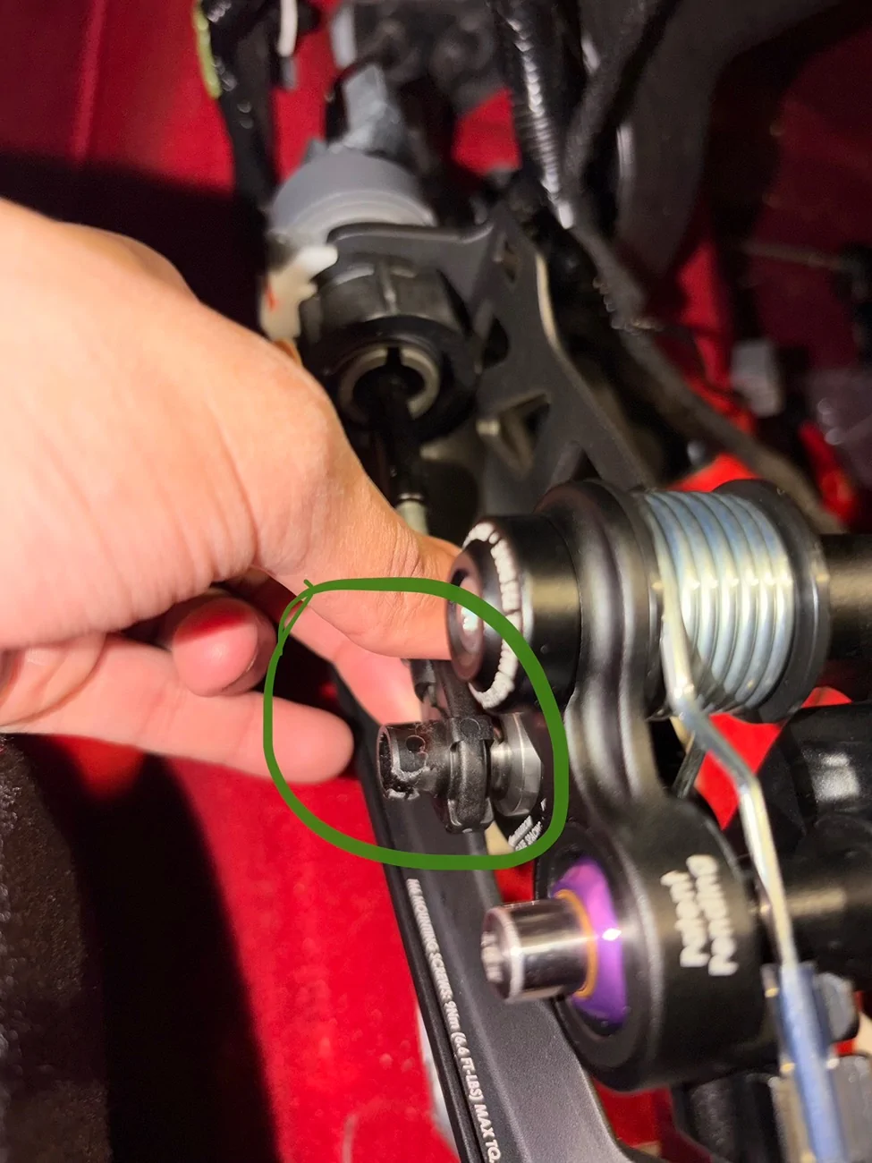

There is a place for a bolt on the acuity shifter, so I believe there might be a way to fix this, but I need to find a plastic piece to cover the broken part and secure it over it using a bolt
what do you think ?

Might want to run some safety wire into that recessed part just to keep it positioned correctly.
Maybe reach out to acuity? I know they did a ton of r&d for this platforms shifter and maybe they ran into this issue before.

Yes, I did think about using safety wire, but I’m not sure if it might cause more damage. I’ve contacted Acuity and I’m waiting for their response. Thank you for your help.
