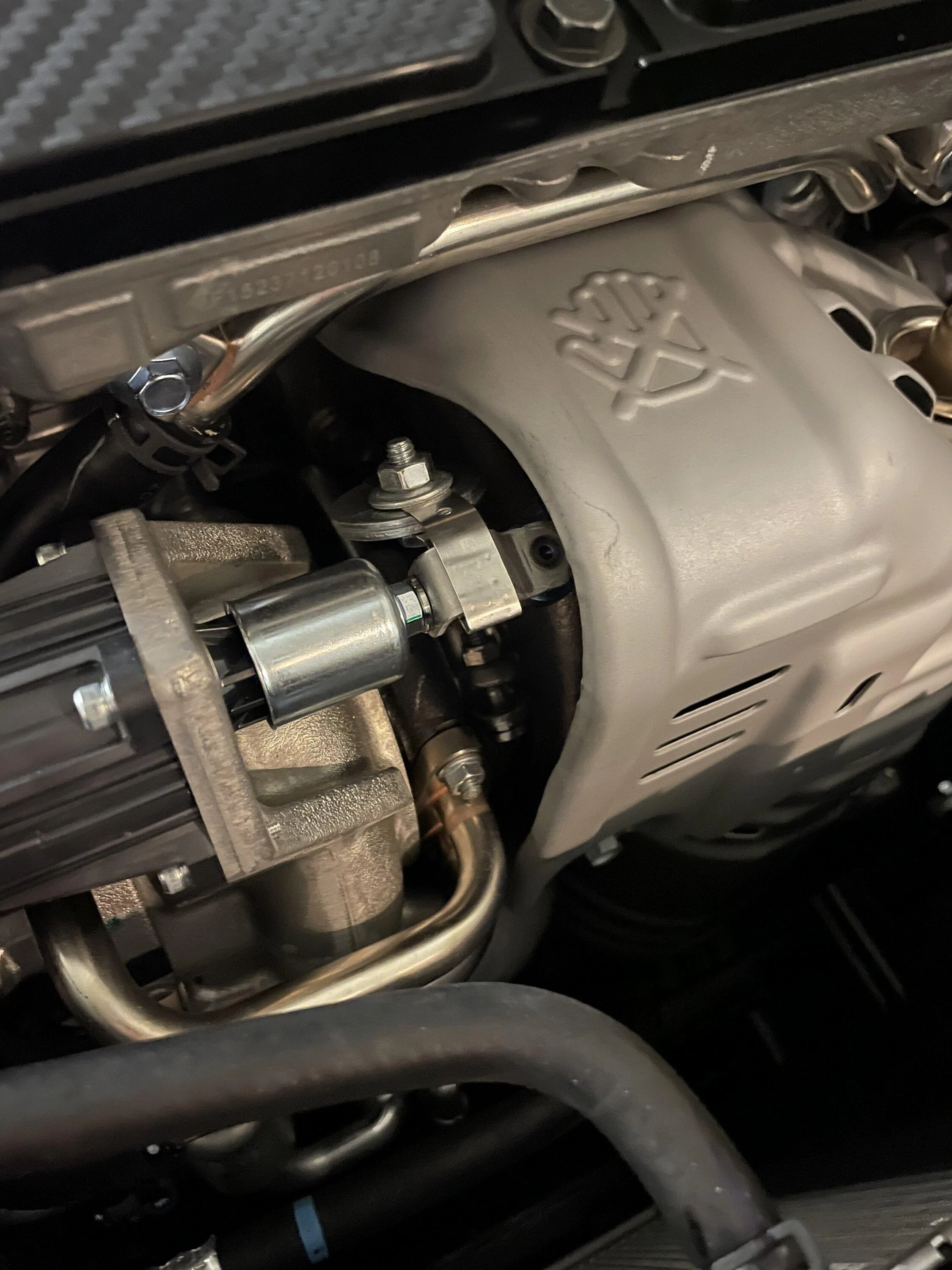

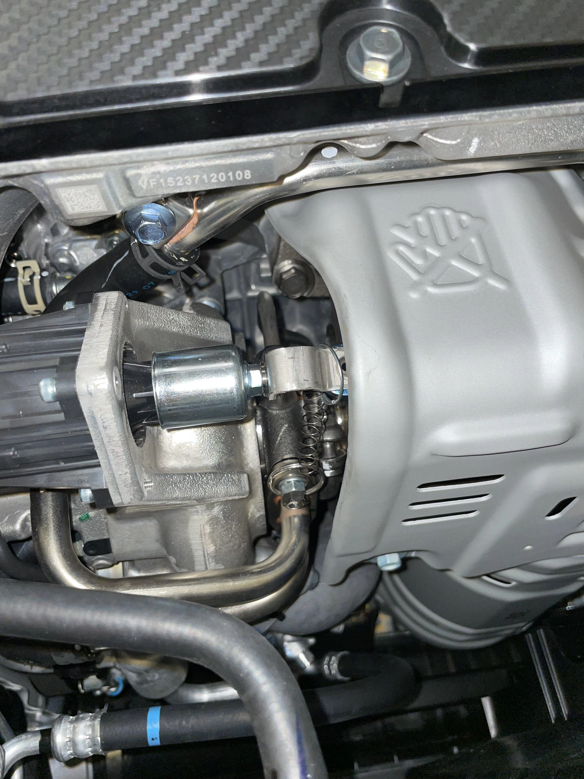

Just got my car this week and read about this the week before. Last night it occurred to me to listen for it. Put my windows down and I about laughed out loud when I heard it.
I tried 2 different fixes and neither helped much. First was a weight, made it deeper in tone but still there. Second was spring. Seemed to take the edge off but still there. I can live with it :dunno: but yeah it’s bonkers. Could maybe try a beefier spring, that’s all I had laying around.

Just my thoughts, but when you're trying to mechanically manipulate something that's super red hot metal, you don't have a lot of choice of connection methods from the actuator to the wastegate. Any kind of rubber or plastic that would normally provide a soft and quiet mechanical connection is out, it would burn up at those temps. You end up with a metal on metal connection that needs some play or else there's too much friction. The parts end up being intentionally loose and can vibrate.
The spring idea is a good one but it would increase the wear of the connection since you're putting pressure on it.

Yeah absolutely, anything in that spot has to be very high temp resistant. The spring fix would be perfect if it worked. I found another spring that was about at the limit of how stiff I was comfortable going considering I don't know the exact stroke it has to handle. It was a more clear improvement but the rattle is still there. I'm gonna yank that jank as soon as it cools down and live with it, lol
I get your point about wear but I bet it would be better off under spring pressure than left rattling. Loose metal on metal + high frequency vibration = disintegration. Anyhow probably negligible either way.
