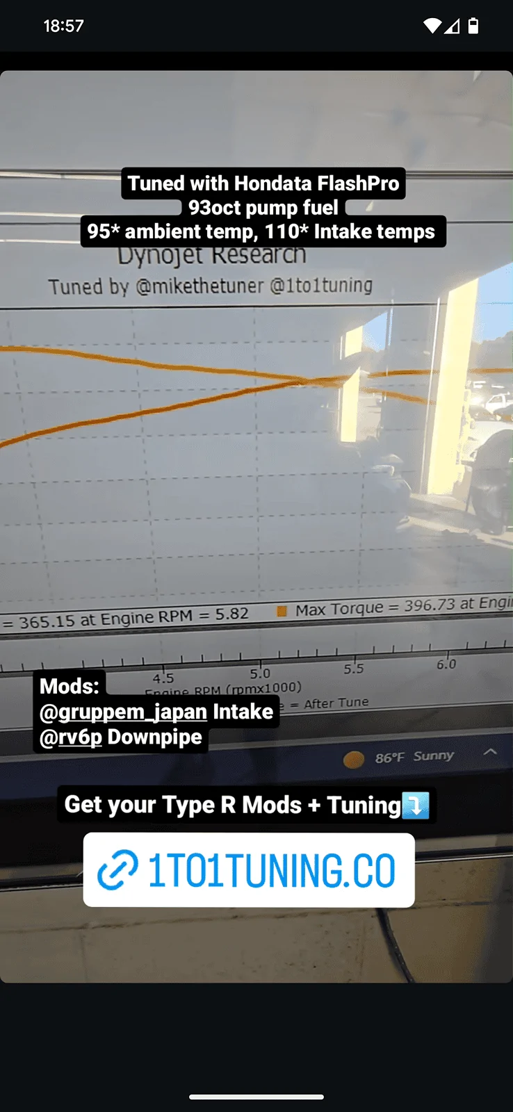

Tuned it finally. Not bad for hot weather. 365whp 396wtq
11th Gen Honda Civic Gruppe M Intake finally installed on my FL5 Screenshot_20240624-185704

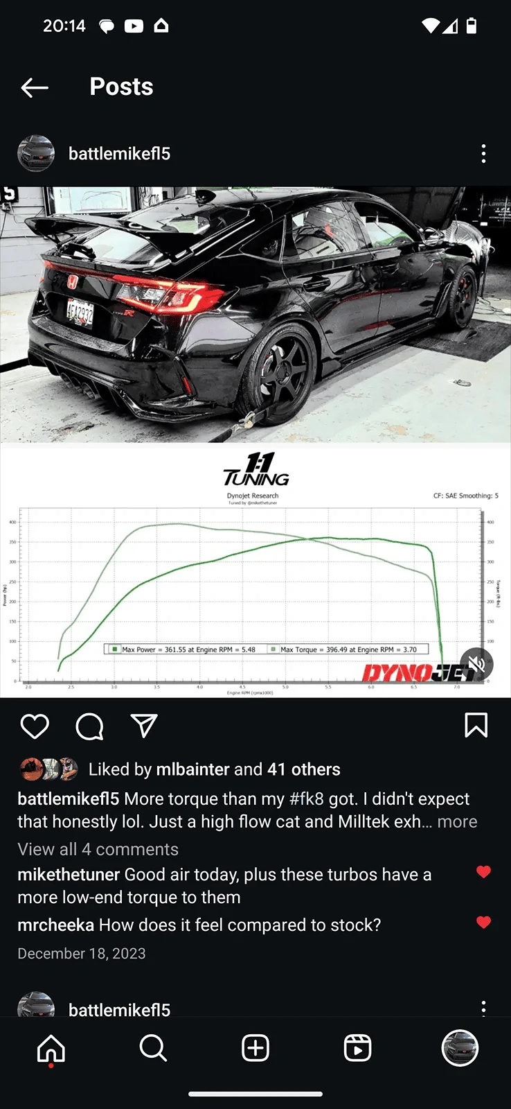

For reference back in winter with 45~ temps and factory intake
11th Gen Honda Civic Gruppe M Intake finally installed on my FL5 Screenshot_20240624-201449
