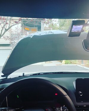

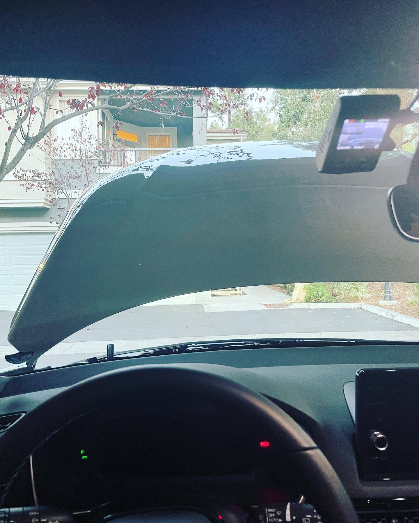

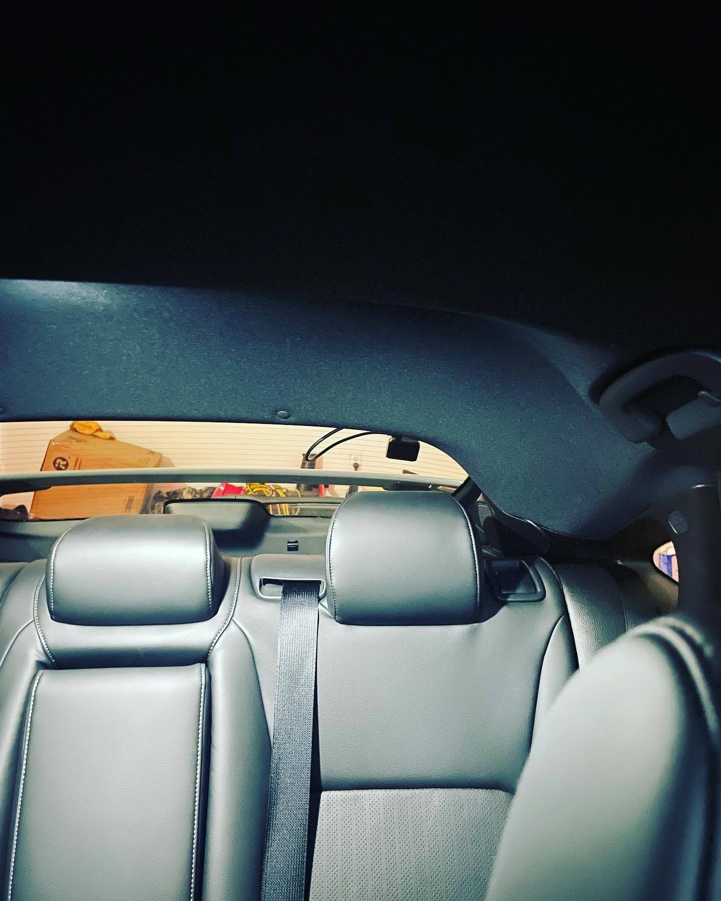

Hey guys so it went well for me. I ordered a hard wiring kit for my street guardian dash cam. Wired it into the number one 20A fuse, grounded it and everything is good to go. Hardest part was routing and hiding the wires
