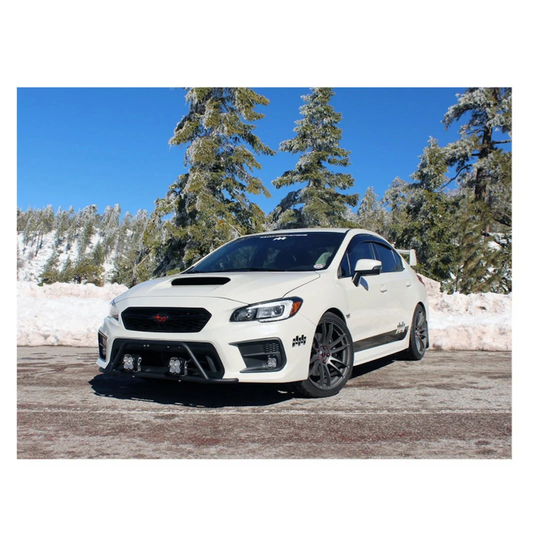

I was thinking of running some aux lights behind the grill in front of the intercooler I haven’t looked yet if there’s any mounting points etc, just an idea for now kind of along the lines of the picture below
11th Gen Honda Civic Has anyone added Auxiliary lights? IMG_1240
