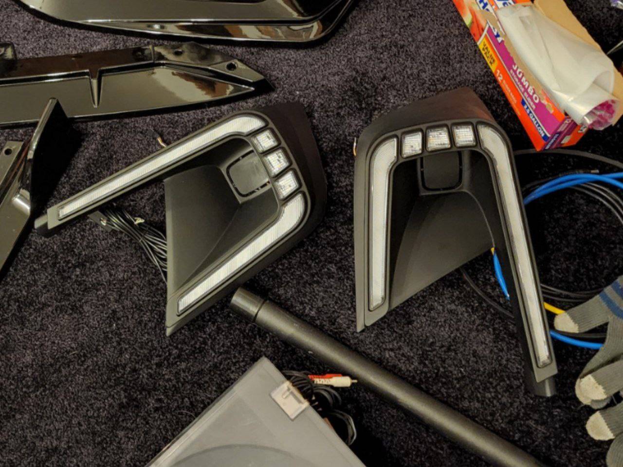

First and foremost, I would like to say these DO NOT natively fit the sport-touring trim. The Touring has parking sensors built into these parts. The aftermarket LED trims, do not. There for it is NOT plug and play without modifications.

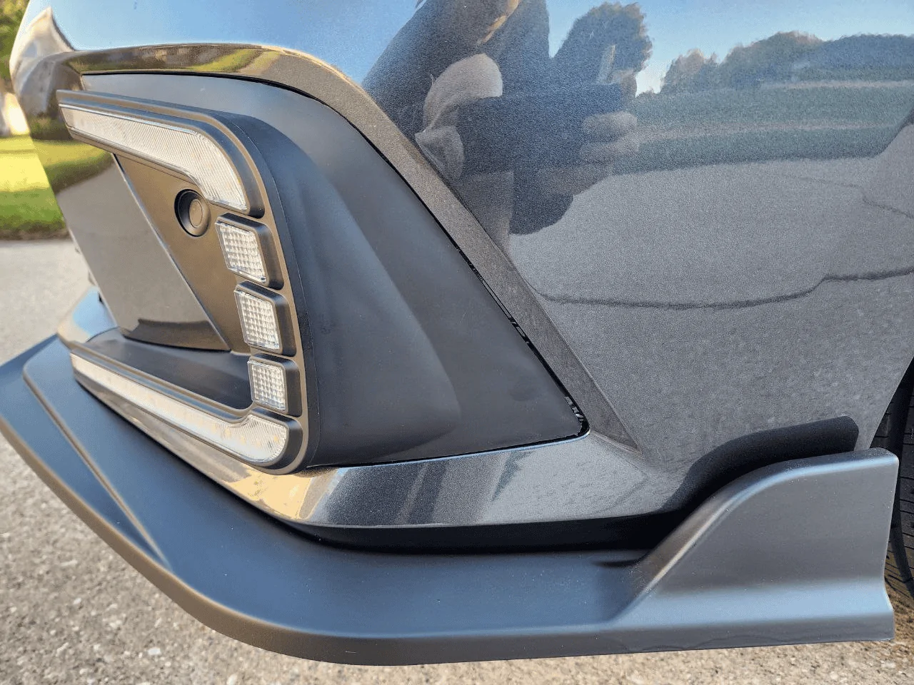

11th Gen Honda Civic Hatchback Touring DRL Trim LEDs Stock

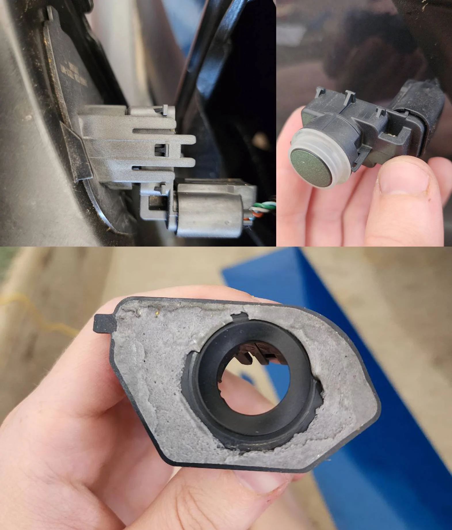

That all said, Lets begin. First off, I wanted to take a peak at what I'm dealing with. I wouldn't really entitle myself a "Car person" I'm a computer geek and CNC fanatic. I didn't want to take the bumper off to get to these, so I used shim-stock and prybars to aid at removal, to see how these things work. After popping the unit out, I was finally able to see the back side of the parking sensor. The unit itself is held on via 2 clips. This simply pops out revealing the sensor. The plastic part it connects to, is literally double-sided taped on. This is nothing more than a curved thin piece of plastic. It in no way "clips" onto anything, Tape only.
11th Gen Honda Civic Hatchback Touring DRL Trim LEDs Combined

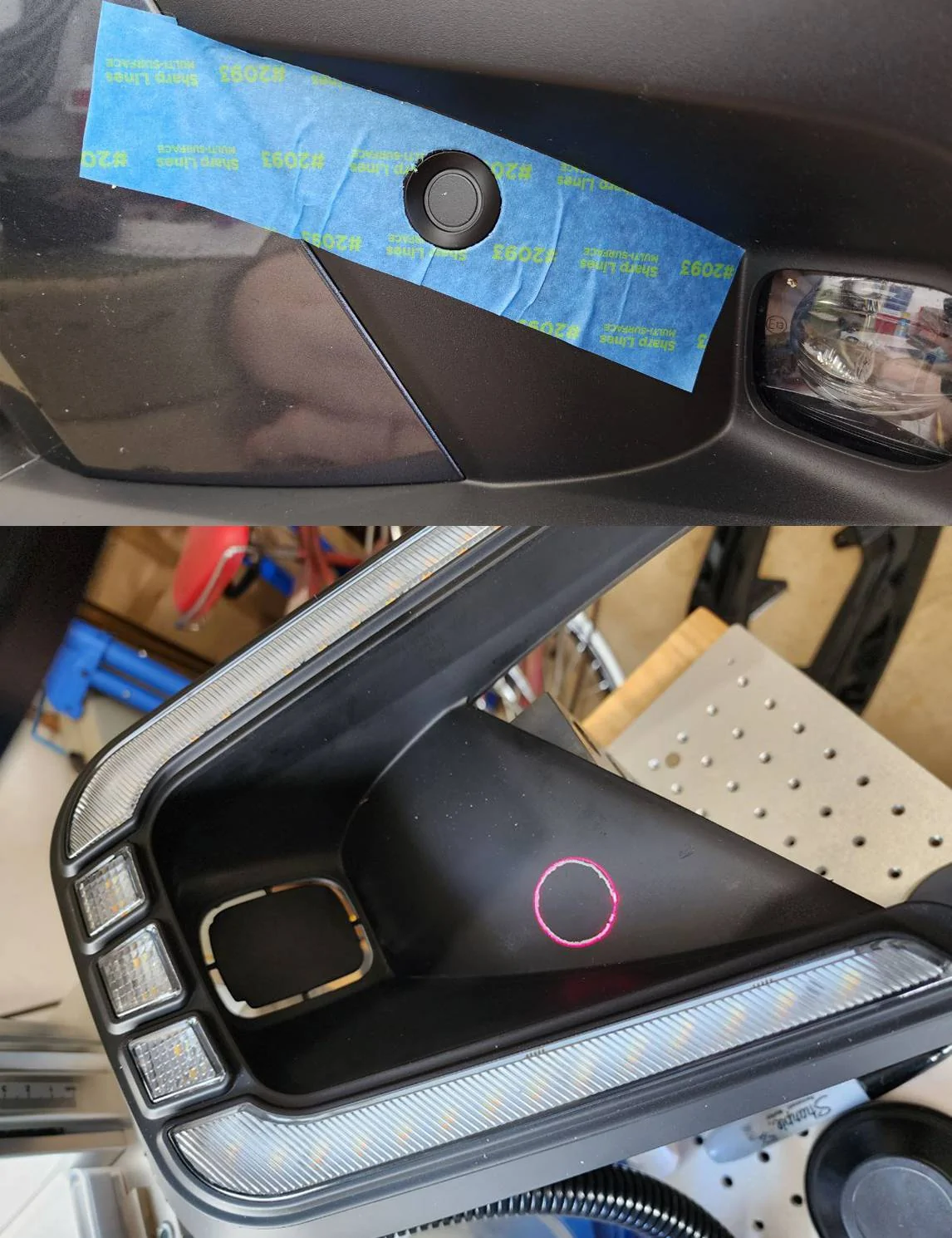

So, the spot for the sensor is literally nothing more than a roughly 28mm diameter hole with a chamfer around it. The backside is much the same. Nothing to it.
11th Gen Honda Civic Hatchback Touring DRL Trim LEDs photo_2022-09-10_15-28-41 (2)

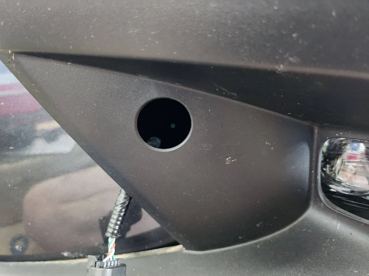

So, now knowing what I'm dealing with, I decided to mod the aftermarket parts. I used painters tape to follow the contour, top edge of the trim. Something that I know I could use as a reference and repeat it fairly well. It was easy to see the indent of the sensor, to cut it out in the tape. Simply placed it on the aftermarket part and roughed the circle shape with a sharpie marker. From there because I was too lazy to figure out how I'm going to drill a 28mm perfect hole in a curved surface, my easiest solution was to just shove it into the laser etcher and buzz a quick 28mm circle. Laser light follows the contour so..couldn't be any simpler.

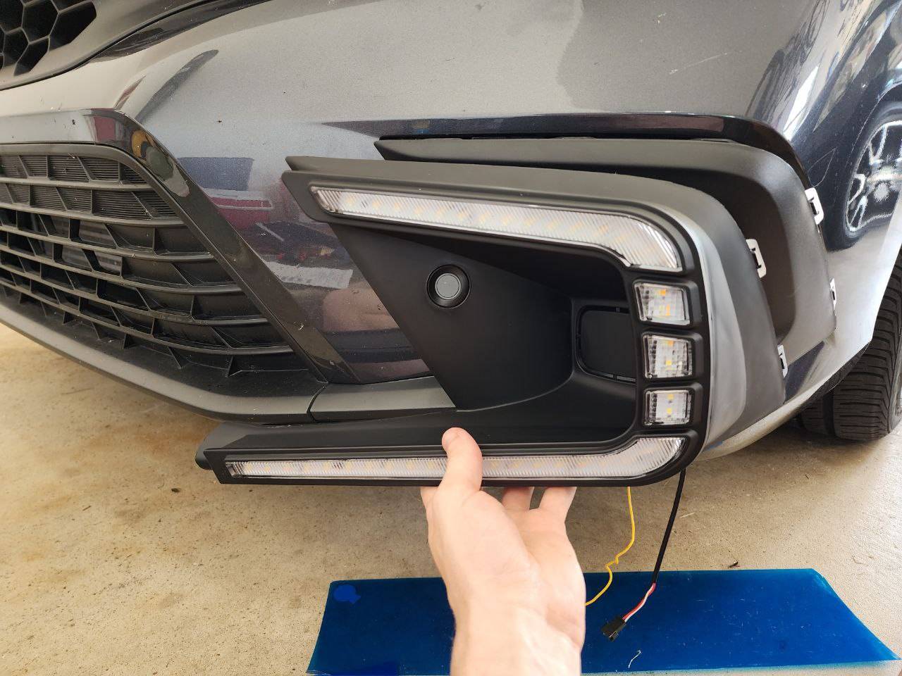

11th Gen Honda Civic Hatchback Touring DRL Trim LEDs Transfer
The end result is a parking sensor installed onto the aftermarket parts a test fit. Aside the fact my hole is sharp-edge and not chamfer, it looks pretty identical to the stock sensor installment. Honestly couldn't be happier with how overly easy it was, as I've seen some pretty crazy ways these sensors mount. Thank you Honda for just plowing a sensor onto a flat-plate with double sided tape hahaha.
11th Gen Honda Civic Hatchback Touring DRL Trim LEDs photo_2022-09-10_16-12-12
And yeah! Like said, this isn't installed yet. This was prep for installment and I got farther than expected, as I didn't plan for it to be so easy. I half assumed I was going to be doing 3D printed parts and buying spare sensors...NOPE! Got my oil change next week & after some talks with the dealership, I'm going to finally rip that bumper off and properly install them and cable-manage. I honestly don't use the parking sensors. Never have I needed to park right on top of someone's bumper or right against a wall. Even then, It's not hard to just sit up higher and see the scoop of my hood and know where I'm at. Gotta keep the car's system happy though. Pretty excited to get these running. Just thought I'd share my findings and post pictures incase anyone else is looking to do similar and goes "Wait...I have parking sensors..dang-it!" When the answer is -- That's fine. Use a step drill or something and do your best to mark a 27-28mm hole and you'll be 100% fine.

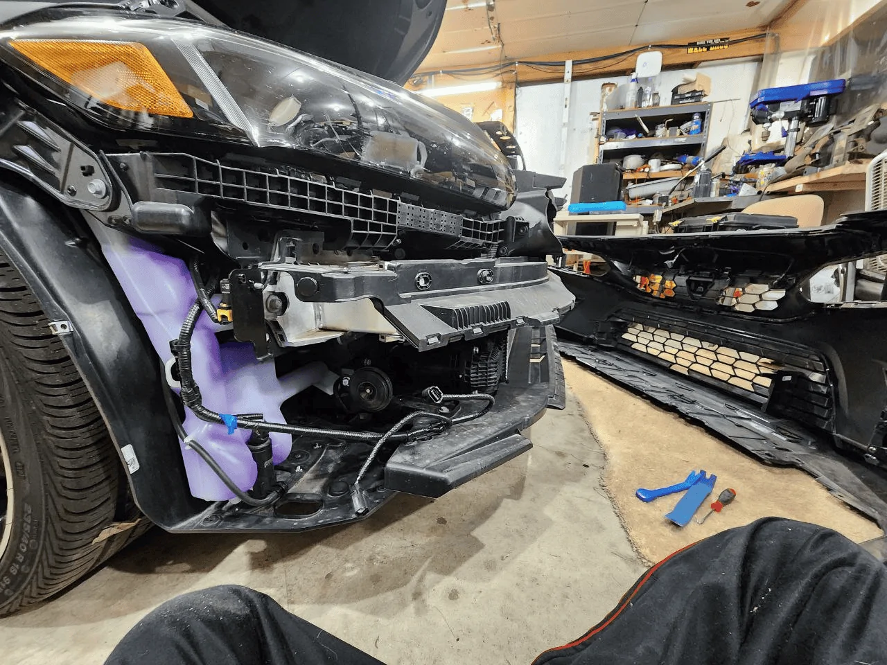

Whelp! Finally got around to doing the install. Installation requires taking the bumper off ( sorta ). In theory you could leave the bumper on and use shim-stock to undo the clips like I origionally did. The problem is, wiring would be blind fishing. So, I just opted to remove the bumper. Didn't take too long. This is all "First time doing any of this" for me, and I managed to get things off pretty quick and easy. Was a little surprised how simple it was.
11th Gen Honda Civic Hatchback Touring DRL Trim LEDs 1664688428139
This allowed me to easily run the wiring. Right now I kinda just did it temp. Just to get a feel where stuff is going, as I plan to undo the bumper again in the near future to fix one of the metal rivots I forgot to repair. Seen under the purple washer fluid tank. The dealer told me "It will cost $160 to fix that because you need to replace the entire fender liner" Reality,No reason I cant just push the stupid thing back in and bend the tabs down. Cost -- Free.
Anywhom! I didn't take any photos of the wiring yet since as said, I may not even use the stock harness the came with the kit. There's no reason to have the two units connected together to a T joint. Makes more sense to wire Left-Side to Left Headlight. Right side to Right headlight.
My only complaint is "Typical aftermarket fit" Although the two clips ARE indeed clipped and secured, there's a gap. Next time I have things off to re-do the wiring, I'm going to put more time into seeing why this is. Hoping its just hitting the foglight lens and a little sading could fix that. I'm sure its fixable. Minor details.

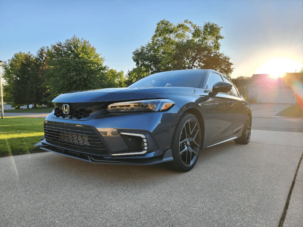

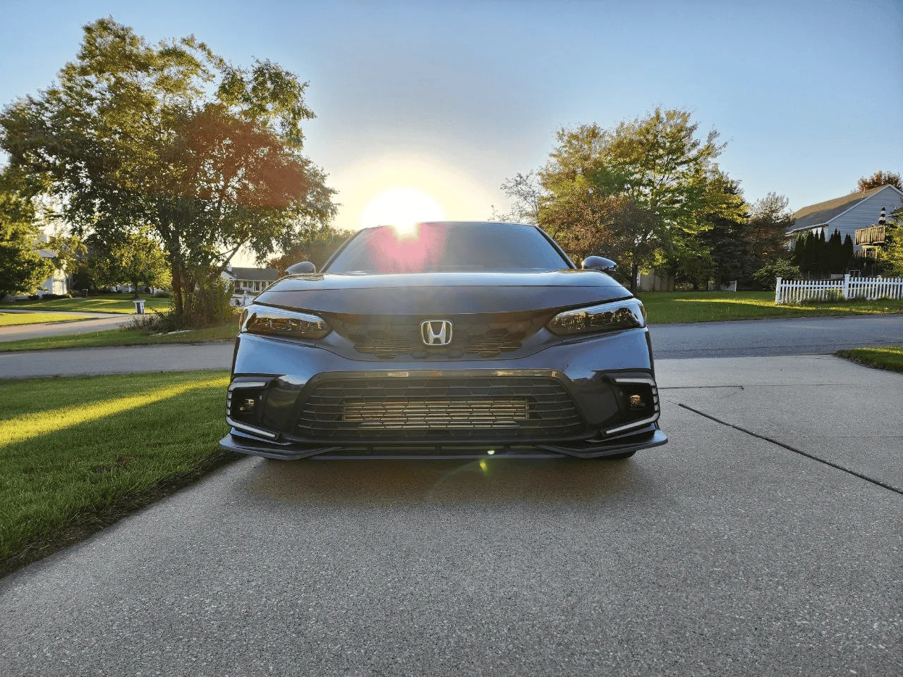

Regaurdless, they're on and the parking sensors are in. I just have to tap into the headlight connector. Waiting to get some waterproof connectors in the mail. So until then, they're not connected yet. Even unpowered, in my limited unbias opinion, I think they're a nice addition to the looks of the car. That area always felt so un-finished to me. I really wish the stock had LED trims. Pretty happy! The torn-off adhesive for the parking sensors is nearly unusable. So I kinda bodged them on with glue for now, but still sent out an email to a few places to try to get OEM replacement mounts.

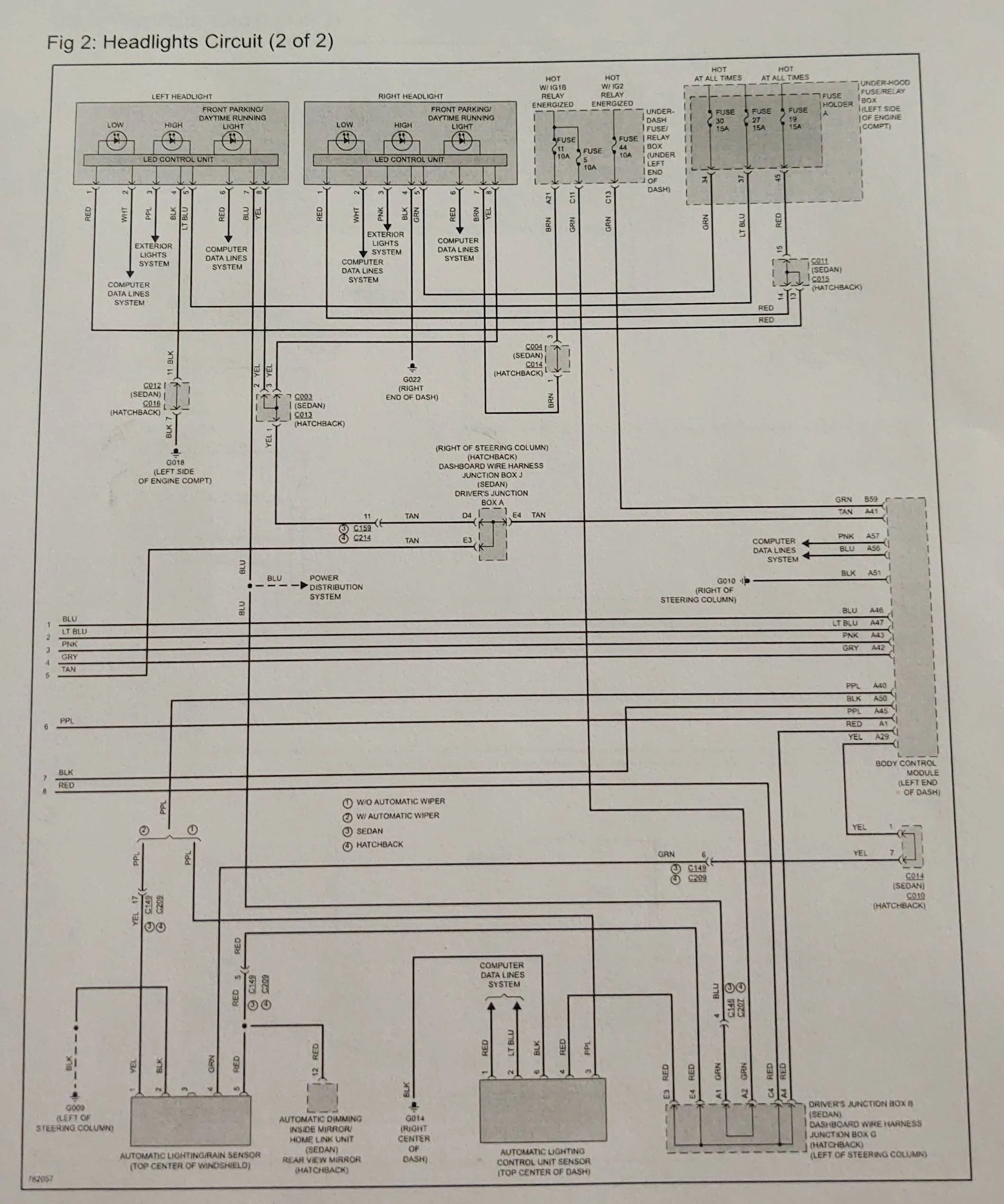

Headlights on the Sport-Touring are full LED. One connector, 8 pins. A lot of control of them is by a 3.3V data/logic signal. For example, when you turn the car off and the headlights are on, then turn off after 30 seconds. NONE of the pins goes from 12V to 0V. Thats just a data signal saying to turn off. Thankfully, I can still use 3 of the pins ( #3, #4, #7 ). Which is Turn Signal (0V / 12V ), Ground, and Ignition ( 12V when car is running, 0V when off ). Sooo..Yep!
