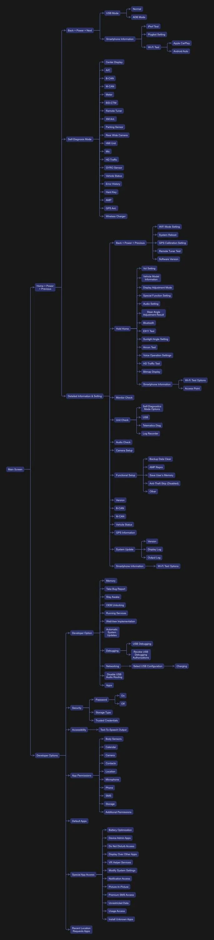

Here is an updated chart. It’s big, but I’m making sure not to exclude anything unless it’s a LONG list of options and they don’t help our cause at all

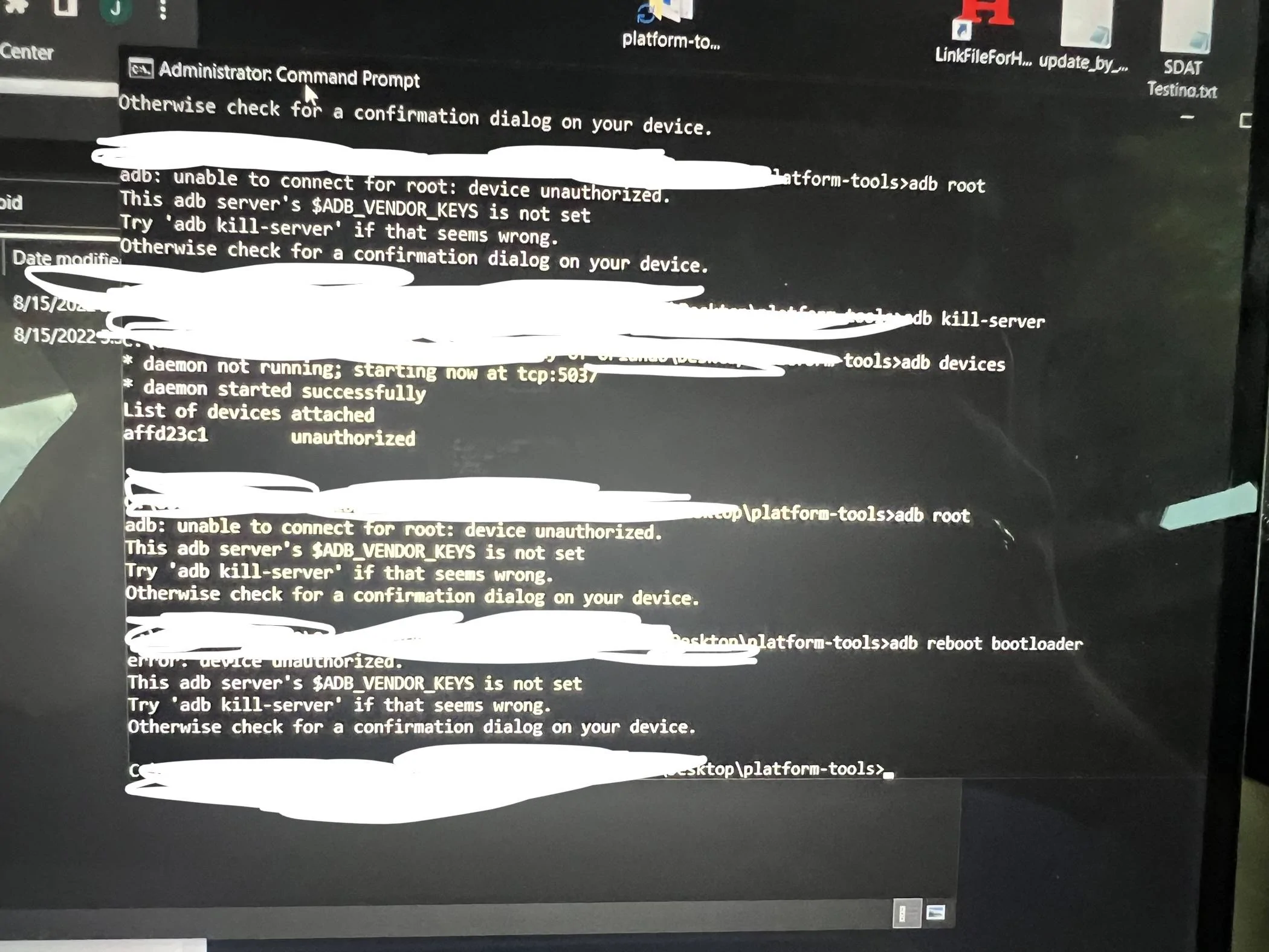

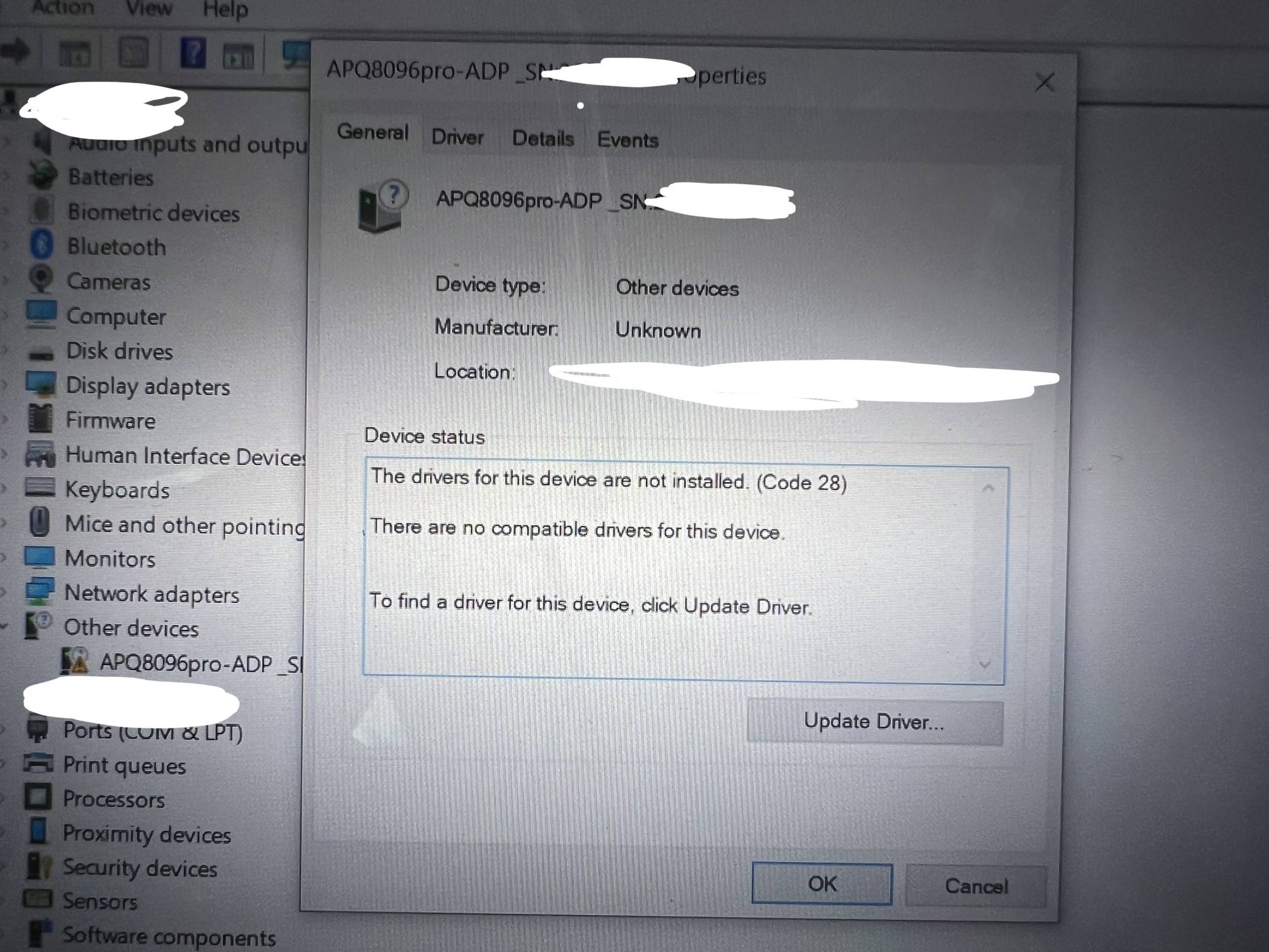

OKOKOKOKOK! I used a powered USB hub, and I’m seeing a device while it’s in ADB mode! TIME TO TRY THE ADB DRIVERS ON FOR SIZE!
Jamieden
James
Aug 5, 2022
39
2022 Honda Civic Touring
okay, so, it is picking up, but we need vendor keys.

this is essentially where things were left on page 2. No progress has been made since, as we are unable to authorize the device on the HU itself like android typically lets you do.
https://www.civicxi.com/forum/threa...ork-in-progress-discoveries.49933/post-823444
To my knowledge, the vendor keys are set on the HU (server) not the client. So either there’s a setting somewhere we need to unlock to enable a true adb connection, or there is a software method to enable it (boot loader scripts perhaps like with the Chinese software update scripts have done, or a special apk authorized by Honda).
