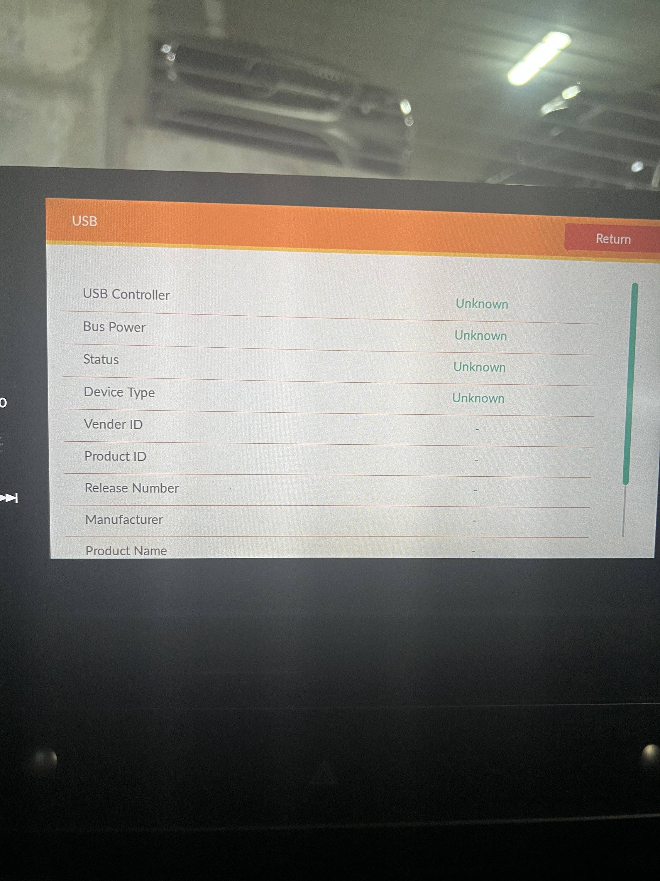

so I started digging, and this screen shows the USB status while in ADB mode. Not sure what to do with this information yet, but I’m assuming it’s in device mode rather than host mode. It needs power from the connected USB device. Gonna try with a USB A to A connector later

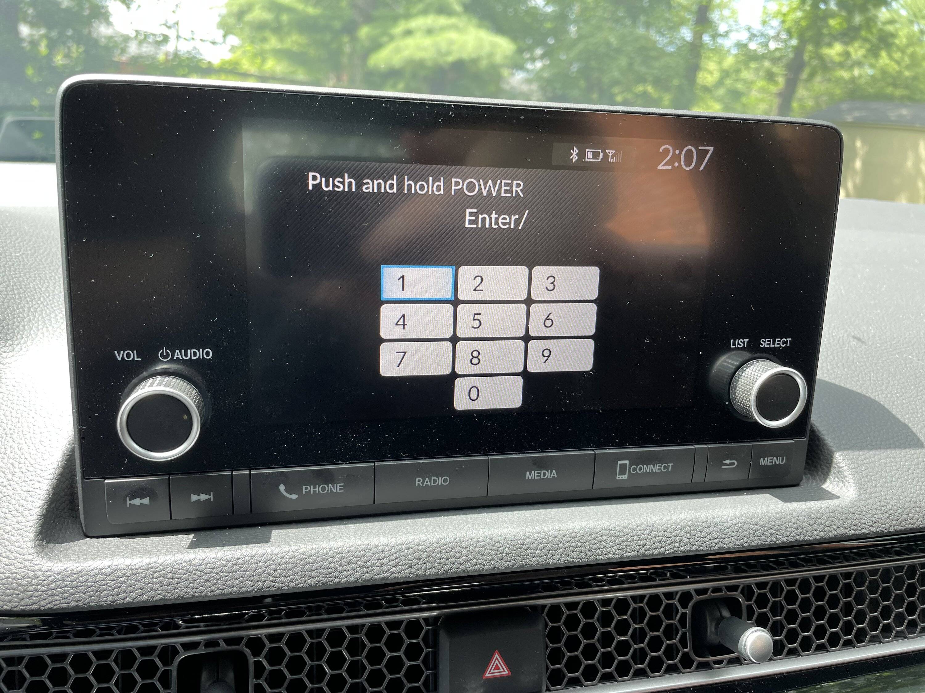

Has anyone seen this screen before. I was putting the combos mentioned in the is thread through their paces and somehow got here. Don’t know how.

Yes, I've had this, too, but I don't recall excactly what I did to get there so can't provide the steps to replicate it. I assume it's an anti-theft measure. If memory serves me correctly, turning the car and head unit off & then starting the car allows it to boot up normally again.

I just got this yesterday when I was removing my downpipe. I left the battery unplugged and about 45 min later when I plugged the battery back in and started the car the head unit was like this. I just held the power button and it went back to normal.

Yes you need USB A to A cable. I can't see the unit in ADB but we're not getting the authorization message on the head unit to get any further

So, I got a USB A to A cable, and the PC doesn’t even notice that somethings there. I saw somewhere that you might be able to bypass this by using a powered USB hub, but I have my doubts. There must be a specific way to access ADB rather than just plugging random stuff in.

Oh there is another screen to get it to a host mode. Look through this thread and you should see it.

So, I did look through the thread, but it seems like it was for a different model. The button combos don’t match with the buttons that I have in my 22 Civic Touring

Do you have the 7" or 9" display?

I get this every time after unplugging my battery to mess with my music.

I think the issue is that we need to change the USB mode from host to device mode. Dunno how to do that on the 2022 model

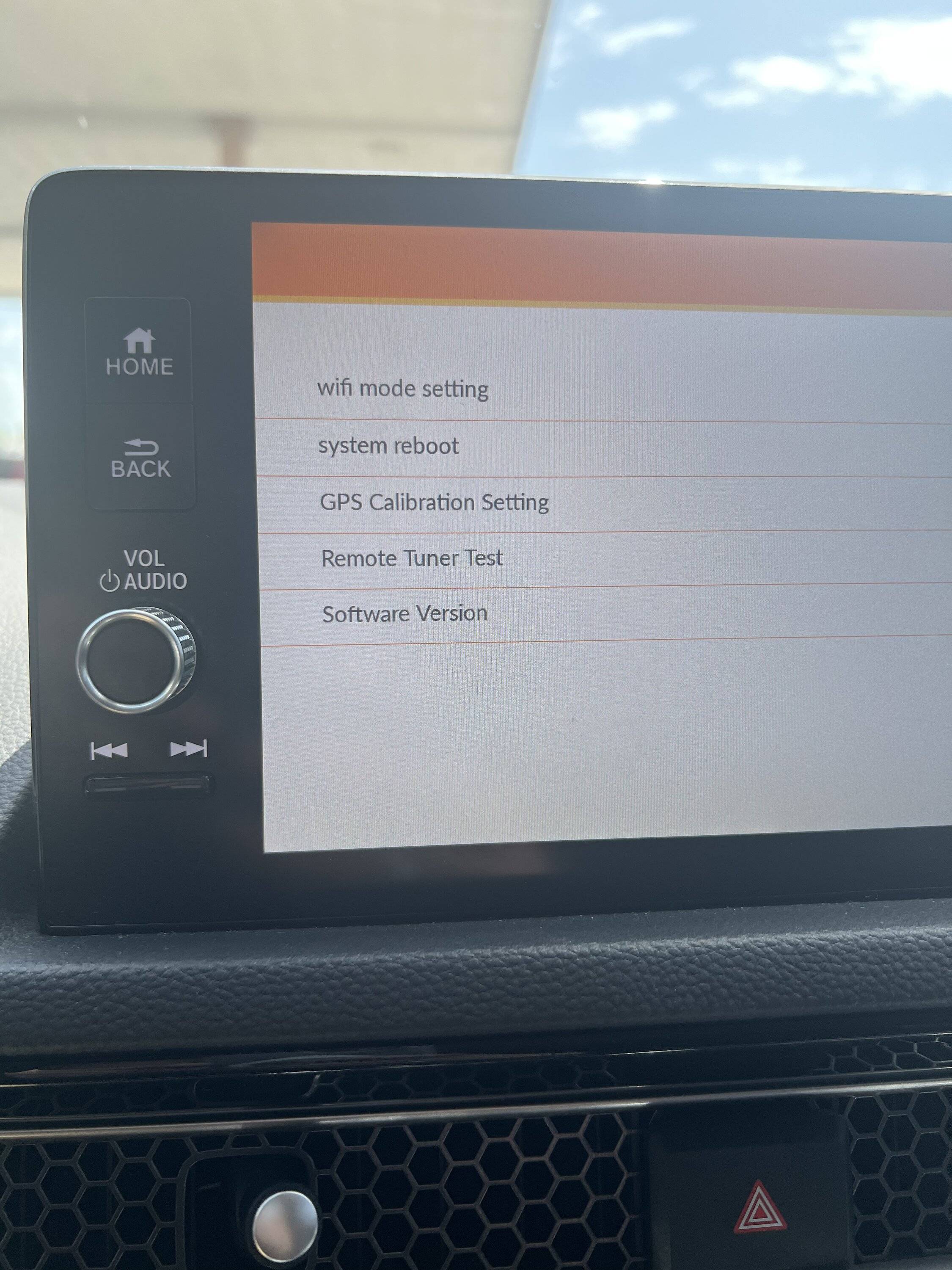

Woah! By sheer accident, I found this menu. From the self diagnostics menu, I held “Back + Power + Previous”
