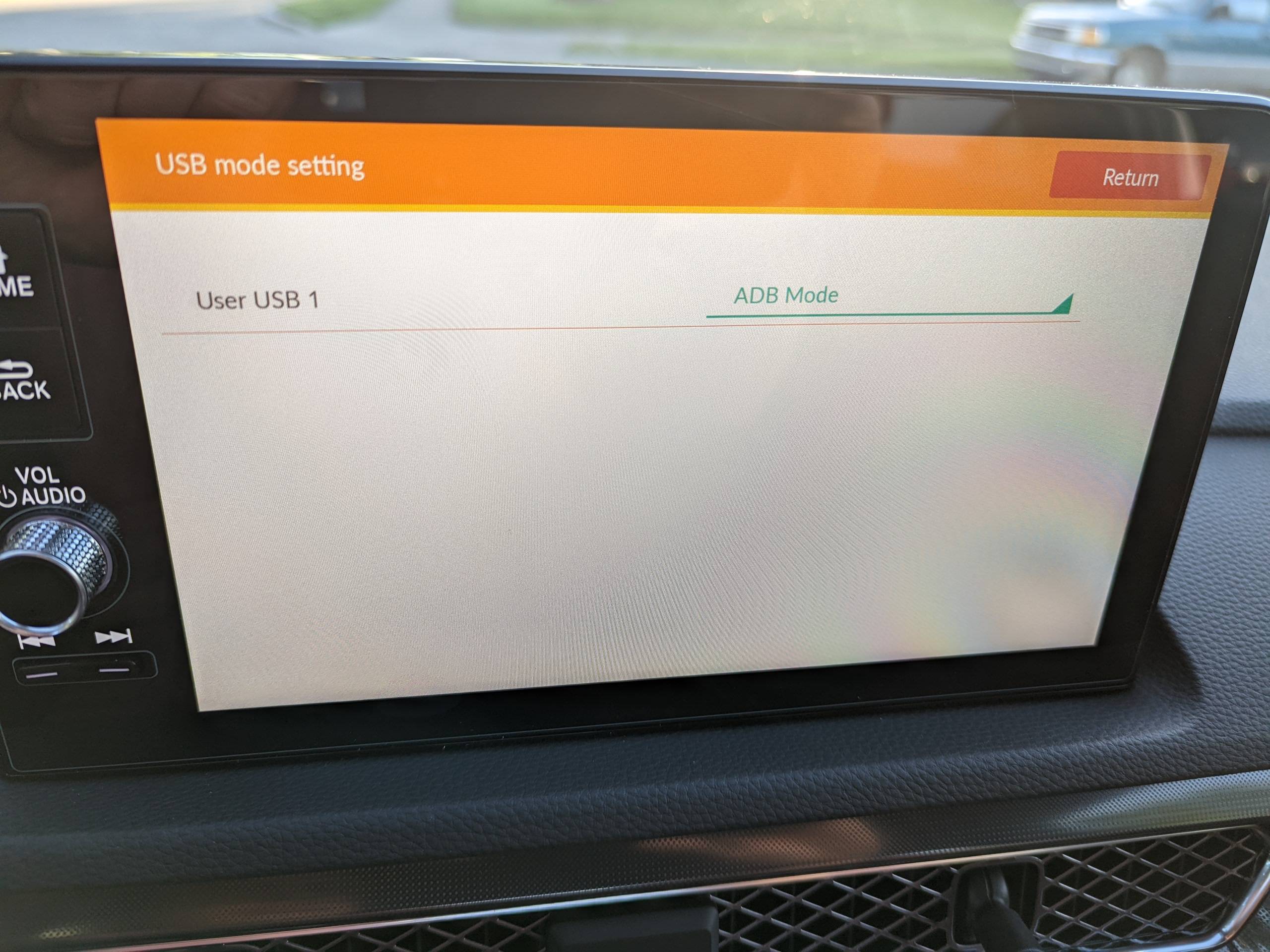

I also noticed that the ADB mode usb mode seemed to just turn off power completely to the port and nothing worked.
Is it possible enabling ADB mode is killing all USB ports except the one meant to be used for ADB? Perhaps try all the ports (including USBC).
I tried all ports no luck. I did enter the service screens but we are missing " Cancel Android Restrictions" option. I did enable developer options and ticked the OEM unlock and enabled adb.
I did change the USB host function to adb. I ordered a USBA to USBA cable so I can test on Monday

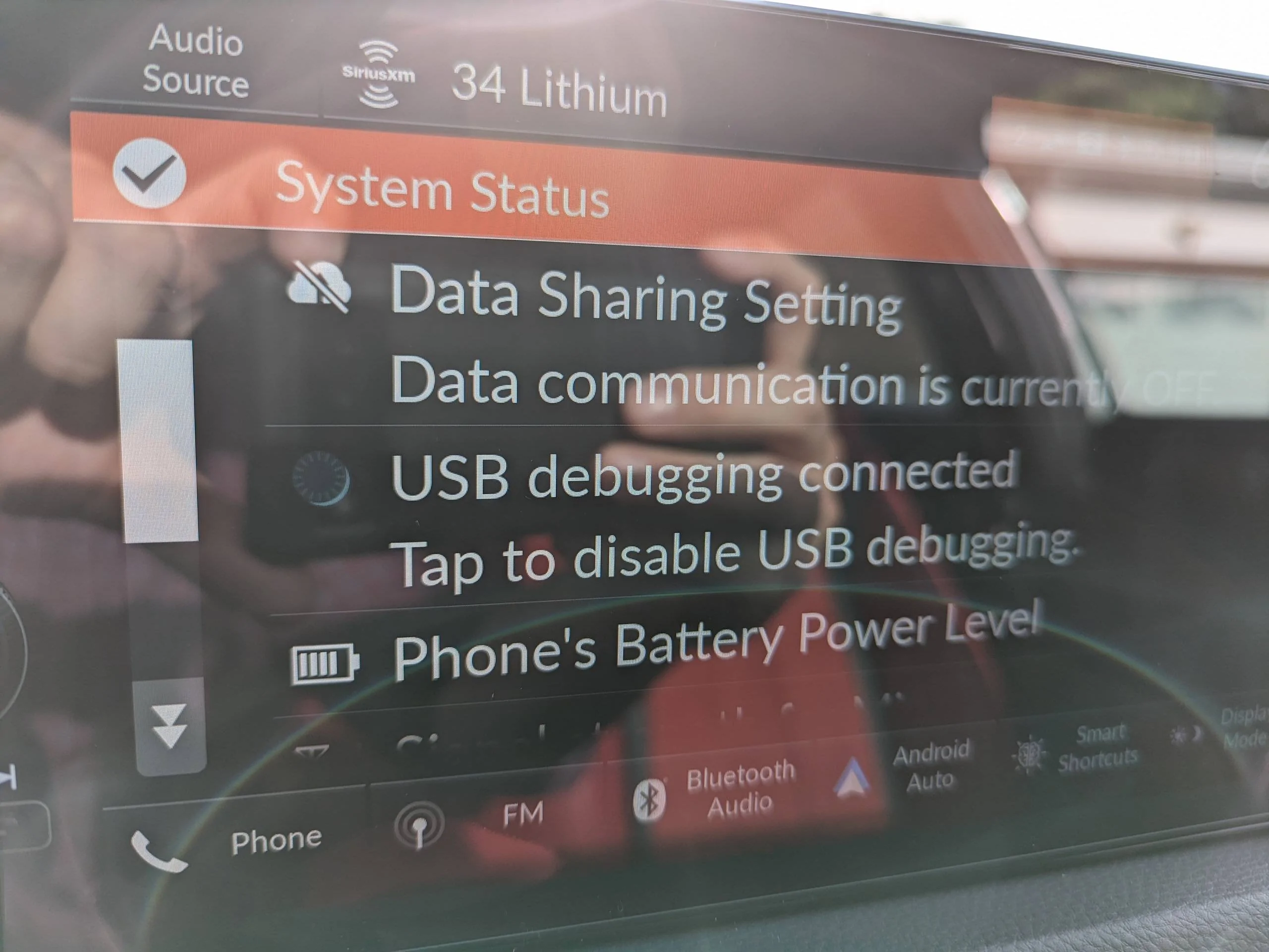

Alright the cable came in and it detects the device. Unfortunately I'm seeing an unauthorized from the adb server. Normally there is a pop-up on the Android device where you can authorize the PC that's connecting. Well I don't see this dialog. Interesting how it shows adb in the notification screen
I believe that you need to go into Developer options and switch USB function from charging to Data/file transfer.
I tried MTP and PTP mode but no prompt.
