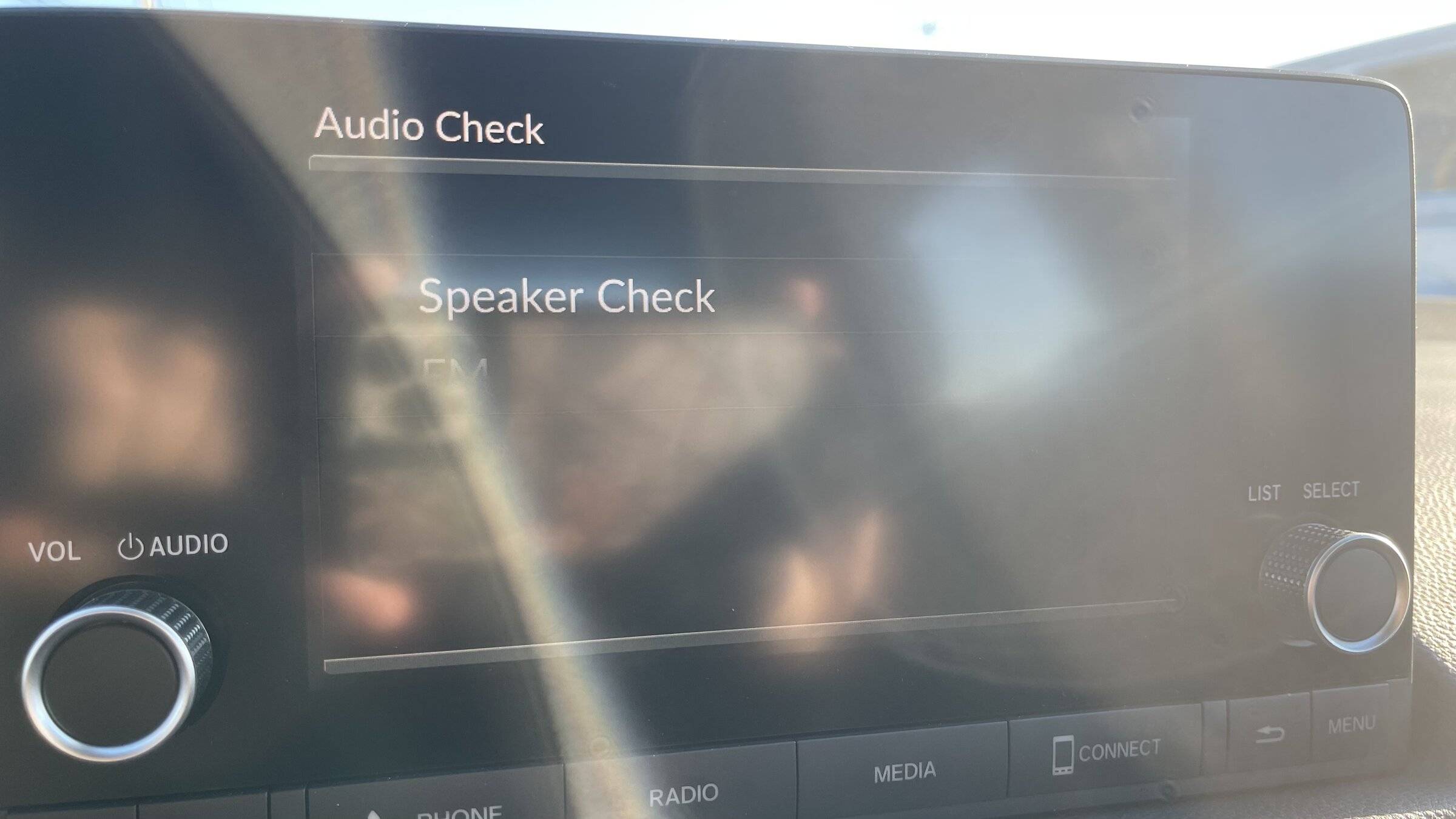

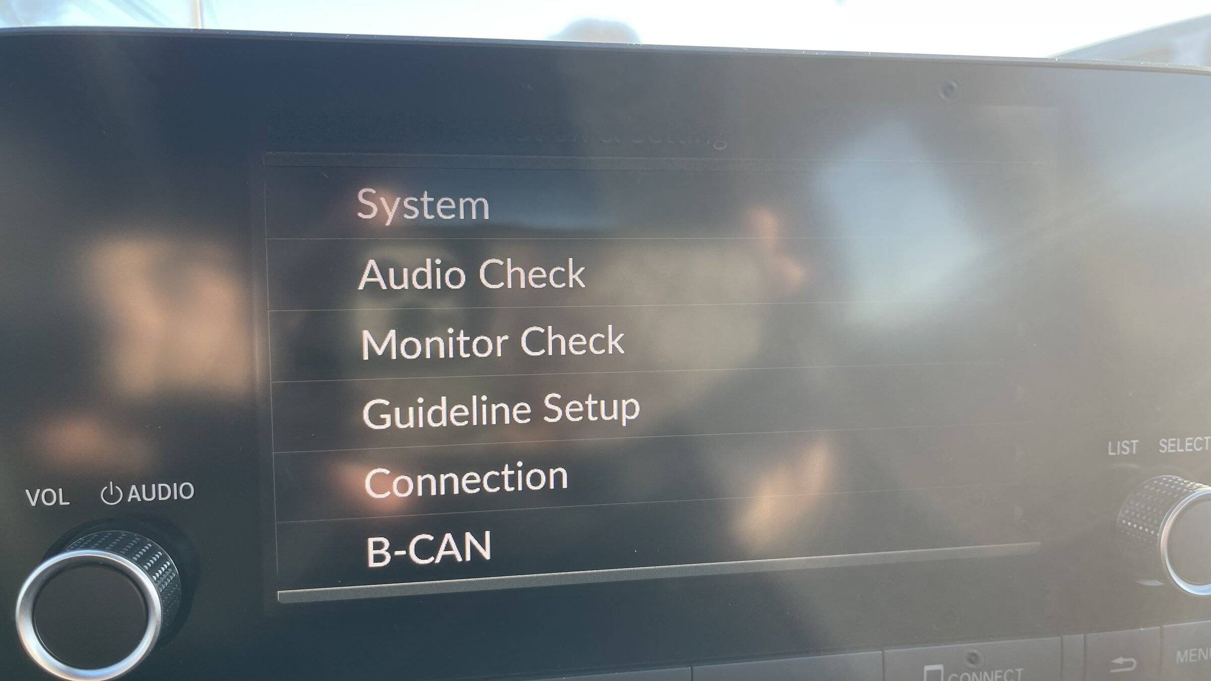

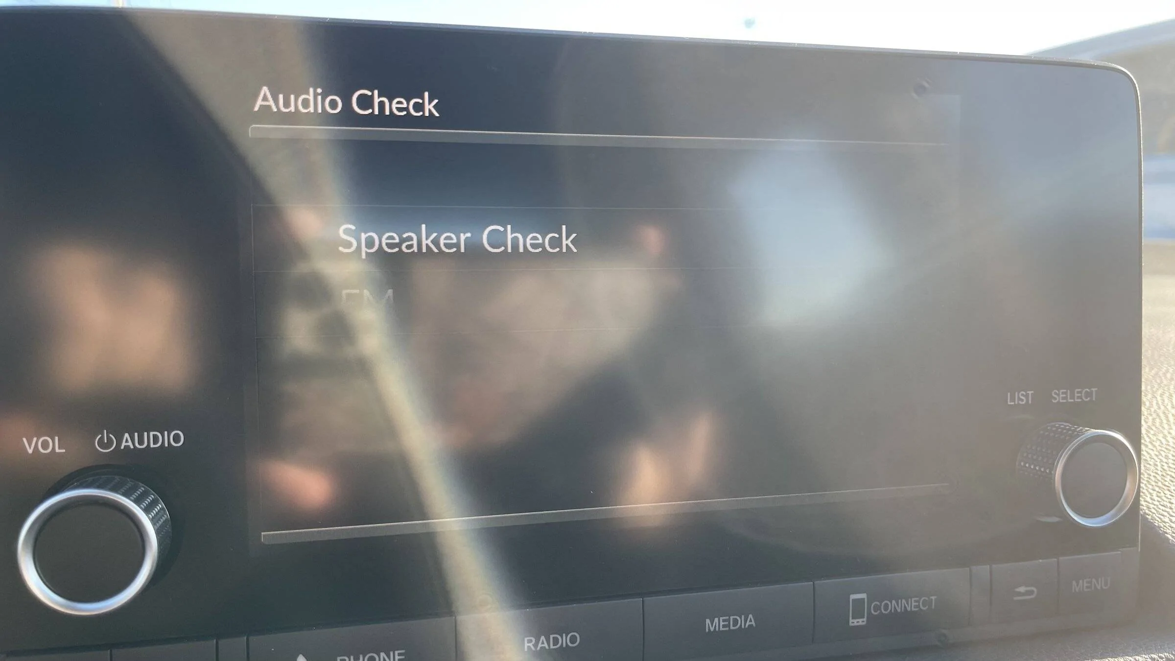

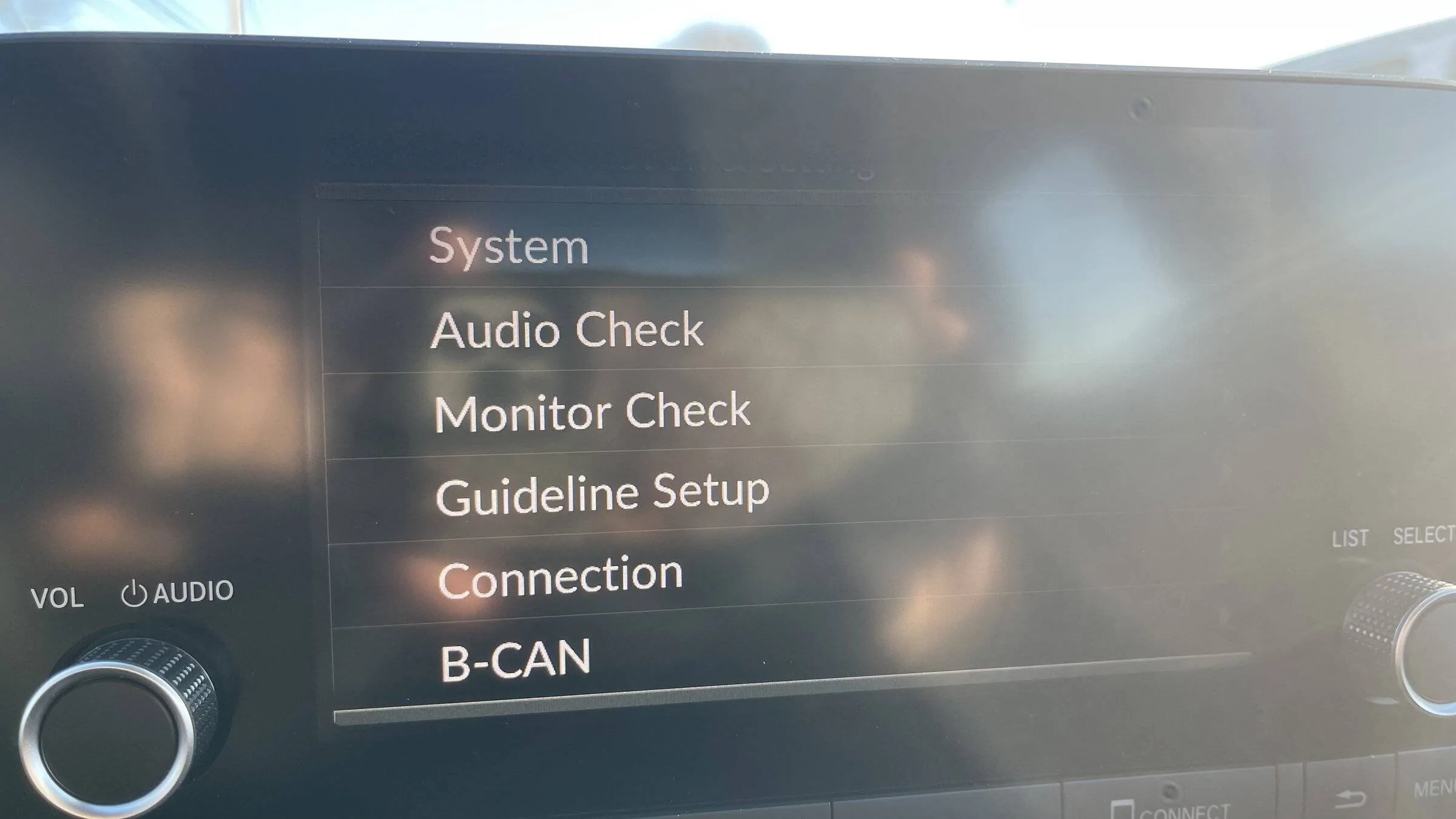

@Just1Jack
I checked and did not see an option to turn off the EQ like you mentioned.
I hit “audio check” and the next page only shows me 3 options:
“speaker check”
”FM”
”AM”
Here is what I saw: (sorry for the glare)

@Just1Jack
“speaker check”
”FM”
”AM”
That is strange. Let me double check on the steps. Ill let you know in a few days. I cant leave the house cause I am sick with covid.
