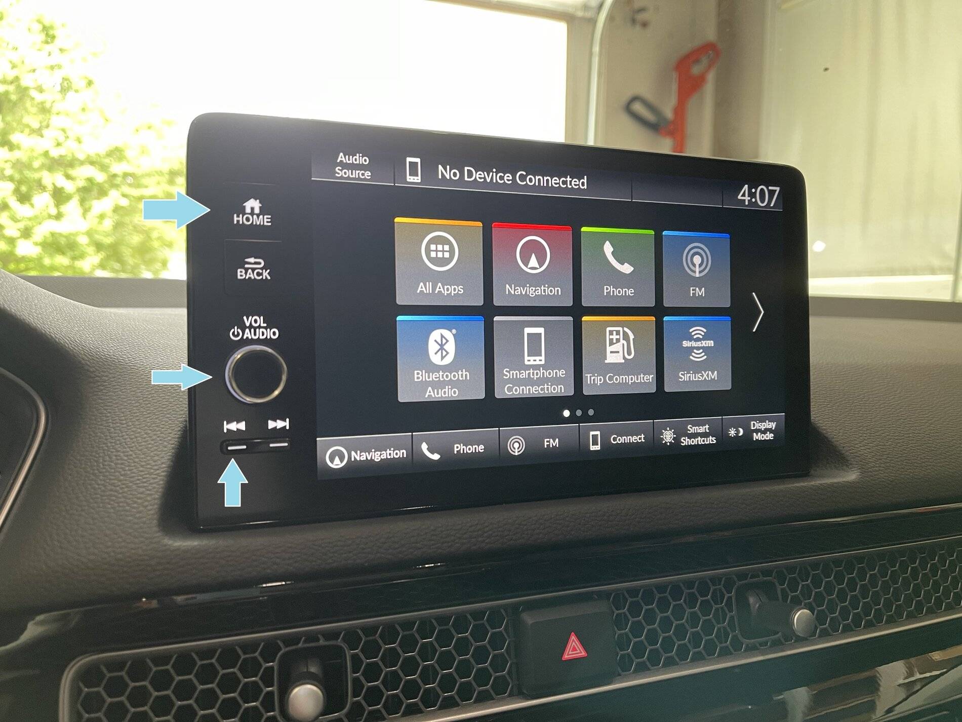

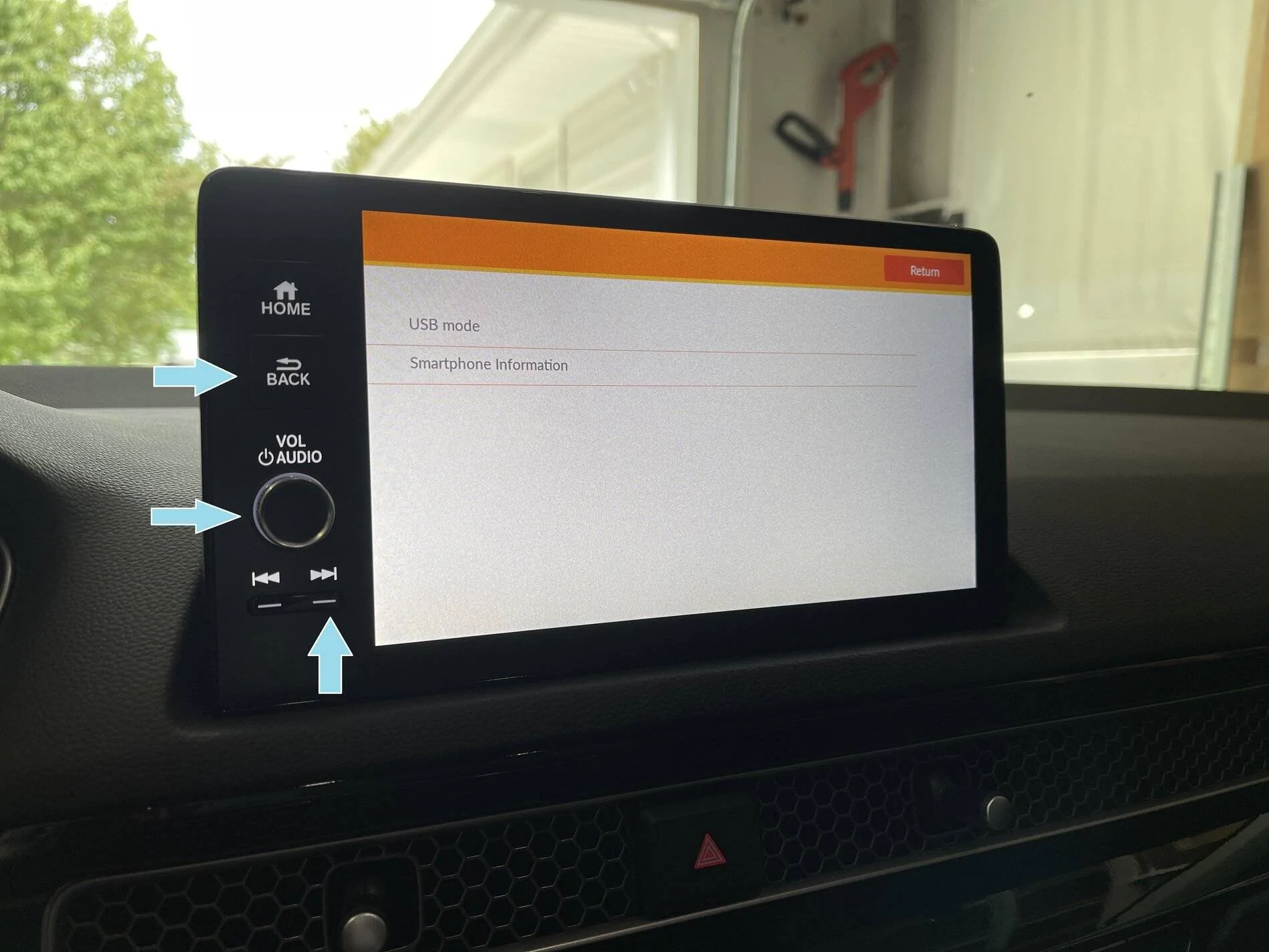

Here are some screenshots and methods to access the two hidden screens I have found:
First Hidden Screen (Diagnosis Menu):
Similar to what was used on the 10th Gens: hold HOME + POWER + BACK:

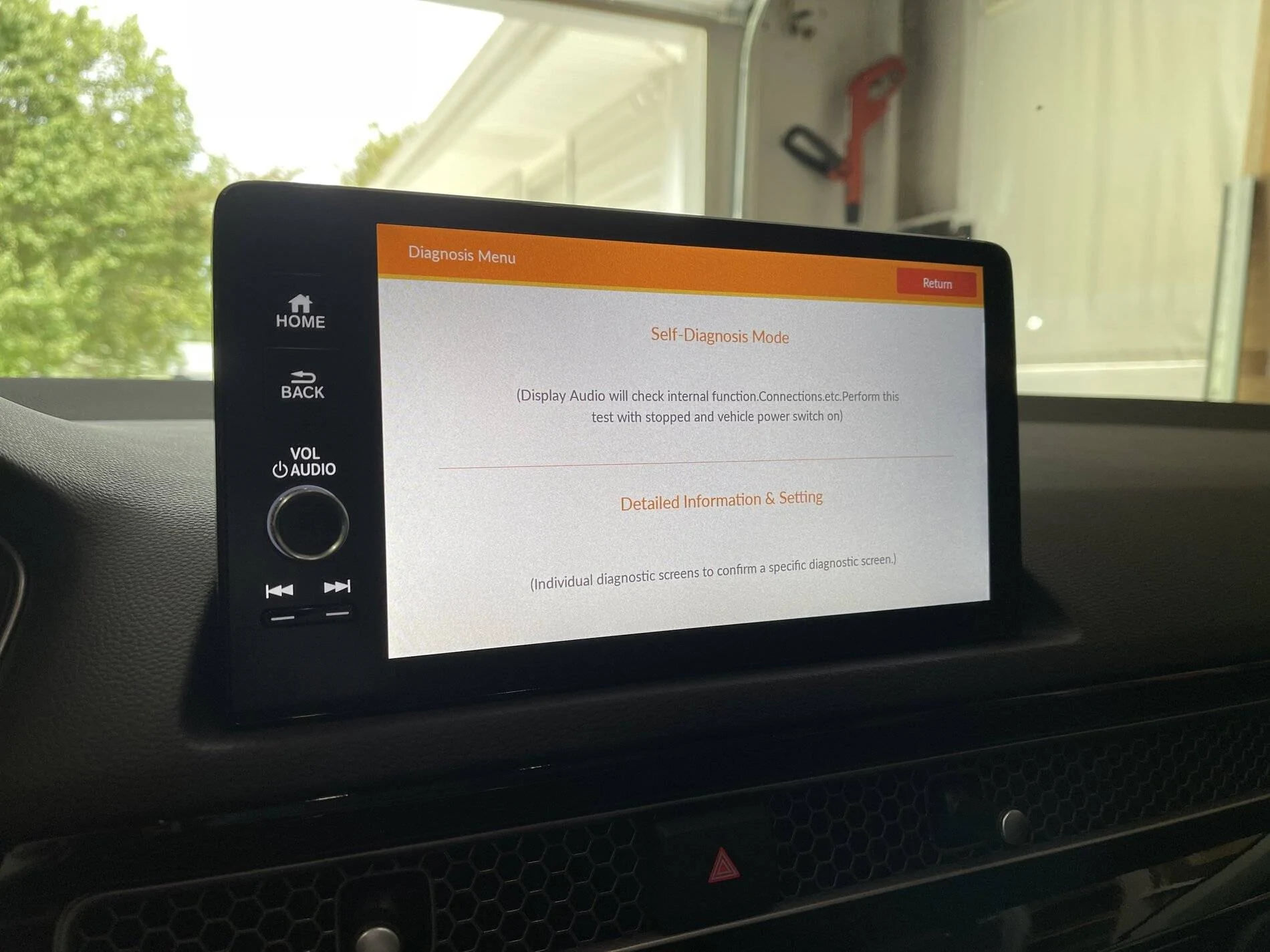

That brings you to a screen that looks like this:

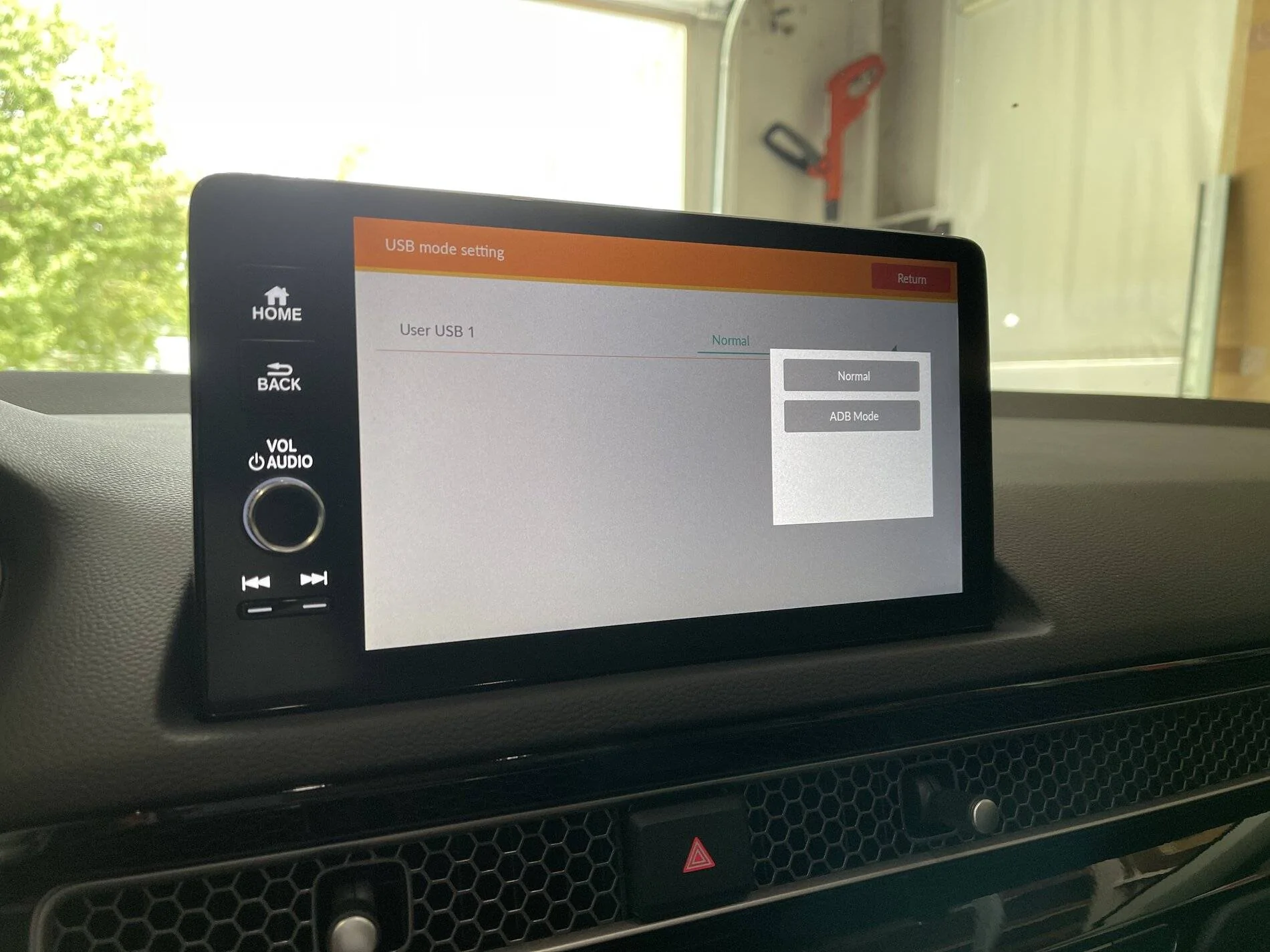

From this screen (or from the Detailed Information & Setting screen), Hold BACK + POWER + FORWARD for about 5 seconds for a new hidden menu:
The thing to note here, I think, is the USB mode. It allows you to turn on ADB Mode through the USB port:
It leads me to believe this may be the route that is needed to take in order to take admin-level control over the device.

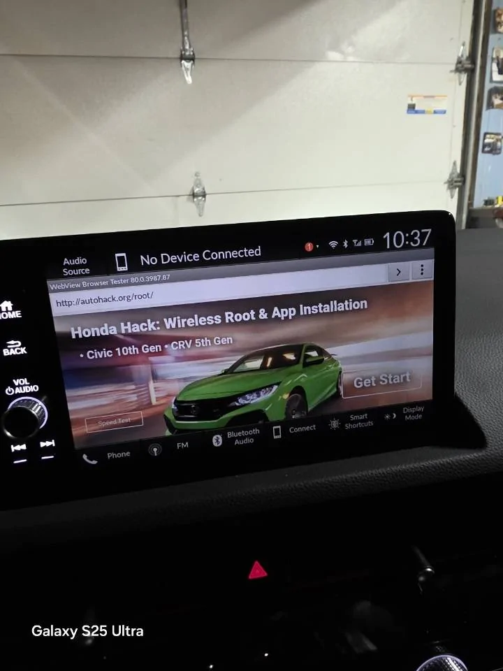

Some progress 2 nights ago.
We just need a working payload for android 8.1 and loaded through the web browser.

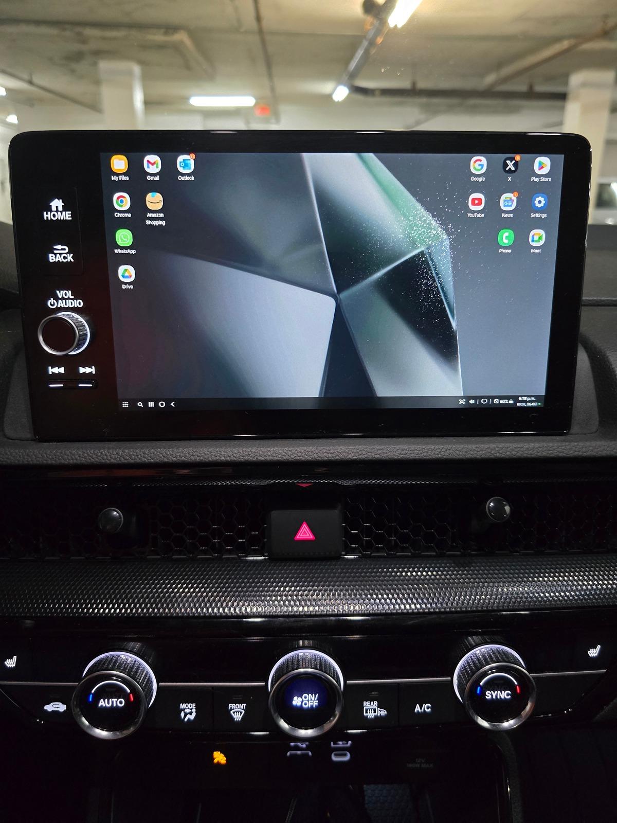

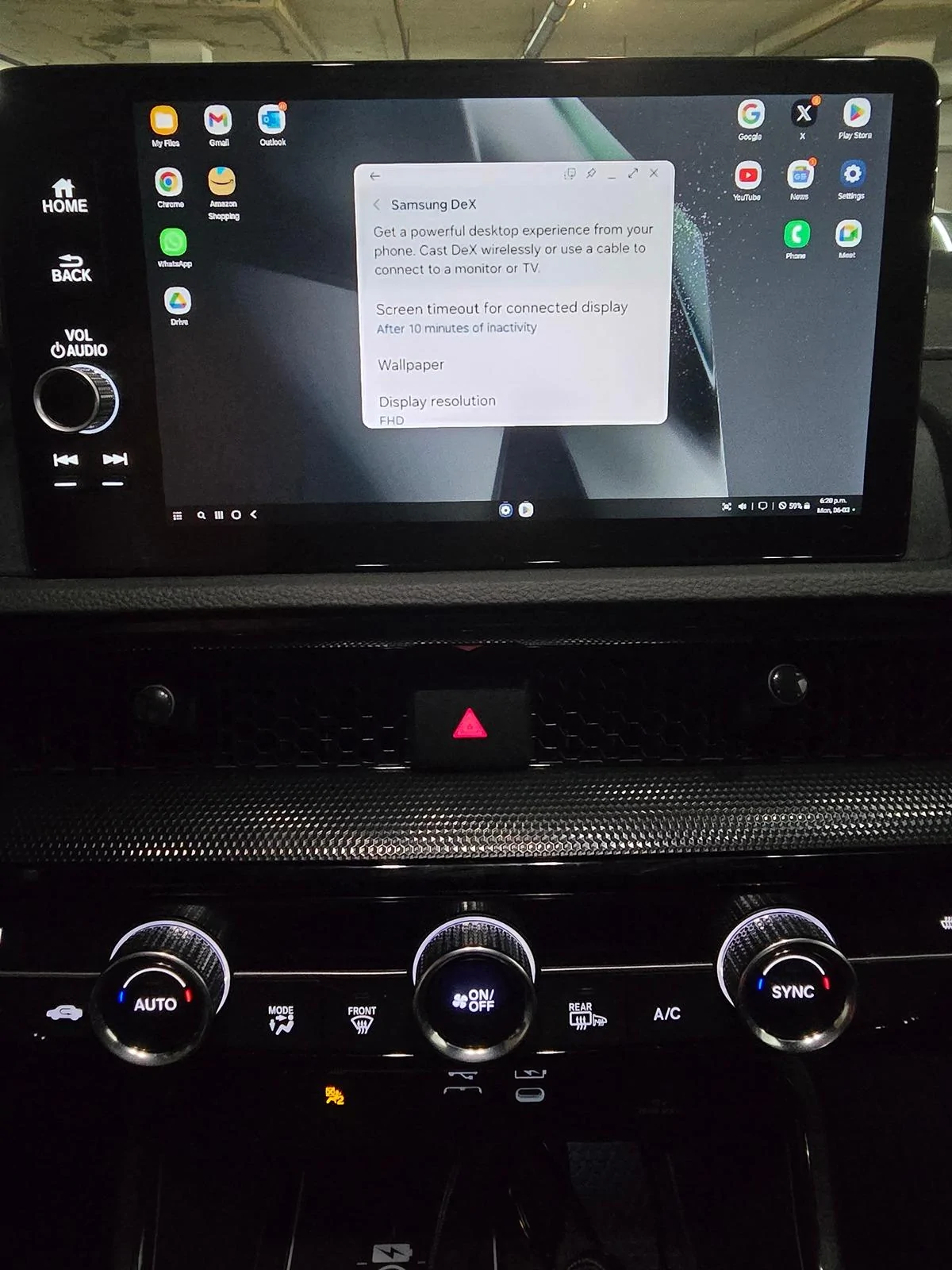

So this happened yesterday..
But still can't get the touch screen to work. I used the phone's screen mouse control to get around. If you're wondering, yes a physical keyboard/mouse works with this setup but it's not practical
The question is... How? Are you using a dock of some sort?
That's huge. How did you sodeload the browser?
You will need the following first,
A samsung phone
USB A to USB A cable
USB A to Type C adapter.
First, make sure you have the developer mode enabled. Change the USB mode on the dash to adb mode on the USB.
Second, Go to developer mode and toggle usb debugger then change the USB to media mode, then connect your phone and it will ask you to open the Smart Switch app, open it and click ok on the radio, that will open the web app for you.
Note, download the Smart Switch app if you don't have it.
Also, enable wifi on the radio and connect to a Hotspot.
I can make a video if you want.
