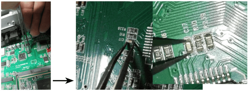

Alternatively, back to the hardware investigation kinda, some devices have a small reset button on the board or even need pins shorted out to trigger recovery mode. Below is an example I found on how to get a generic Android head unit into recovery mode.
11th Gen Honda Civic Honda Hack / Root: 11th Gen - Work In Progress Discoveries 1000004479
Use the tweezers put on place C17 IC (two pin) like in picture attached, make it short circuit until the android unit restart (about 5-7 seconds) and take off the tweezers. It should restart into recovery
Again, these are just ideas. I'm really interested in helping and have a lot of nerdy experience but not willing to take apart my brand new 24 Civic or buy one of these infotainment boxes used for 300-500 to tear down and find out.
