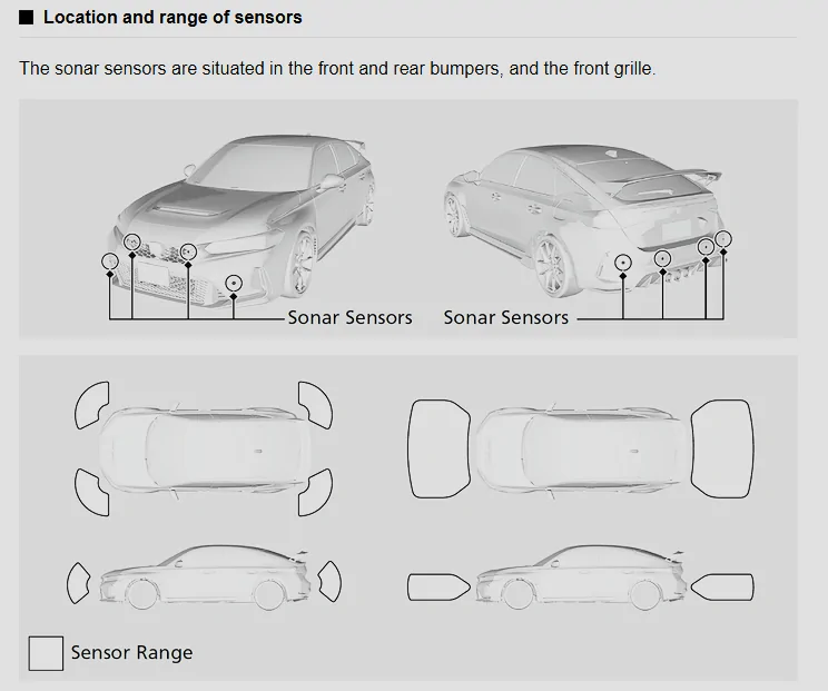

Where is the front radar sensor for Honda Sensing located in the FL5? Everywhere I read, it says that Honda Sensing is consist of a front camera mounted on the top windshield, which I see AND a front radar sensor located behind the lower front bumper grille, which I don't apparently see? Does the FL5 even uses a front radar sensor for Honda Sensing?
The reason I'm asking is that sometime, I get a "bong" and the honda sensing symbol goes red for a few seconds and then turns green again. Sometime, this happens a few times. I had verified that the top windshield camera is clean. However, I was wondering if the car does have a front radar sensor, then may be that area needs to be clean to prevent this intermittent system shutting off? Anyone have this happened and solved it? Thanks.

2022+ Civics do not have a radar sensor. It is only the camera in the windshield.
I think these are just for parking though, not for any of the adaptive cruise options. Still technically part of the Honda Sensing package. My guess is when my bumper gets covered in snow these are covered up and technically part of the sensing package doesn't work which is why I get the error message.

Canadian Type R's do have the sensors. They are parking sensors and have a separate error.
