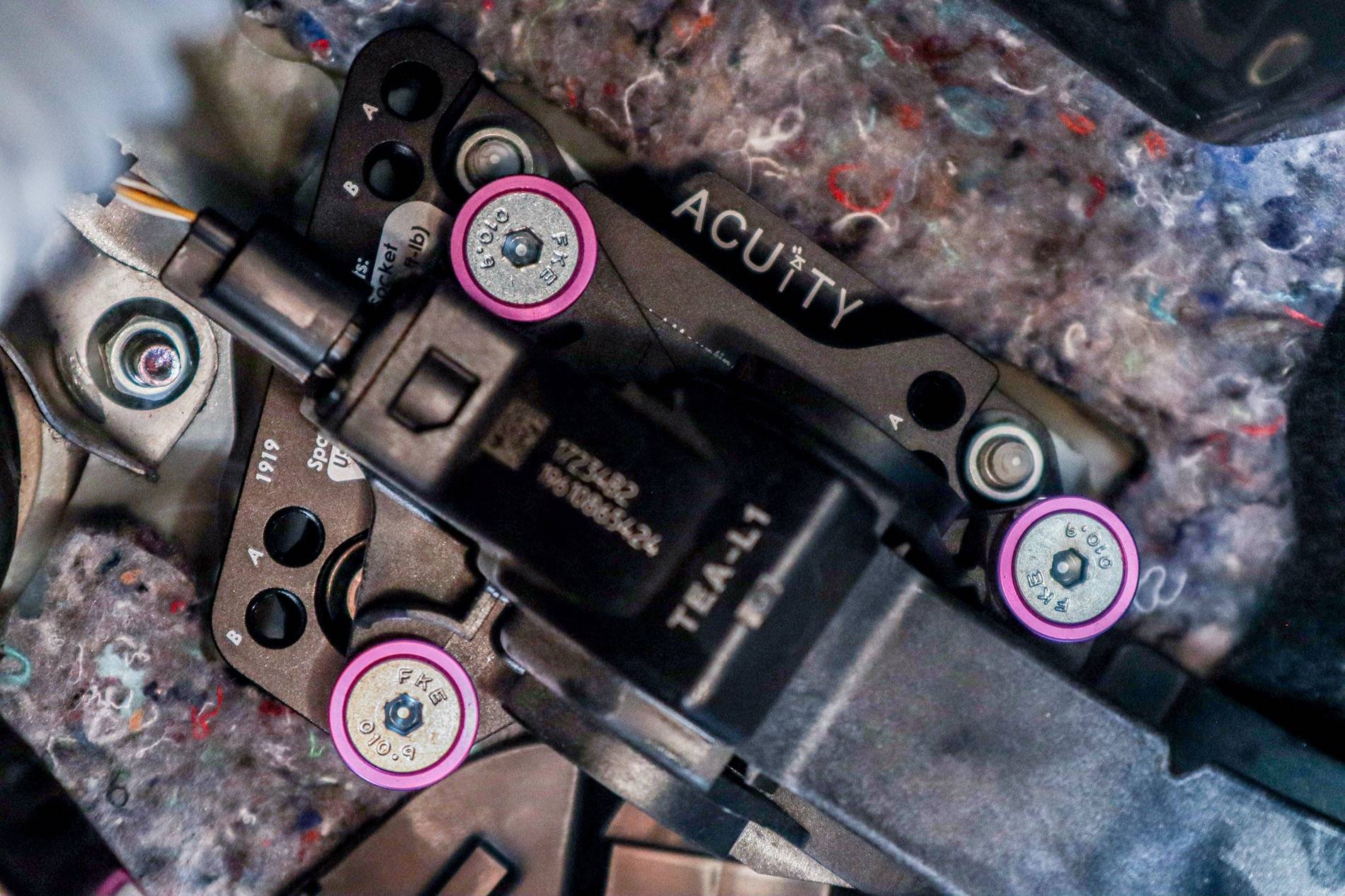

If the pedals are too far apart for your foot to bridge the gap between brake and throttle, there's generally a cottage-industry solution to spacing the throttle pedal over closer to the brake pedal, or putting a wider pedal cover on it that accomplishes the same thing.
Here's a spacer for our cars from Acuity: https://acuityinstruments.com/products/acuity-pedal-spacer-for-the-lhd-10th-gen-civic
I would note that a lot of these also raise the gas pedal, which can be counter-productive if you're rocking your foot instead of using your heel.
