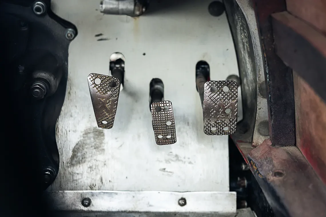

Something to note is that the term "heel-toe" didn't originate with the style of pedal work you see in Initial D:
It came from pre-war cars that actually had a center throttle pedal. 1934 Aston Martin pictured below:
11th Gen Honda Civic How to Heel-Toe with big feet 1755698201222-is
You'd put your right foot (toes and ball) on the on the brake pedal which is furthest right (note: floor hinged so they actually go up a bit when you press them) and rotate your heel left instead of right in order to blip the throttle pedal in the middle while you work the clutch pedal (furthest left) with your left foot. A direction of ankle rotation that most guys will find easier to work with!
That's the actual origin of the term.
What we think of as a "standard" pedal layout didn't start to become a de-facto standard until the 1940's.
As such there is no "one true way" to heel and toe a downshift. You do what works for your physiology and for the car's particular pedals. All it really means is you're using all three pedals simultaneously with two feet. Witness Ricky Rudd being a maniac in the 90s:
That car's pedal box is set up to accommodate this style of driving. Most aren't.
