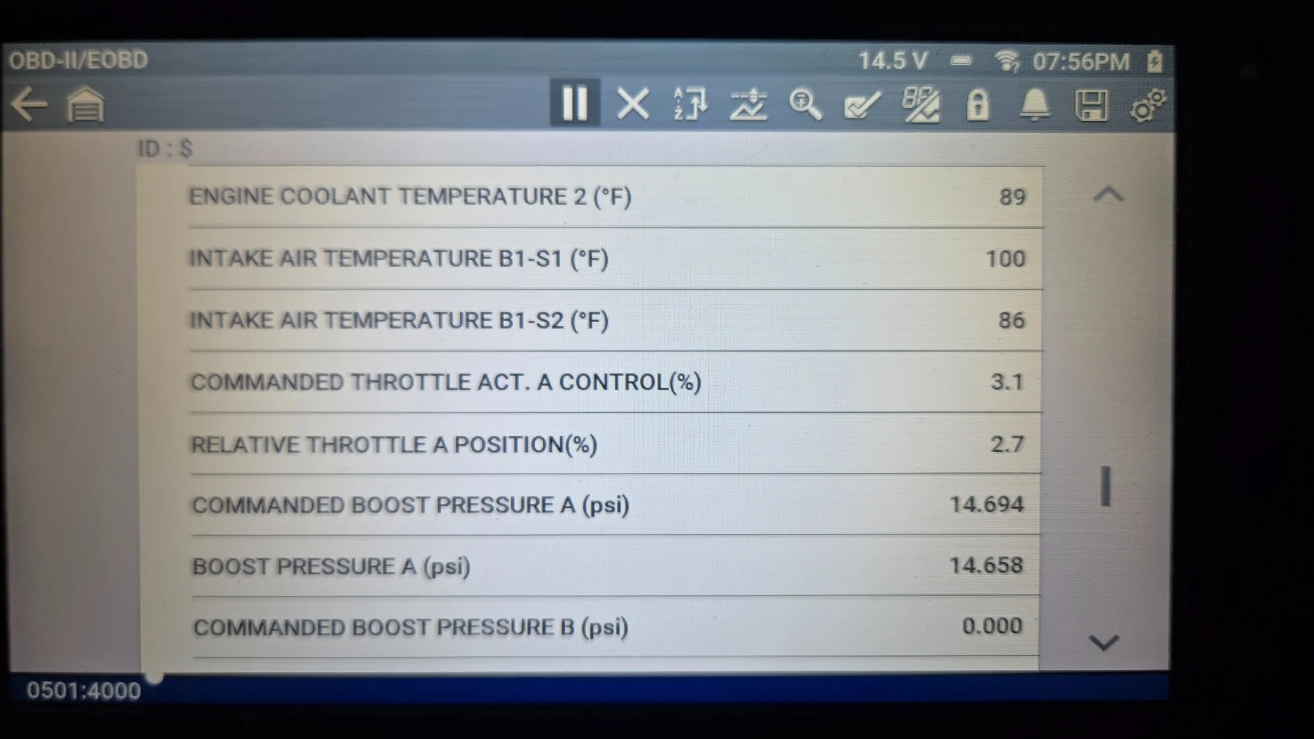

Confirmed with my Snap On scanner that IAT2 temperature data is available from the data stream in the 2025 Civic Si.
This is a Ktuner issue, and they told me today they do not plan to take the time to fix this. Sad.
11th Gen Honda Civic IAT2 Sensor on KTuner 2.0 Reading at -40F 20260203_183356
