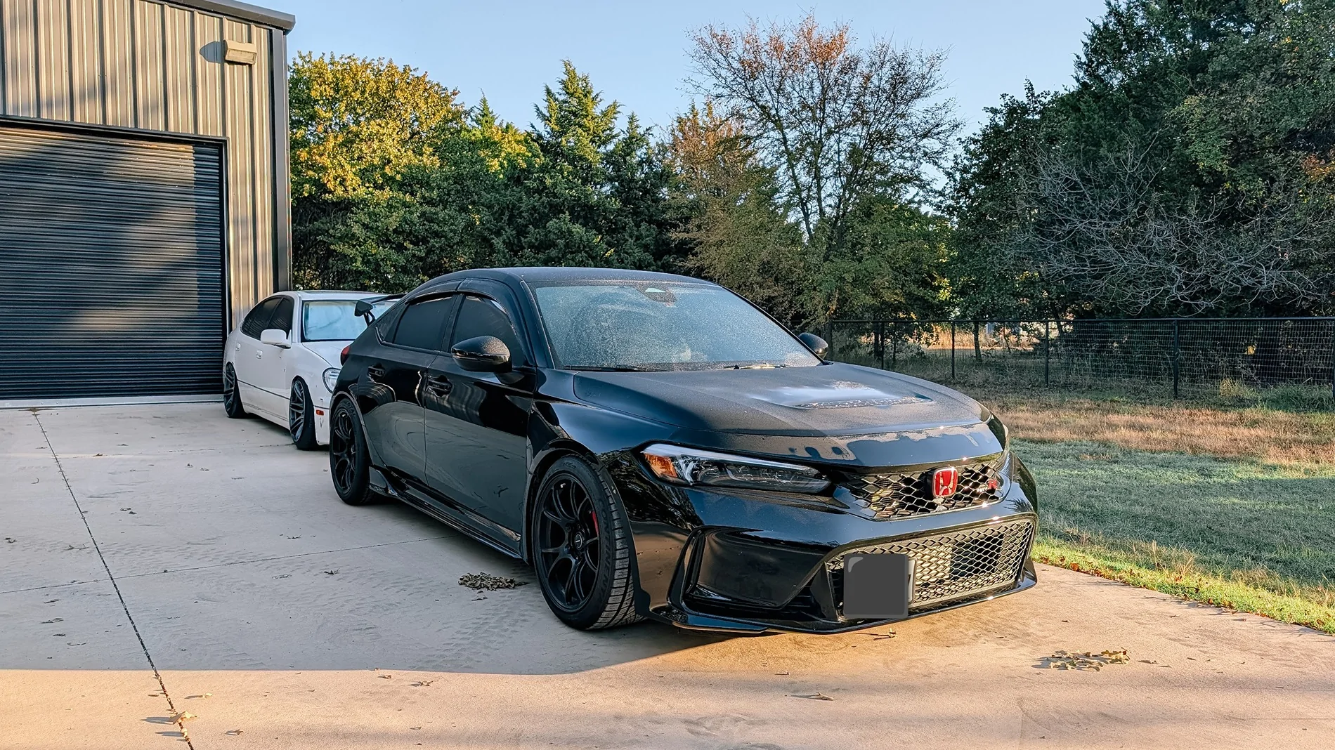

This is a car we added EVS ball joints, Eibach pro-kit for suspension mods. Customer has Superspeed 18x10.5 +47 with 275/35/18 Continental DWS
-2.7⁰ front camber, -2.1⁰ rear

10.5 +47 is the same outer position as 10 +40. You dont have enough camber with the stock struts pushed in. You need LBJ or camber plates.
Also if you track it, -1.8⁰ (ish) of camber from stock struts is going to destroy your outer half of your tire. You need more camber for the track, regardless what wheel size you go with.
