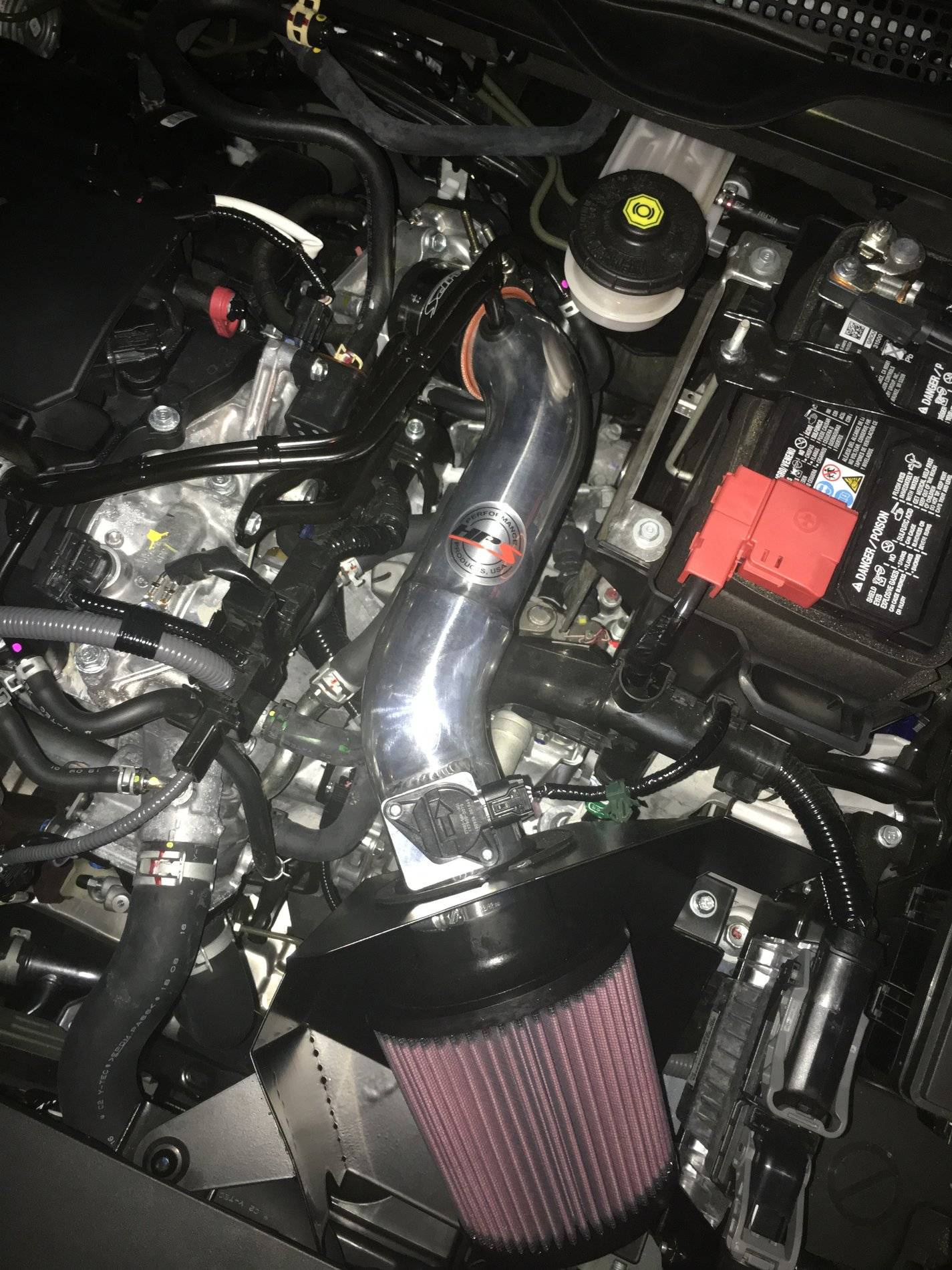

Right now I’m running a HPS SRI. I shouldn’t need a tune for this one? I got people I work with giving me shit saying “you need a tune”, “it’s gunna run lean/rich”.
I don't have any experience with that brand, but from their website product description:
" The kit does NOT require tuning and does not trigger CEL light."
Seems like you're okay. Nice thing is you'll be able to use KTuner to monitor your fuel trims and verify whether that intake is performing well.
